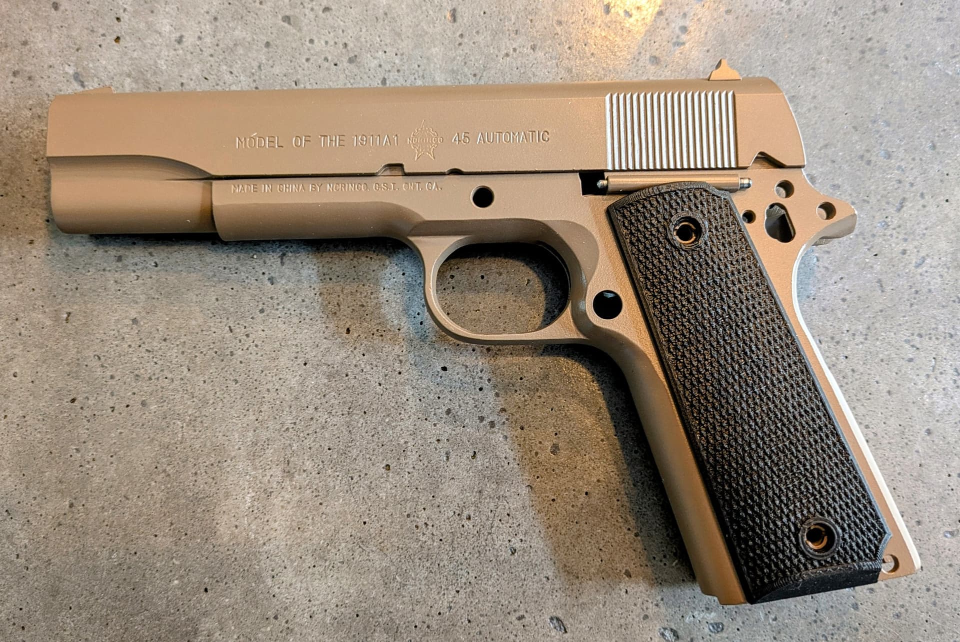

I use the f series. I started with one of their starter kits. Gives you everything you need to get going.
This went pretty good for the first time using Cerakote.
The prep was more than I would have done for powder, but most of it probably isn’t needed for signs. I had to make sure there was no oil left on the parts, so it got cleaned with acetone and then blasted. Then it got sprayed with brake cleaner and gassed out in the oven twice.
I didn’t have the right measuring equipment for mixing, since the ratio for this was 18:1 and you only need a small amount. You really need a small syringe to measure the catalyst.
It was easy to spray on with the cheap harbor freight detail sprayer. This version gets baked at 300f for one hour
part temp just like powder?
What did you think of it so far?
I would assume that is part temp. I just left it in for a little over an hour.
It’s nice stuff, but the colors are limited. I wouldn’t use it on except for things that need more durability and a thinner film thickness than powder.
It takes longer and costs more than powder.
I might have to give it a try, thanks for posting your results
