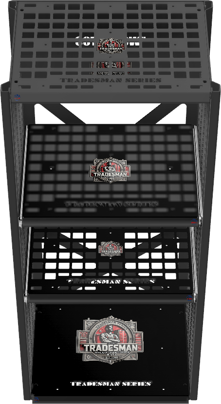

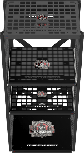

I have an entire product line of drawers, shelves, and mount plates with MOLLE PALS compatible options.
