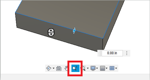

Anybody else having zoom issues with F360?
When I am designing a model, when I create a feature in scetch (line, rectangle, circle…), or modify the solid (chamfer, fillet, hole) the mouse zoom function no longer works with the scroll wheel until I complete that task.
Frustrating when you have to click and drag .25 inches at a time to move up the 3 inches to the next point.

I have always had some issues with zooming but sometimes if you can keep the mouse right over the spot that you initially started to zoom, it works. Otherwise, it seems to stop. Of course, when you are moving the mouse on one of those arrows (increase/decrease magnitude) you have to move the pointer.
At other times, I can sometimes hold down the scroll wheel and spin it at the same time and I will get the zoom action. I really have not found the complete solution or formula. But, yes…I have the same issue.
Late breaking news…just solved it for me. When it stops zooming, click here and you get the ability back again. I think. Haven’t tested it out completely.
Fusion 360 will Zoom to the point of reference. So, in your case, having the pointer on a corner of an object the zoom will be in and out to that reference point. If the pointer is pointing out to infinity, there is nothing to zoom, hence no change.

But I found another option. Some won’t like it. Change the way Fusion behaves with the mouse movement. Change it to the way “Solidworks” behaves.
3D movement: Middle mouse button (Fusion: [Shift][middle mouse button])
Zoom: scroll wheel or [Shift][middle mouse button][move mouse forward/backward] And of note: this second option works even when the scroll wheel does not seem to work. (Fusion: scroll wheel)
Move image: [CTRL][middle mouse button][move mouse] (Fusion: [middle mouse button])
Sticks! I just figured out a fix for our problem when Fusion 360 refuses to zoom during sketch elements and modifications and extrusions.
Pick any circumstance when the zoom function seems to be absent:
Now left click anywhere other than the sketch. It can be something as benign as the border of Fusion. You just need to avert the attention off of the sketch. Now zoom works as usual until you click on the sketch…then you lose that function again.
