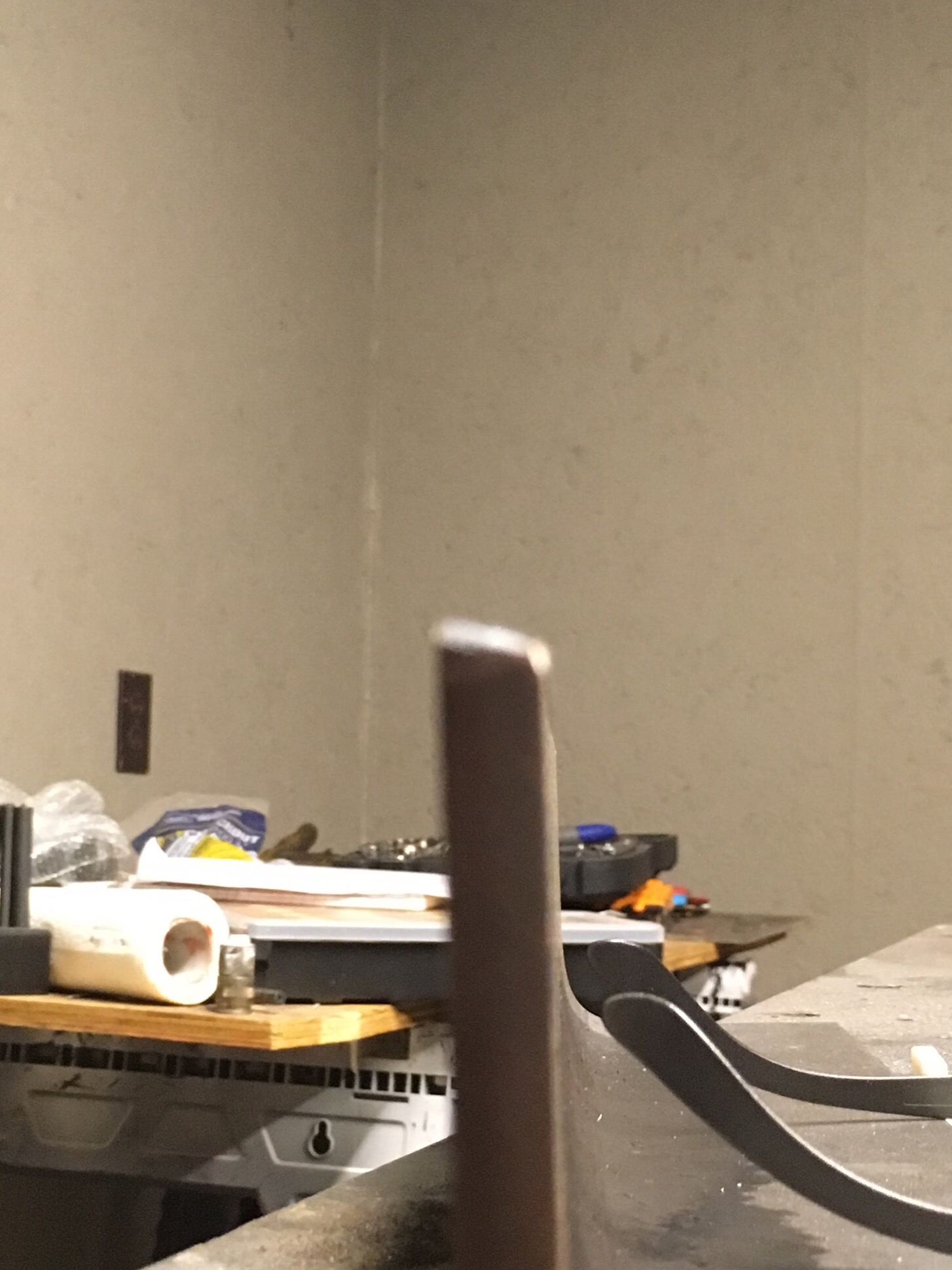

What could be causing this? Kerf is going the same direction on both side of a square, a little blurry but you should be able to get an idea of the odd kerf angle as well…

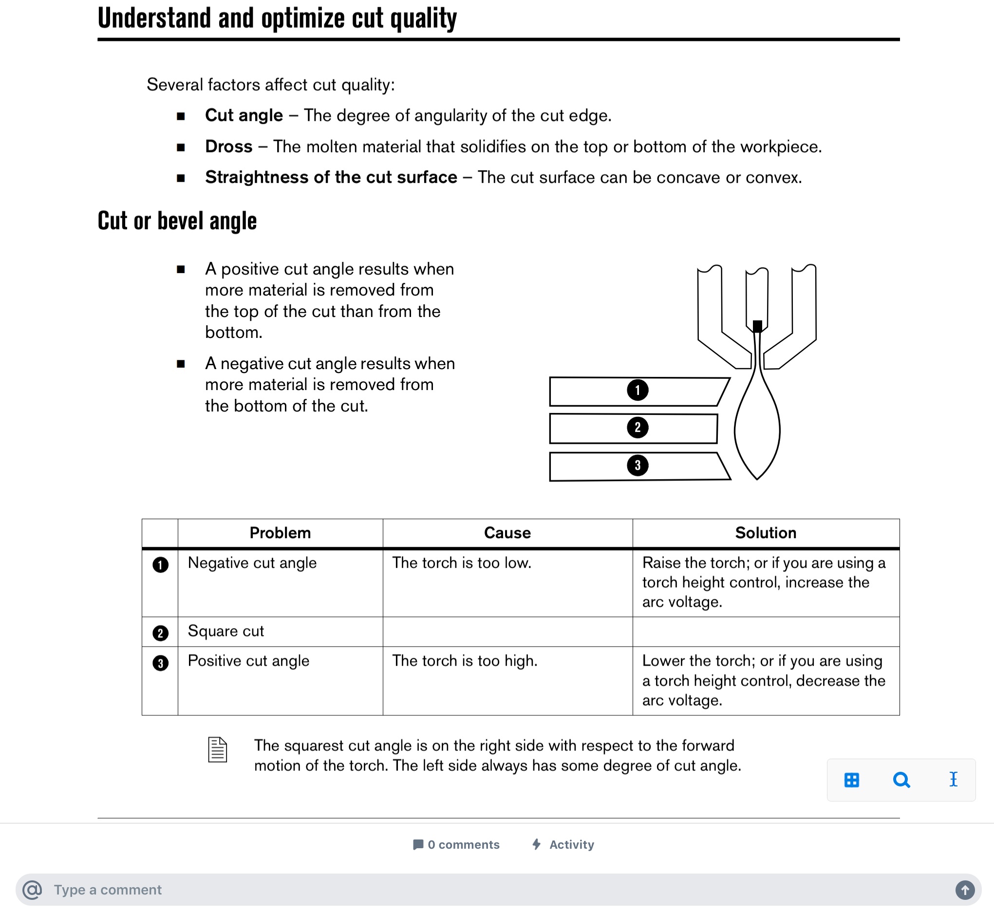

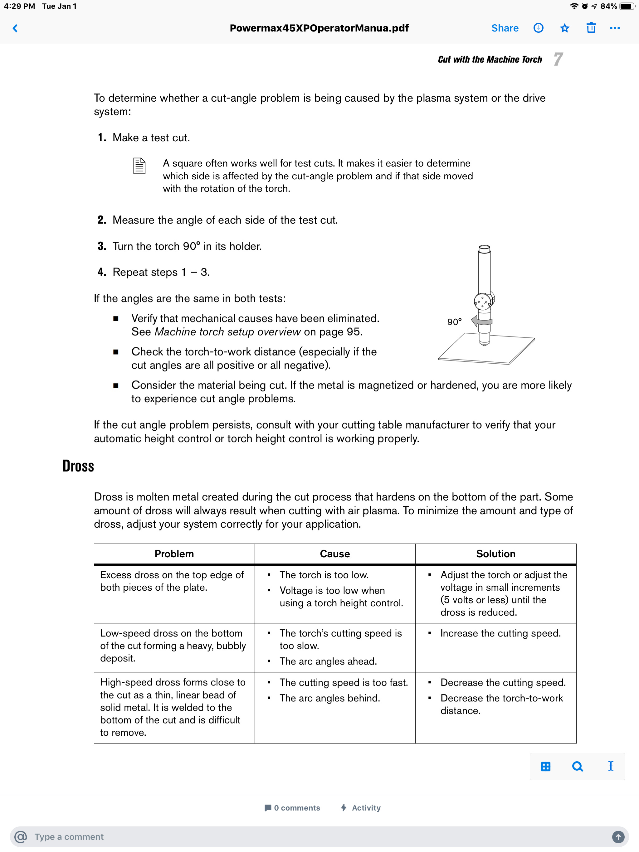

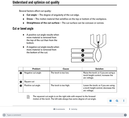

Here is some helpful info from the Hypertherm manual.
Cut quality is pretty decent, and the angled kerf is along the x axis.
Been using a harbor freight cutter.

Can you use a protractor or a square to see how perpendicular the torch mount is to the slat bad?

Just did another piece every side seems to be heavily angled on the kerf, gantry looks to be pretty square both ways, changed out tips.
Not all that noticeable on thinner stuff up to about 1/8” but can definitely tell on quarter
