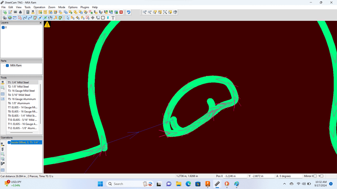

Hi all, I am trying to make some 22lr targets and I was able to get the ram finished today.
But my question is about “lead in” and “lead outs”.
In the below screen shots you can see that the “hole area” for the horns looks good, however it seems to indicate that when it goes to cut out the “body” it starts at the base of the neck and appears to have a small “lead in” coming from the inside of the ram.
I would prefer the “lead in” come from the outside when it cuts out the body
Is there a way to change that?
you need to change your inside offset…to outside offset…that is one way
you might also have to layer your cuts depending on how it was drawn…
layering in sheecam is easy…just google Sheetcam layers
You have “inside offset” selected in your operation. There are very few reasons to ever use that setting in Sheetcam, if you are doing the whole drawing in one operation.
If your drawing doesn’t have errors, selecting “outside offset” will allow Sheetcam to automatically assign the correct offsets for inside, outside and no offset cuts. Using “inside offset” will reverse all of the offsets and give the opposite of what you normally want.
It looks like there is an error in your drawing and I’d bet that yellow triangle in the upper left will tell you that. It looks like the outside outline is not connected, so Sheetcam sees that as an open contour and has assigned “no offset”. The break is probably at the start point (S1). It’s just a happy accident that the closed loop on the horns was assigned an inside offset, because the outside is not a closed loop.

You’re right. I bet that yellow warning says open paths were not offset
You guys are pretty good. The offset was throwing an error.
So do I have to fix it in the Fusion drawing, then redo in Sheetcam to remove the error?

You would fix that in fusion so the outer shape is complete. Then change your tool path I outside offset in sheet cam. It will cut the outside contour on the outside, then recognize the inside one needs an inside offset and will generate from he inside.
OK, so I think I found the problem.
in the screen shot it appears that the last dot is not 'darkend" , but I can not figure out how to get it ‘darkend’.
I keep trying to drag and drop it on the 1st dot to complete the drawing but it will not “drop on” to complete the drawing.
any suggestions?
I think I fixed it.
What say you?
Although, admittedly I have no idea “how” I did it (if it is in fact fixed)
