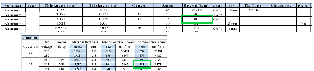

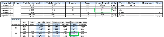

Agree with everything BigDaddy says. I found two cutting charts that suggest you might be going too slow. The cut will be a bit rough as that is the nature of aluminum cut with plasma. And the other nature is that it throws all sorts of fine bits of aluminum around so moving faster might be in your best interest.
Here are two different sources for RazorCut charts:
(Note: Even on the top chart it does not square with what we are saying as there is an entry that says the speed of 40 ipm gave good results with 45 Amps. Then the next entry at 35 amps gave good results at 80 ipm. :man_shrugging:)
Neither BigDaddy nor myself can verify these settings since we do not have your cutter.
