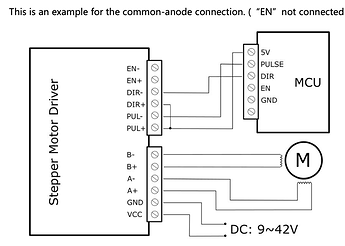

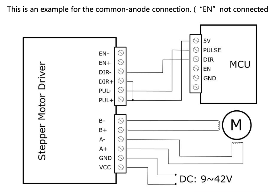

@AlexW do you have any pictures from your stock → LinuxCNC conversion? (That is, the Mesa board with stock drivers and minimal changes to stock wiring).
I am working through your wiring table / notes on OneNote & GitHub and have a few questions that may be answered by that picture.
  • ENA+ / ENA- are not connected to the stepper drivers by default, however you are connected to both of them in your diagram. In your parts list you had a 4x terminal phoenix connector. I assume we shuffle the 2 pin Phoenix connectors and use the 4x Phoenix connector on the last stepper? I’m not sure the difference between enabling the driver from EN+/- or VCC/GND. I suppose the ability of having the EN pins on an output allow selective control of the steppers, but to me if the mill is on we would want the steppers energized.
  • How do you manage your grounds? I have seen the other posts mentioning isolating the touch probe, but do you have a separate ground for +5 / +24 / +36V as it appears?
  • This is not a question, but LS’s choice to go with White = Negative / Black = Positive has caused me a ton of confusion
  • EDIT: I had previously thought these were differential signals (relative to each signal + / -) but my understanding now is that they are single ended and active low. Also, I noticed PUL+/DIR+ on the MR1 controller are both tied to +5V, do these need to be connected directly to the controller? The controller has separate +/- channels for both pulse and direction.
EDIT: I decided to use DIN terminals to join common signals together (such as +5V / +36V). Similar to previous question, how do you manage jumping multiple terminals on the 7I96S? I am using ferrules and can potentially squeeze two into one

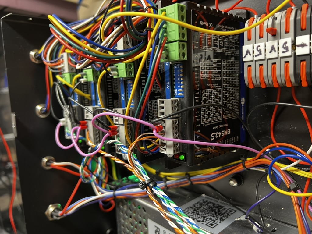

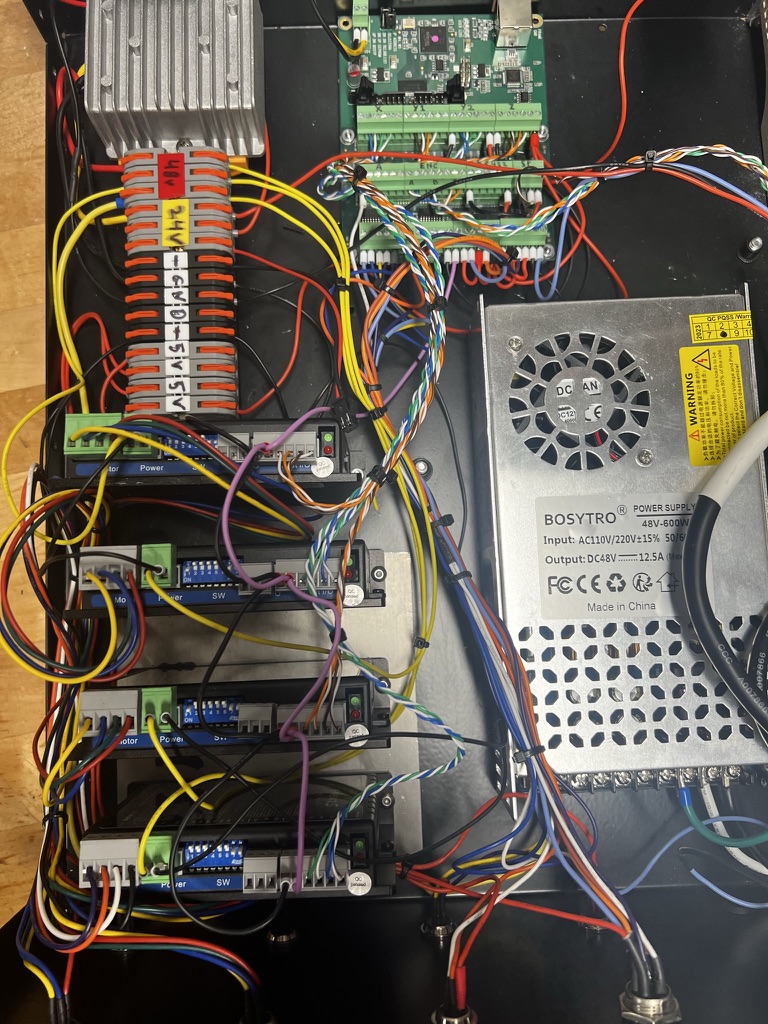

I did my initial conversion in the Langmuir box and with their spindle servo. I can dig up pictures of that if helpful. I had a common DC negative across all of my DC power supplies.
Here are some photos. The purple line is the ENA circuit to the 4 stepper drives. These aren’t the same drives that Langmuir used, but they have the same enable circuit (including the odd choice to have 0V be enabled).
This is the general layout that I used, with the Mesa 7i96s mounted near where the original CutControl/GRBL board lived:

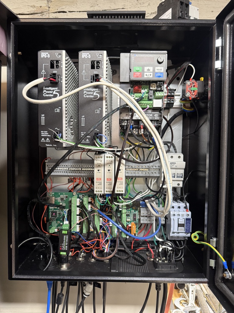

I’ve since completely redone my control in a new wall-mounted cabinet and using Clearpath servos. I wish I had replaced the control cabinet earlier, it’s much easier working with this one that has an opening door and where it is mounted at roughly eye height. The two power supplies in the upper left corner are for the servos.
