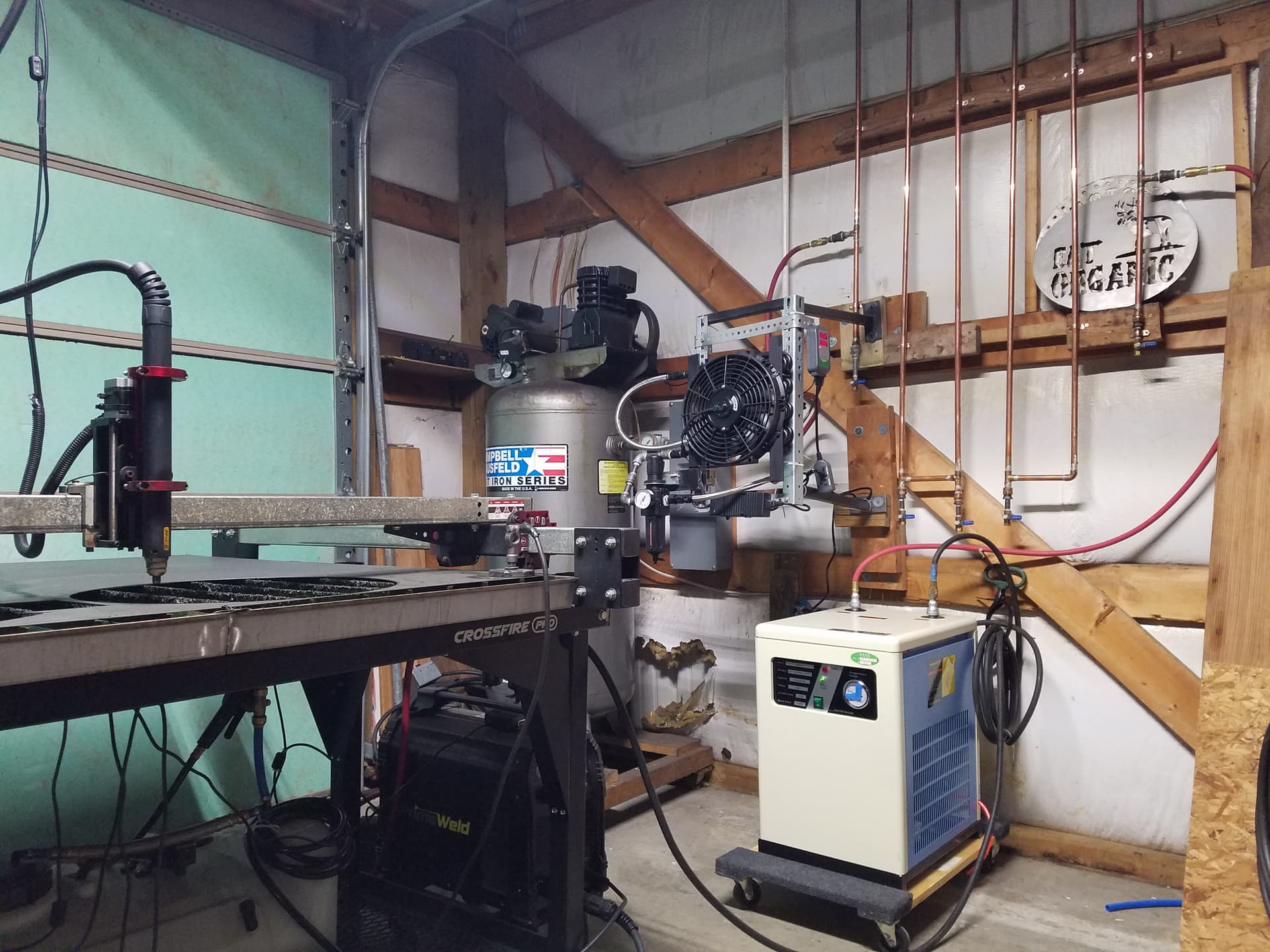

I am hoping I have everything in place now to get my Dry Air merit badge! Pretty excited to see if I get results.

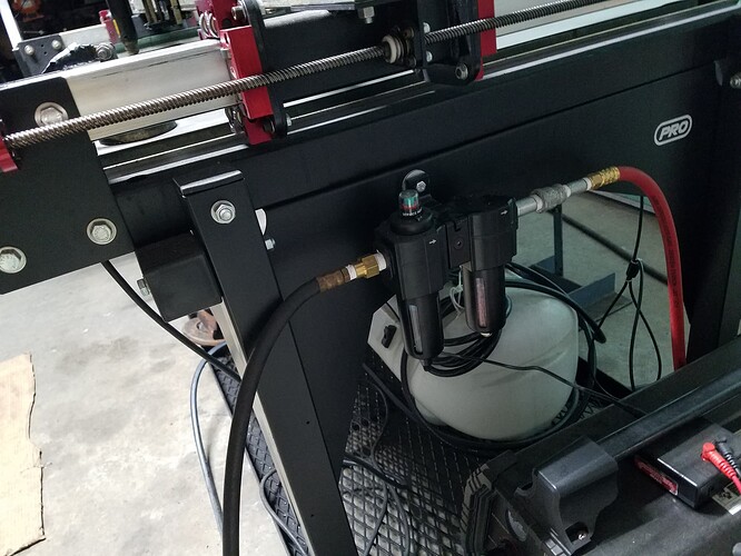

I know there is debate about the order to place each component, but right now I have: post tank filter and regulator; A/T cooler w/temp activated fan; copper drip loop system; HF refrigerated dryer; filter; dessicant bead canister; small filter on the back of cutter.
I haven’t cut yet with the refrigerated unit attached. With all the other components in place, the only moisture I could actually see being removed was a small amount from my first drip leg and by my dessicant beads. Moisture was still reaching the beads and turning them pink faster than I’d hoped, so I bought the HF unit.

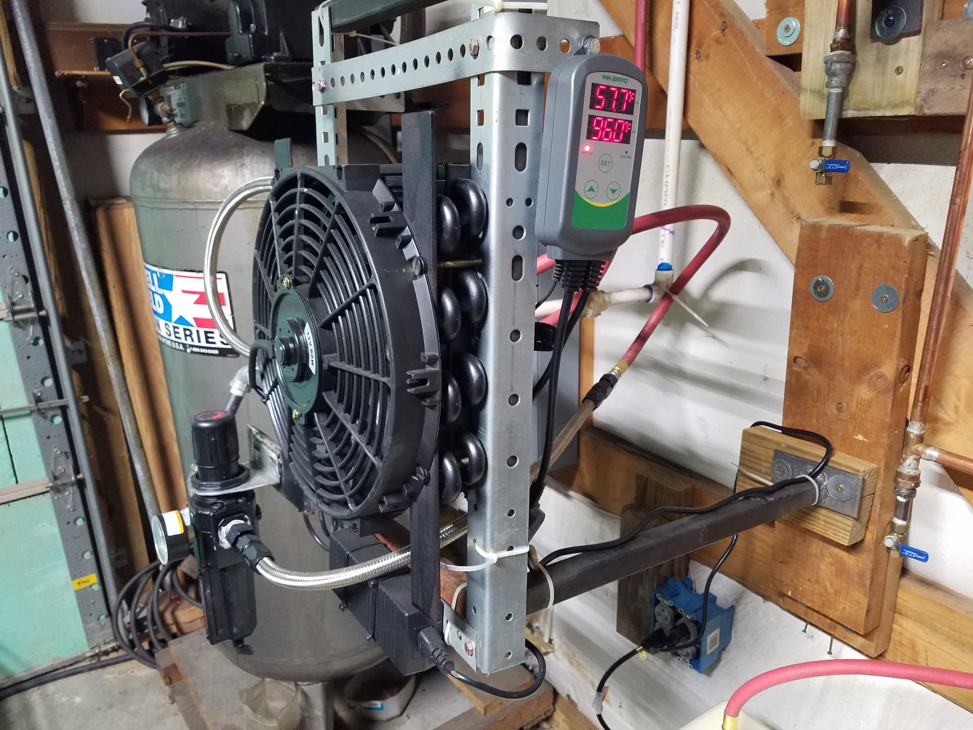

AT cooler frame isn’t pretty, but I always try to use scrap metal first when function is fine without form :grinning:
I located my thermocouple on the inlet line to the A/T cooler. I know others put it on compressor outlet, but I figured there are times I use compressor for other duties (bypassing dryer) and also it is running often when there is no downstream demand, such as after a cut finishes. Just my take on it.
You will remove quite a bit of moisture with that setup. I have a very similar setup no copper cooler I have two trans coolers though … even with all that your beads will catch moisture. I am amazed at how quick mine change.
I have been cutting a few nests with 41 minutes of arc time per nest. My beads are ready to change when 8 am done.
You betcha!!! Looks great. Most people put a Keurig coffee maker right after the copper drip loop system. But I think your system will work fine without it.:smile:
Thanks for the reply. I thought I was having to change them too often, but your reply lets me know it’s probably just an unrealistic expectation/lack of experience thinking that they would last longer.
