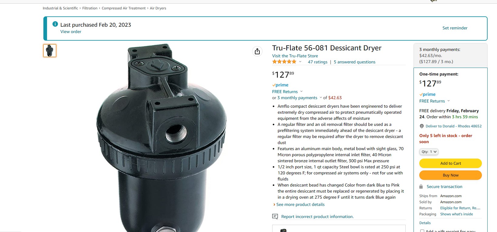

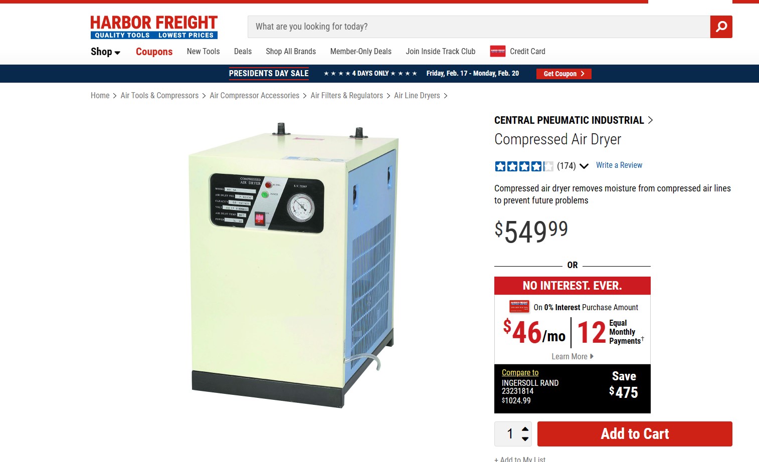

I have ordered the Harbor Freight air dryer and that is where the air goes next. Thanks to @toolboy recommendation of the temperature sensor switch, which I have ordered, there will be a Lasko 20" inch fan blowing upwards toward this coil and cooler core. Prior to reaching the plasma cutter, I have Tru-Flate Dessicant filter that will catch any remaining moisture.
Just ordered this filter tonight to put between my new air dryer and plasma cutter. I had my compressor drain line freeze which is what started all of this fun spending. This should be overkill but moisture in air is not fun! I have couple new signs ready to cut for my pole barn front. I started doing a bunch of the gas and oil and other popular signs for myself.
I just shared my plans for the bracket for that desiccant dryer in Fireshare:
https://www.langmuirsystems.com/fireshare/tru-flate-56-081-desicant-dryer-bracket

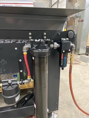

Ok so I have things mounted and I did add a Wilkerson M28-04-CK00. Found it on eBay for $35
I also added a high flow coupler and Plug to air hose.
“M” Series Coalescing Filters, with Type “C” 0.01 micron elements : All Wilkerson Type “M” Oil Removal (Coalescing) Filters with Type “C” 0.01 micron elements exceed ISO Class 1 for maximum particle size and concentration of solid contaminants, and exceed Class 1 on maximum oil content (ppm/wt).

How long ago did you buy the refrigerated unit from Harbor Freight? Their website has been saying “out of stock” for months.
It was shipped on Feb 20, 2023 so about a week before that. Right now it is showing that I can order it. Try picking another store. Sometimes, that affects the listing for some companies like Walmart. Perhaps that is what is happening to you.
Realize that this is an item that is exclusively ONLINE. You won’t find it in any of their stores. Maybe, it used to be in the stores but no longer.
Wow! It actually showed up today using my local store. Ordered one. I must have checked 10 times since November and it always said “Unavailable”. I must have bad timing!

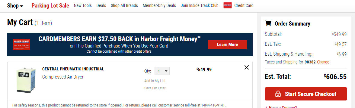

I can’t believe they only charged $6.99 for Shipping and Handling. Those Ruland Black Oxide couplers on Amazon are $13 each plus $10 shipping.
I noticed that they have added a little caveat to the purchase: “Once opened, do not return to the store.” So if it breaks during the warrantee period, you will need to box it up and pay the true shipping charge to wherever they say.

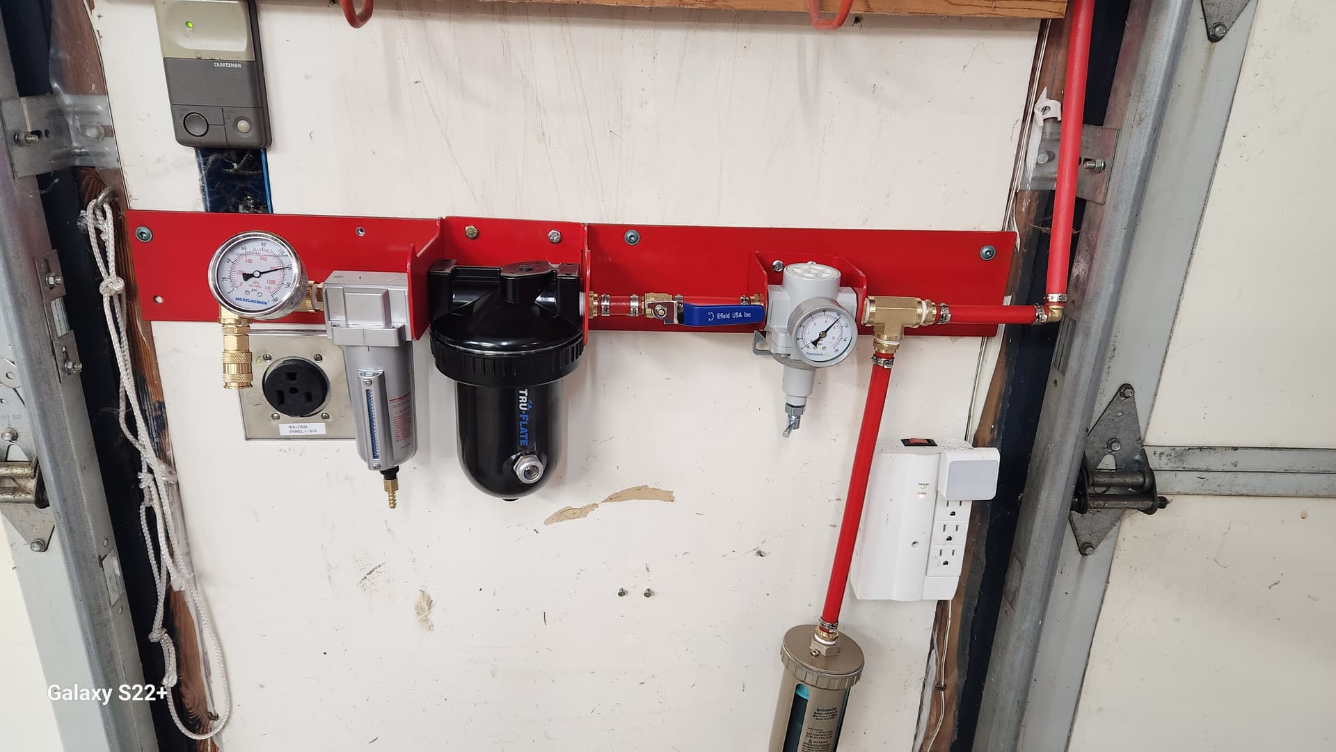

here is mine…
I know!!! You were my inspiration to do something. I just knew that I could not do what you did. I tried to figure where did I have a wall space for suspending a dry tank. As it turned out, yesterday I was cutting for about 3 or 4 minutes before I got into trouble. The torch kept quitting. It turned out that I forgot to turn my air compressor back on (after all the plumbing). So…if I can cut for 3 minutes before I need the compressor, I probably can keep up with air demands if the compressor is turned on.
I loved your suggestion for the temperature sensor. I ordered that the day I saw your posting. It works great. I have the fan and the drain of the tank on that circuit. The drain cycles open for one second every 20 minutes. So basically, every time that circuit turns on the drain is opened once.
