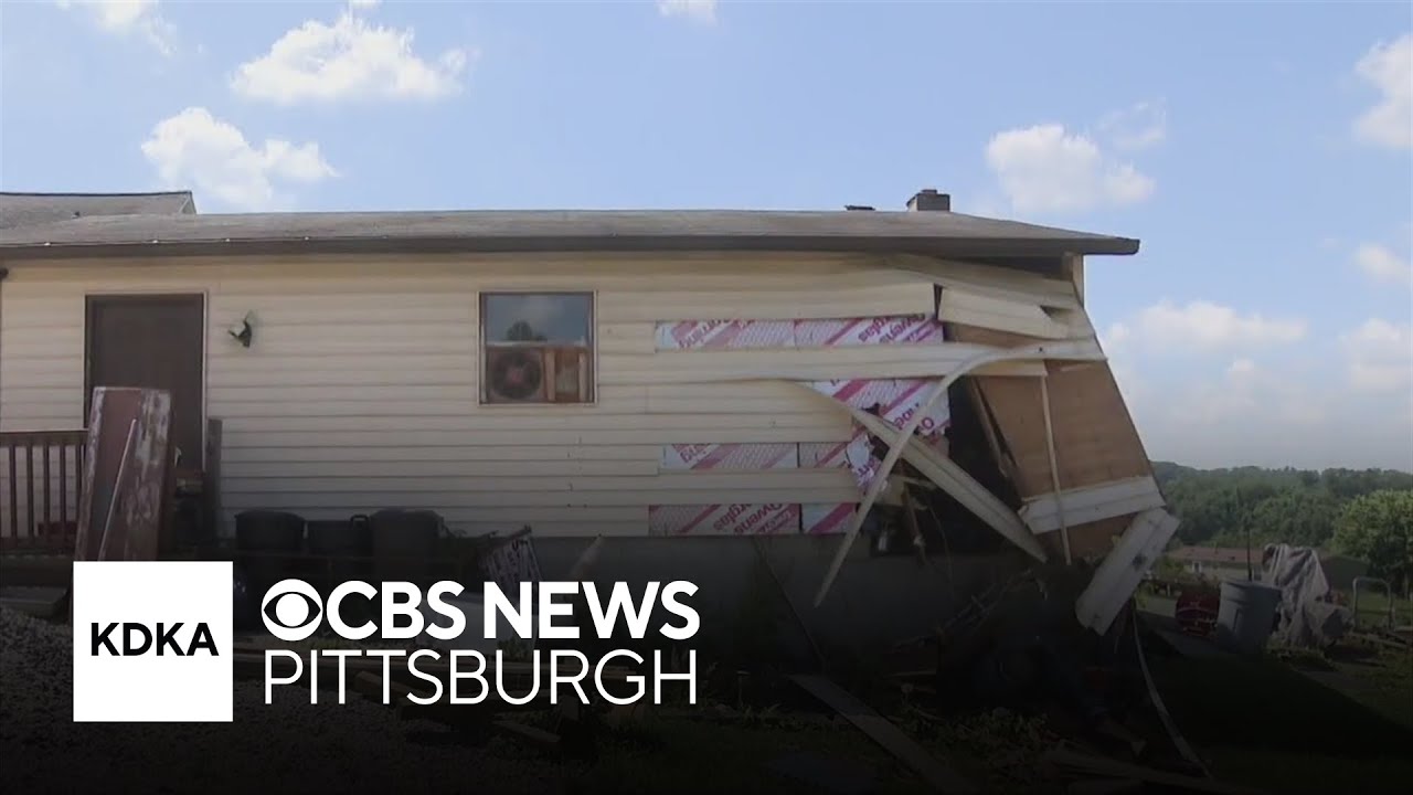

Not long ago a friend of mine called and said he had a 80 gallon compressor with a small leak and asked if I would do repair patch. I immediately refused and begged him to scrap it.
Poor guy just trying to enjoy his shop. RIP.

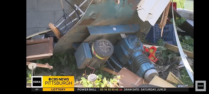

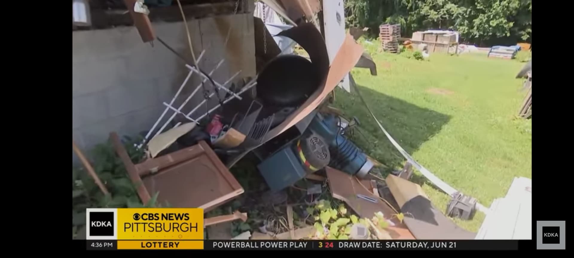

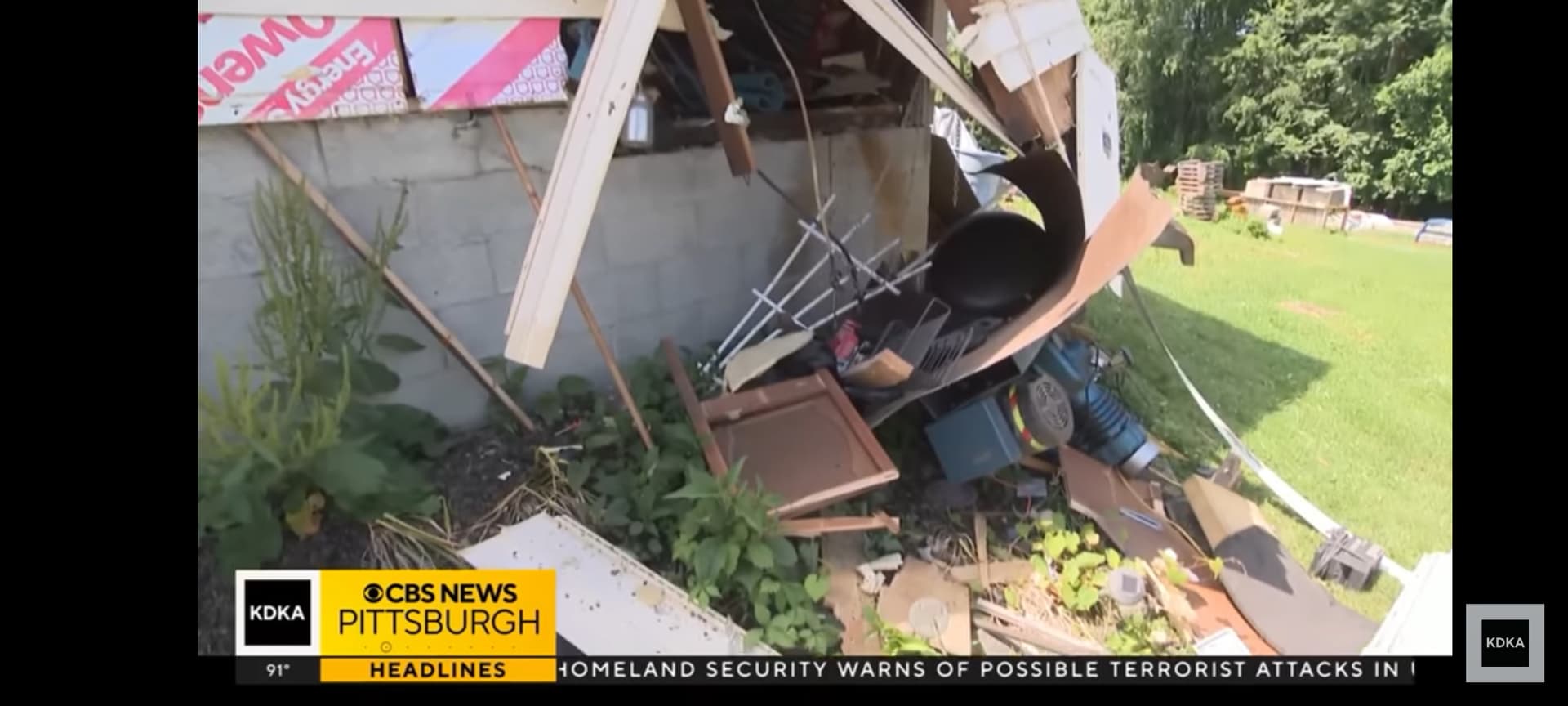

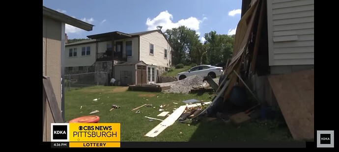

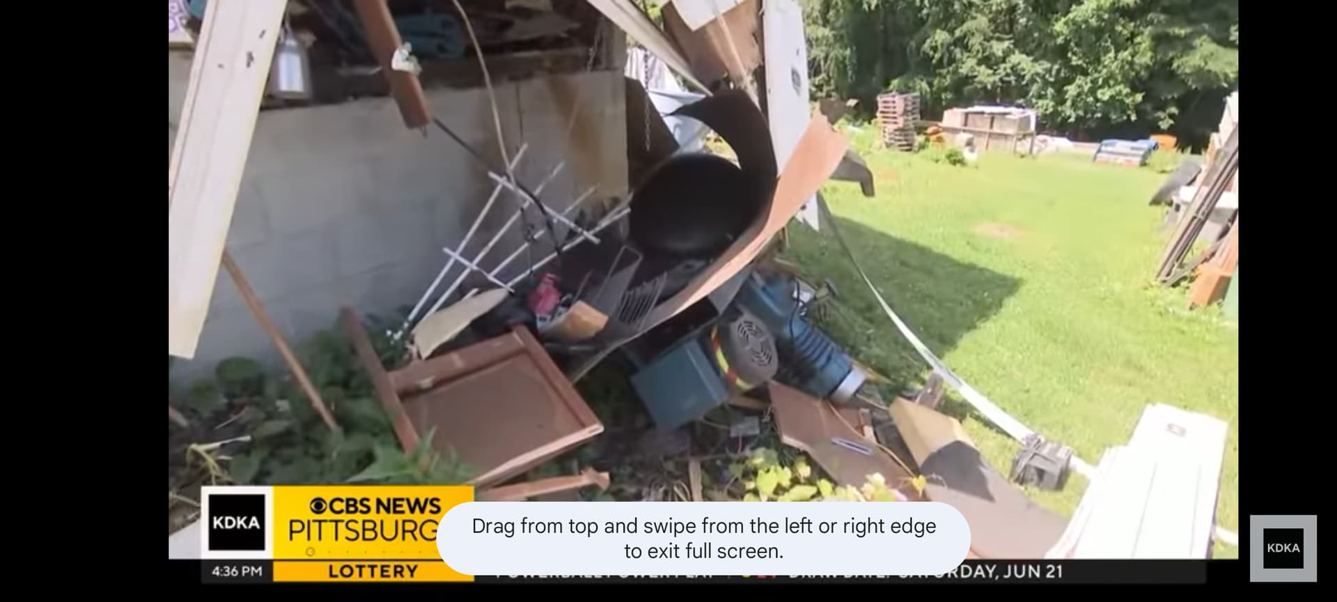

It looks like the bottom of that compressor might have been pretty rusted it peeled open and popped the end cap right off.

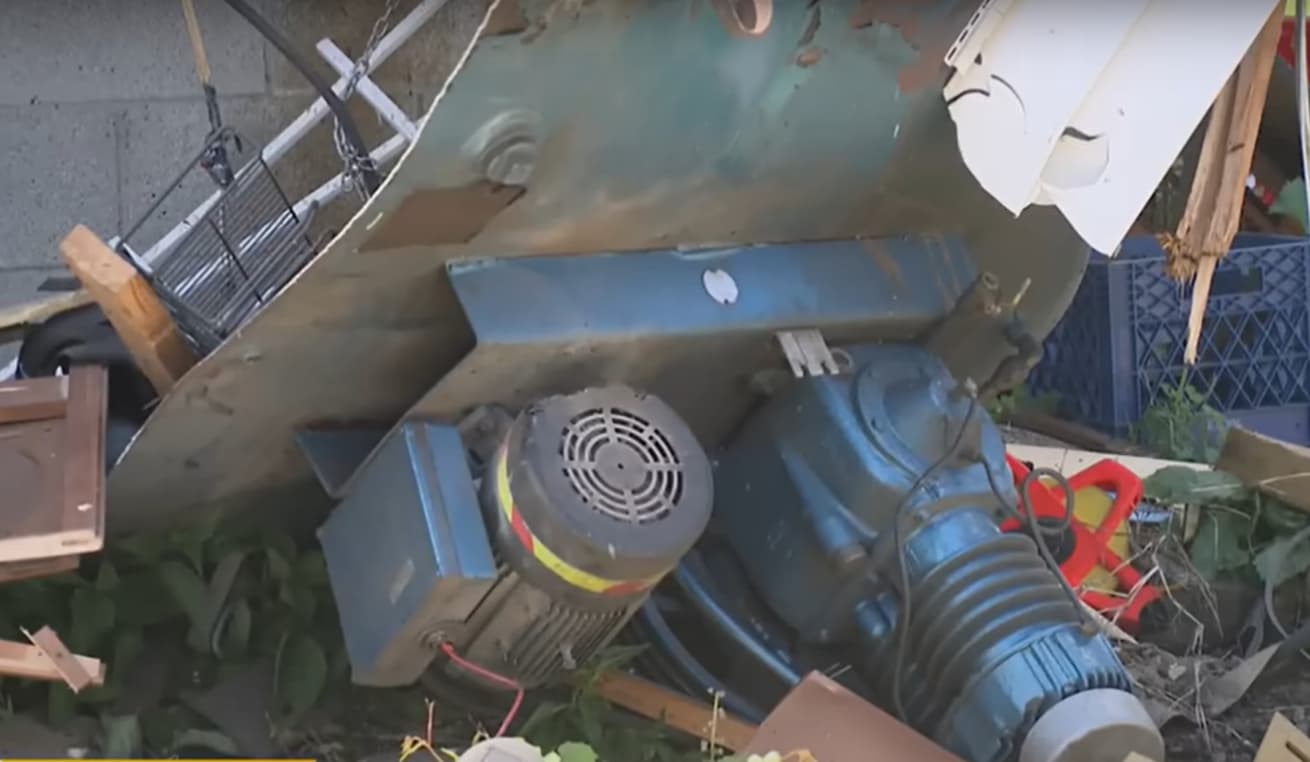

I took a couple screenshots and saw that this caution tape was added to the motor assembly it got me thinking that this could have been a decommissioned compressor taken home from work?

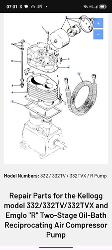

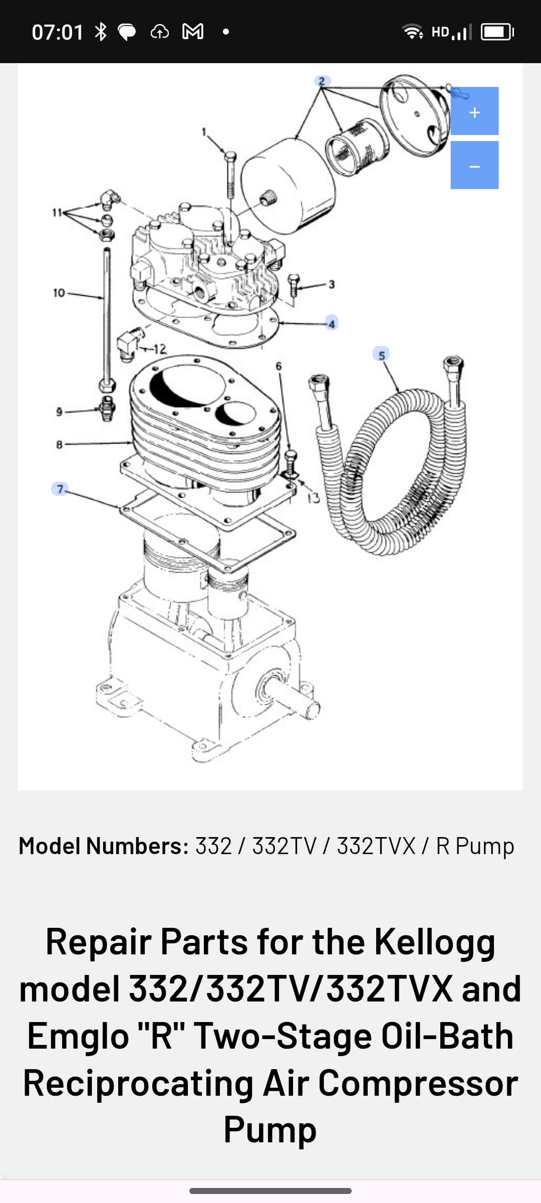

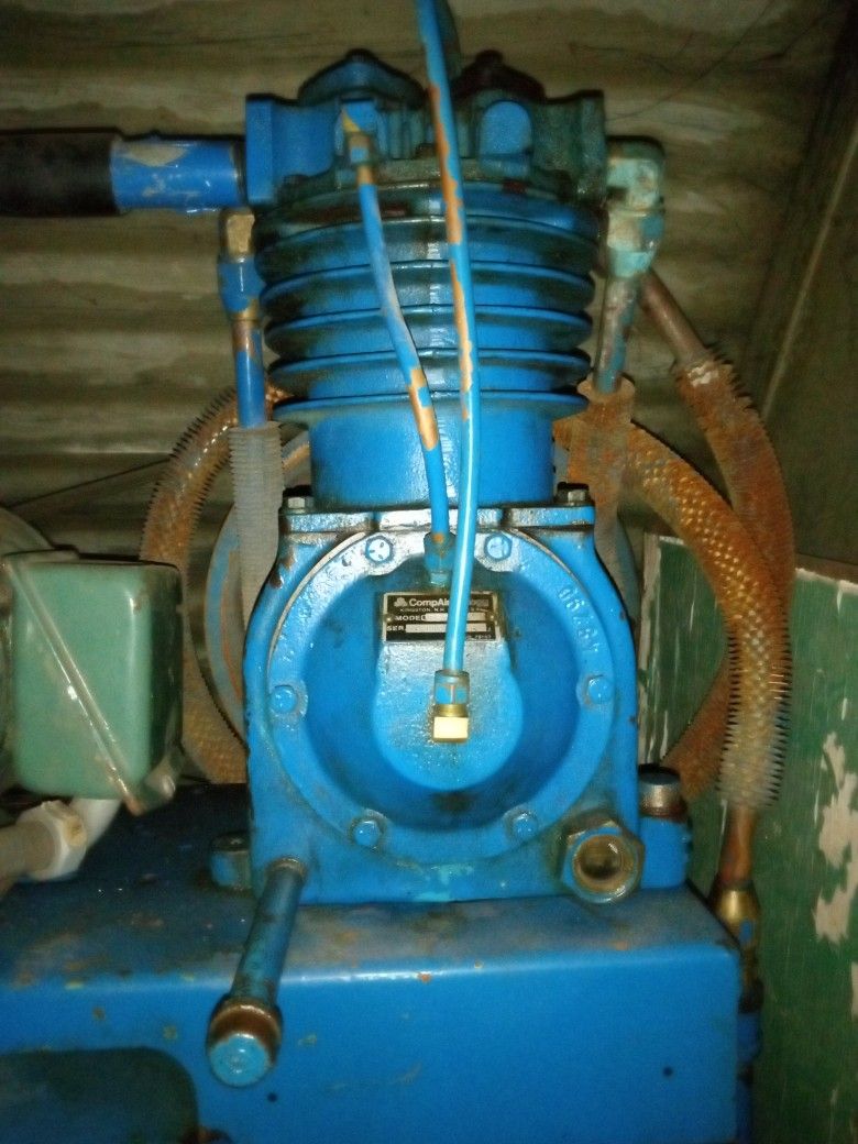

The compressor might be this Kellogg type
Edit.
Maybe a slightly different model of Kellogg pump?
It feels like this might have been a decommissioned compressor from either the fire department he worked at or somewhere else he worked at.
So likely it was fully certified until it was taken out of operation maybe for the rusty tank?
The reflective flagging tape on the motor does not feel like something that a homeowner would do or that would be offered on a residential style compressor from factory.
