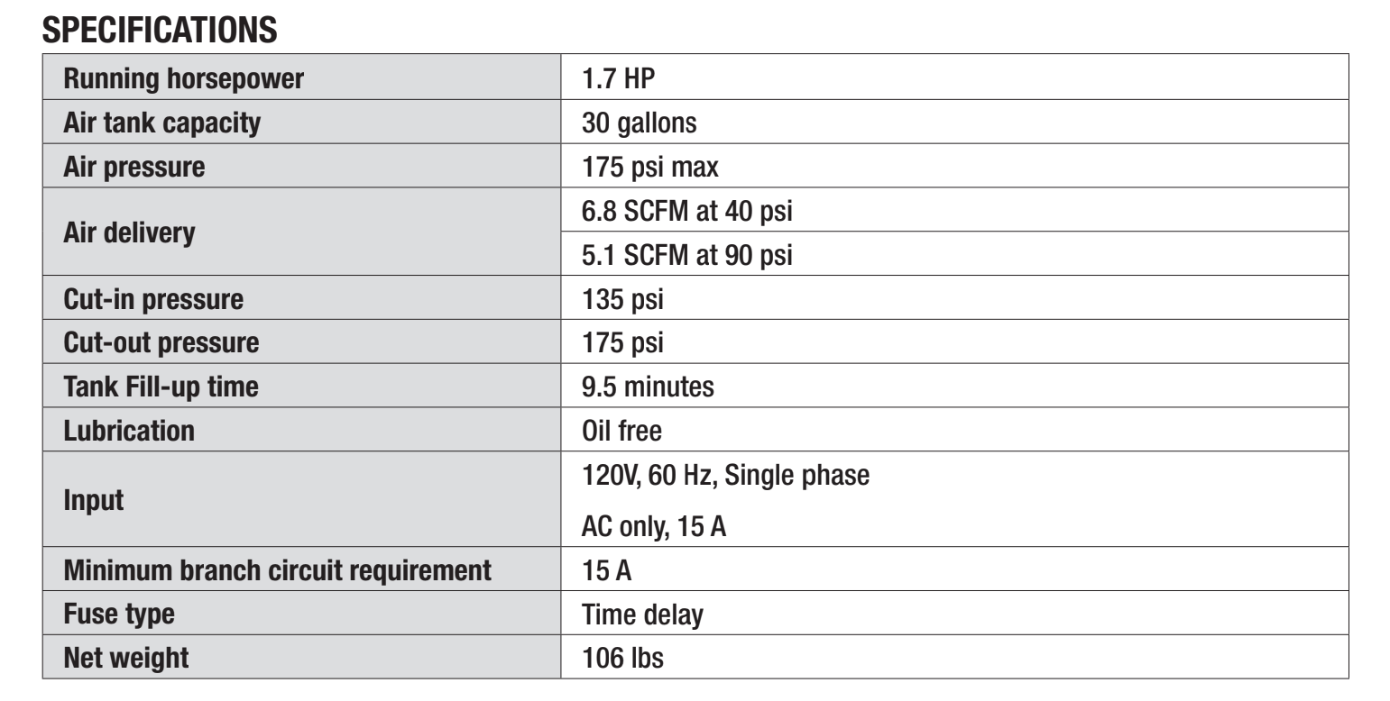

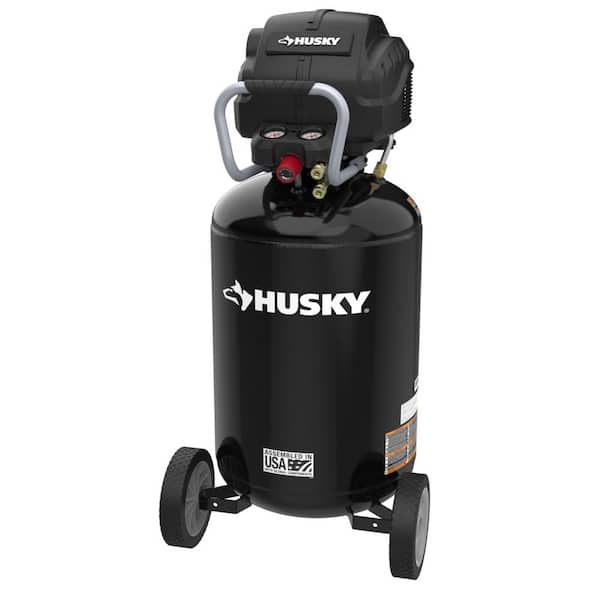

Model # C305H
This compressor?

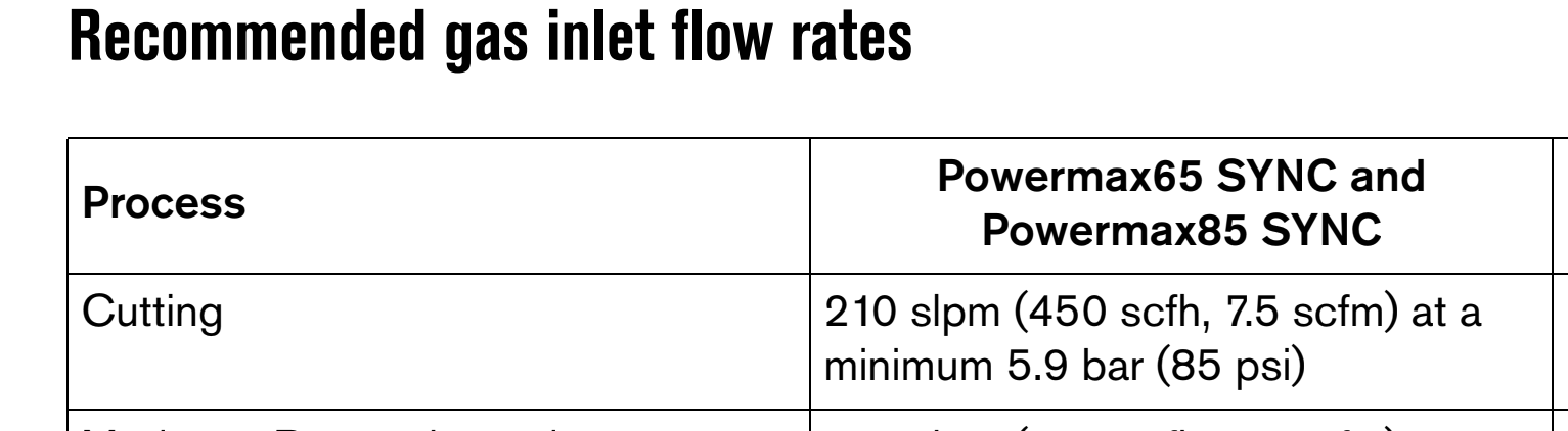

The specs for this compressor does fall below Hypertherm’s recommended minimum
Page 59 of your user manual
If you’re doing hobby level stuff this would probably get you by. If you plan on doing anything serious I would buy a more serious compressor that’s above Hypertherms minimum.
7.5scfm @ 85psi minimum

Is 27 gal.
