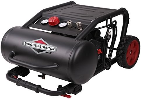

As a noob to plasma cutting I wanted you opinions on this compressor.
I have RazonWeld 30 FYI. I think the answer is no on this compressor but wanted to ask anyway as its in the price point I wanted to spend.
Thanks!
I’m using the DeWalt 60 gallon 240 volt compressor with air dryer and filter.
