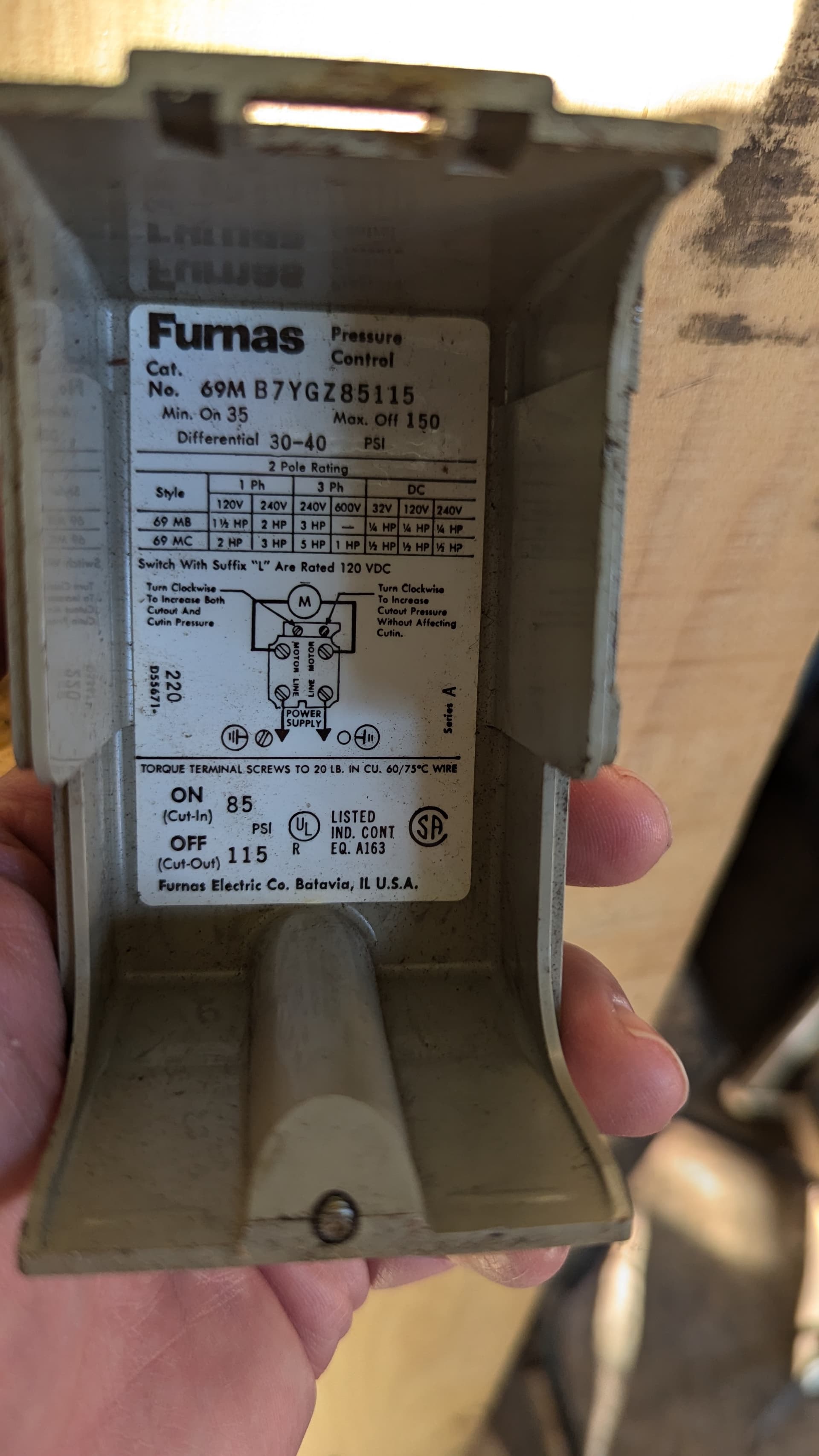

This is what a typical switch looks like. most times this will also be used to turn the the compressor on and off, and to adjust the cut in nd cut out pressures.
Find that switch on yours, remove the cover and take a pic and post it. Also the brand name of the switch will help.

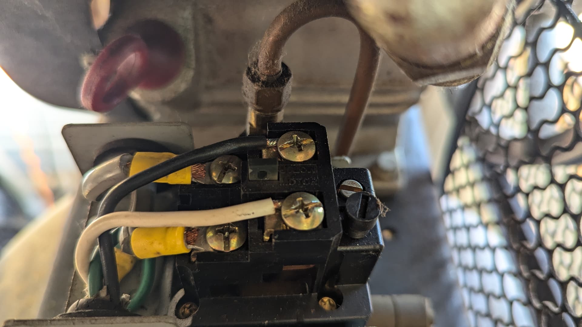

Furnas is the brand of the switch. When I take the cover off there are two adjustment screws, I cannot see any markings as to which is high and which is low pressure.

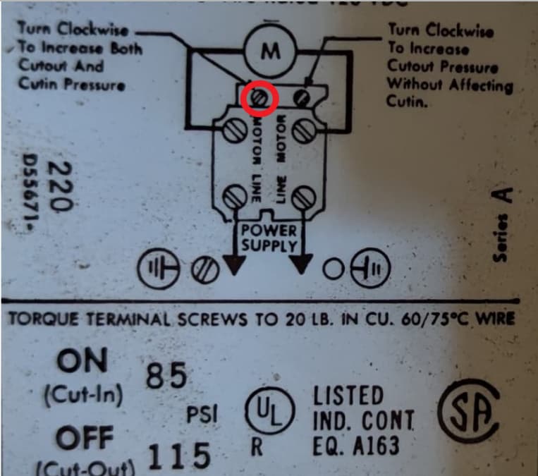

The adjustment schematic is inside the top cover. You may need the higher-pressure version. That one you have is designed for 95 turns on and 125 off. They make one that is 125 on, 175 off.

What a great photo!!!

You want to turn this screw clockwise. Turn it about 1/2 a turn at a time. Release some pressure in the tank until the compressor kicks on. You will get a feel for how much turning of the screw is necessary.
Turning in that screw got me a range of 90psi - 125psi.
