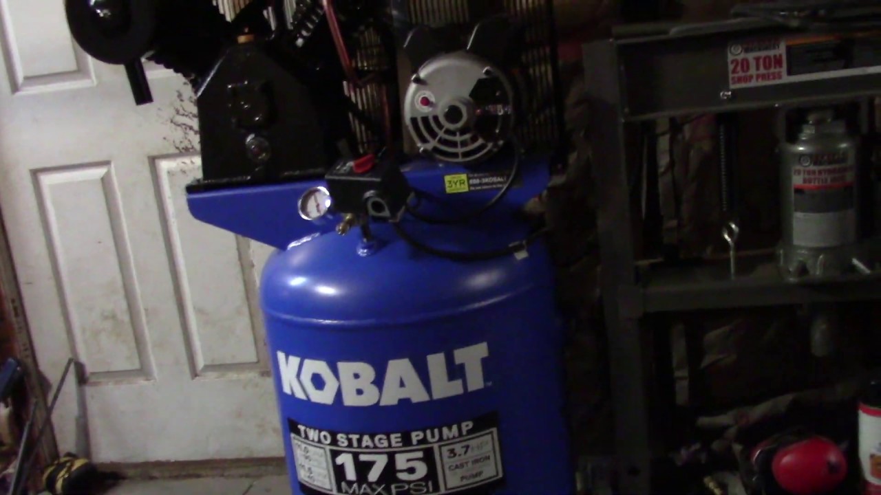

Maybe… but price with warranty made the decision for me. Kobalt (Campbell Hausfeld) 60gal 2 stage 175psi out the door at Lowes with 4 year extended warranty beyond the initial 3 (7 total) $700.

I’m assuming that’s what they call the Kobalt now. I looked at that but the cfm @90 is only 7.6, lower than I’d expect.
I think this is the one you are referring to?
https://www.lowes.com/pd/Kobalt-60-Gallon-Two-Stage-Electric-Vertical-Air-Compressor/1000542193
The Lowe’s web site is wrong
. Go look at it in a store - I think it’s actually 11ish CFM, which is plenty for plasma cutting and many other things…I almost got that compressor - it’s a pretty good deal.
I’m not sure, James, it’s only 3.7HP and two stage so high pressure, but not necessarily high volume. 175 PSI with 6.7CFM might be right for this compressor. Since it’s two stage, I’m not sure the 90 PSI rating is almost twice that…
Next time I’m down there I’ll try and grab a pic of the label. It doesn’t match the web site - that really confused me when I saw the online specs - didn’t make sense. But you are right - it’s 3.7ish HP. Mine’s a 60 gal 5hp at 15cfm 2 stage. This one puts out a little less than that - mainly due to smaller motor.
Edit: It’s really weird on this one - web site says 6.9 @175psi, manual you can pull up on the web site says 7.6@90psi and the actual compressor label in the stores says 11 something CFM. Whomever did the web site stuff got things mixed up with another compressor I think.

Screen shot of label:
This even has a link in description to same compressor.
It’s a pretty decent compressor - 3 yr warranty so hard to go wrong for the price.
Vindicated for sure! Good job, James! Now, if Lowes/Kobalt could be as diligent as you…
IF the label on the actual unit matched the actual performance, you are, indeed, correct. A very good buy at that! Unfortunately, the sloppiness of one of the two companies has tarnished the credibility IMO.
