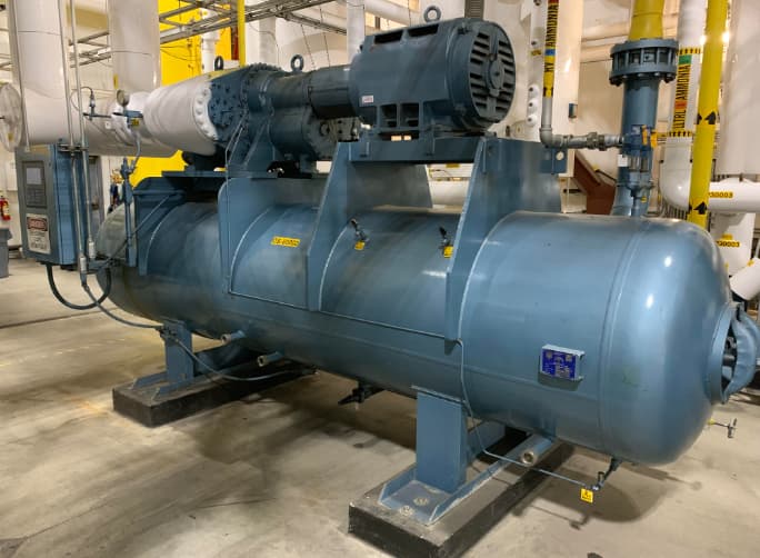

I think that is the machine @Bigdaddy2166 is running.
This is my badboy… Had it for many years.
Almost 30000 hrs on it. I bought it at an auction for $1500.

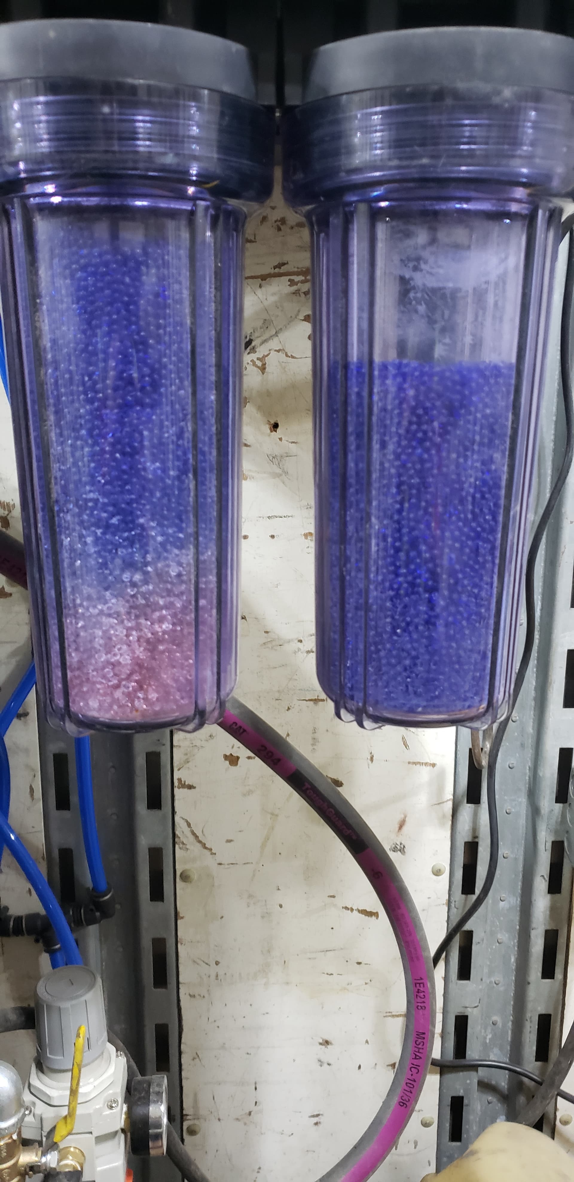

This is my desiccant traps after half an hour of combined pneumatic angle grinder (2hp motor), die grinder (1 hp) and chipping gun use.
I think it’s working

My desiccant traps are NOT recommended***. They are whole house filters in series with a piece of PVC pipe running to the bottom as the inlet to force the air to travel through the desiccant.
*** Safety issue. not designed for compressed air, although rated for 120psi, that is water pressure, not air pressure and a failure of the container could cause serious injury or DEATH!!!
