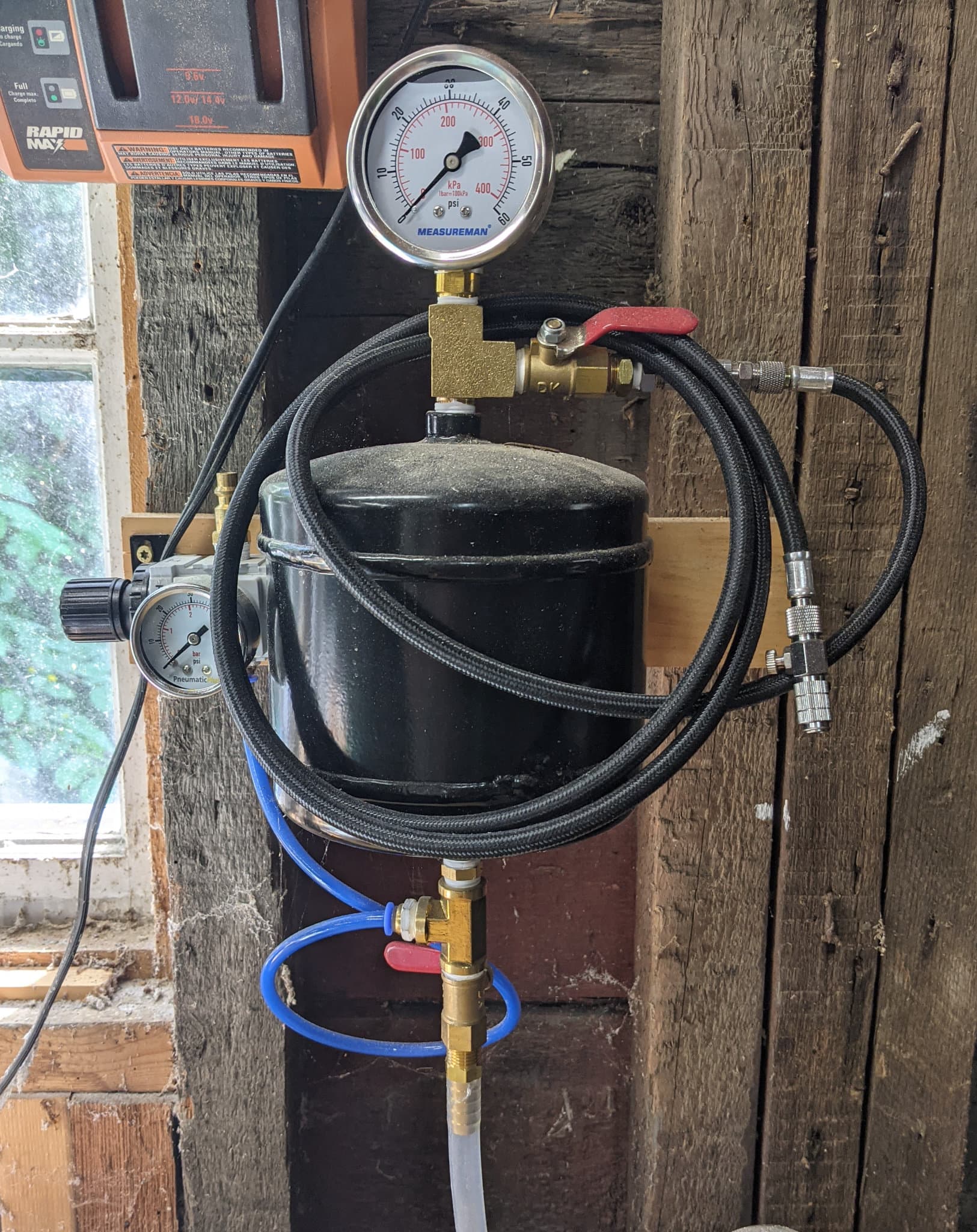

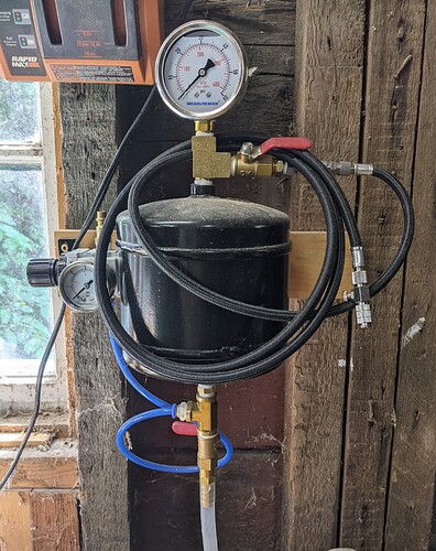

I use a 0.5 Gallon air tank (Amazon Amazon.com) hanging on my shop wall, both as a ‘water condensor’ and as a buffer to filter the pulsating pressure from my compressor. Air is teed in at the bottom with an additional ball valve to drain the tank and the air line to the air brush is tapped into the top. Fittings are 1/4" FPT for the tank so hopefully not TOO unappealing for you… :roll_eyes:

Got a picture of the plumbing?
I’ll see what I can dig up… It’s not much more than I described…
Here ya go…
Air supplied via quick connect, through regulator, teed into bottom of tank where there is a drain with a shutoff valve. Air Pressure Gauge teed with shutoff to Air Brush hose. Not tricky and it takes care of any water from my very old, sloppy, air compressor running in a very wet garage.
Thanks broski. I got that tank on order.
