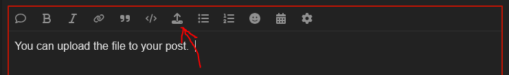

Forgive my ignorance, but when I try to share it, says the link will be editable. Is there a way to share it without it being editable? I can copy and paste directly into my reply?
You can upload the file to your post. Use the Upload Tool above:
ironworker base2.tap (5.9 KB)
Let’s see if this works.
