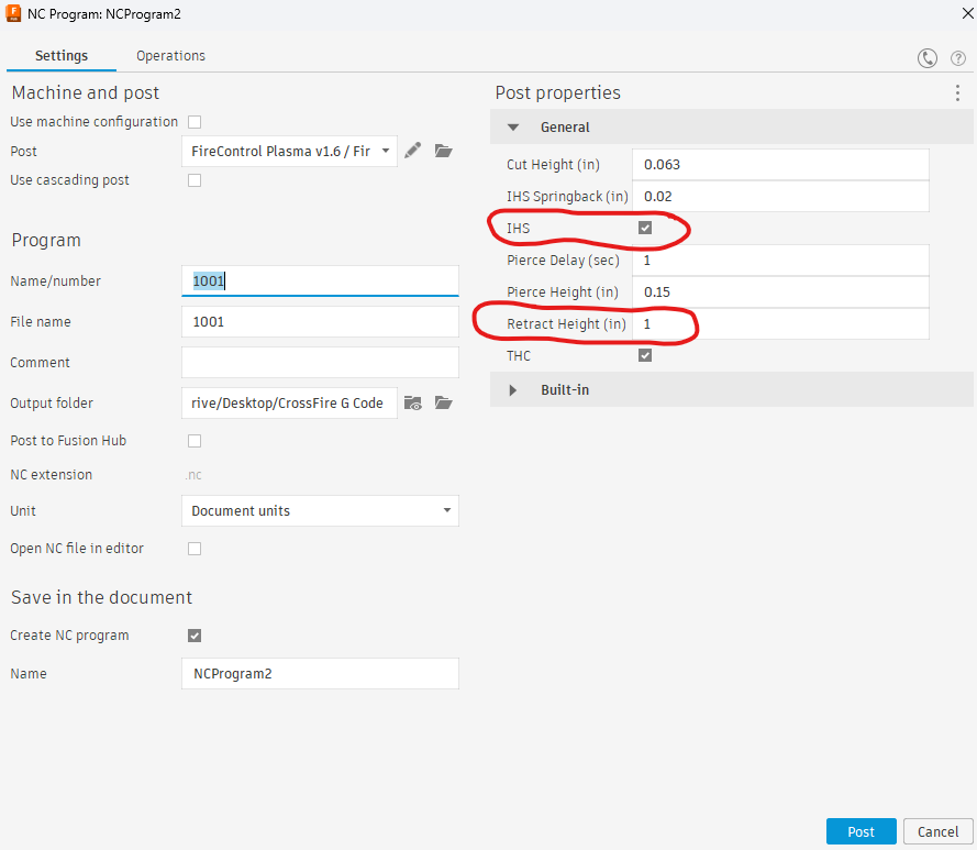

Ah. So it looks like you don’t use IHS (Initial Heigh Sense) in your Fusion360 Post setup.
I’m using a CrossFire Pro with IHS. At the end of each cut, my machine retracts to 1 inch above the work piece (Z=1) and then touches the piece on the subsequent cut to reset the cut height for each cut. This is an upgrade over the original Crossfire as I understand it and produces better results if the material to be cut is warped etc.
I exploited the ‘G0Z1’ at the end of each cut to write all the code for my program.
If you are not using IHS with a retract height of 1 inch, then my program won’t work for you.
Here’s a screenshot of my Post settings in Fusion360:
Also here’s a few lines of one of my G-Code files from Fusion360. They are different from yours because it looks like you aren’t using IHS.
