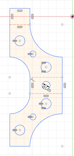

Adding in "break Lines" for bending

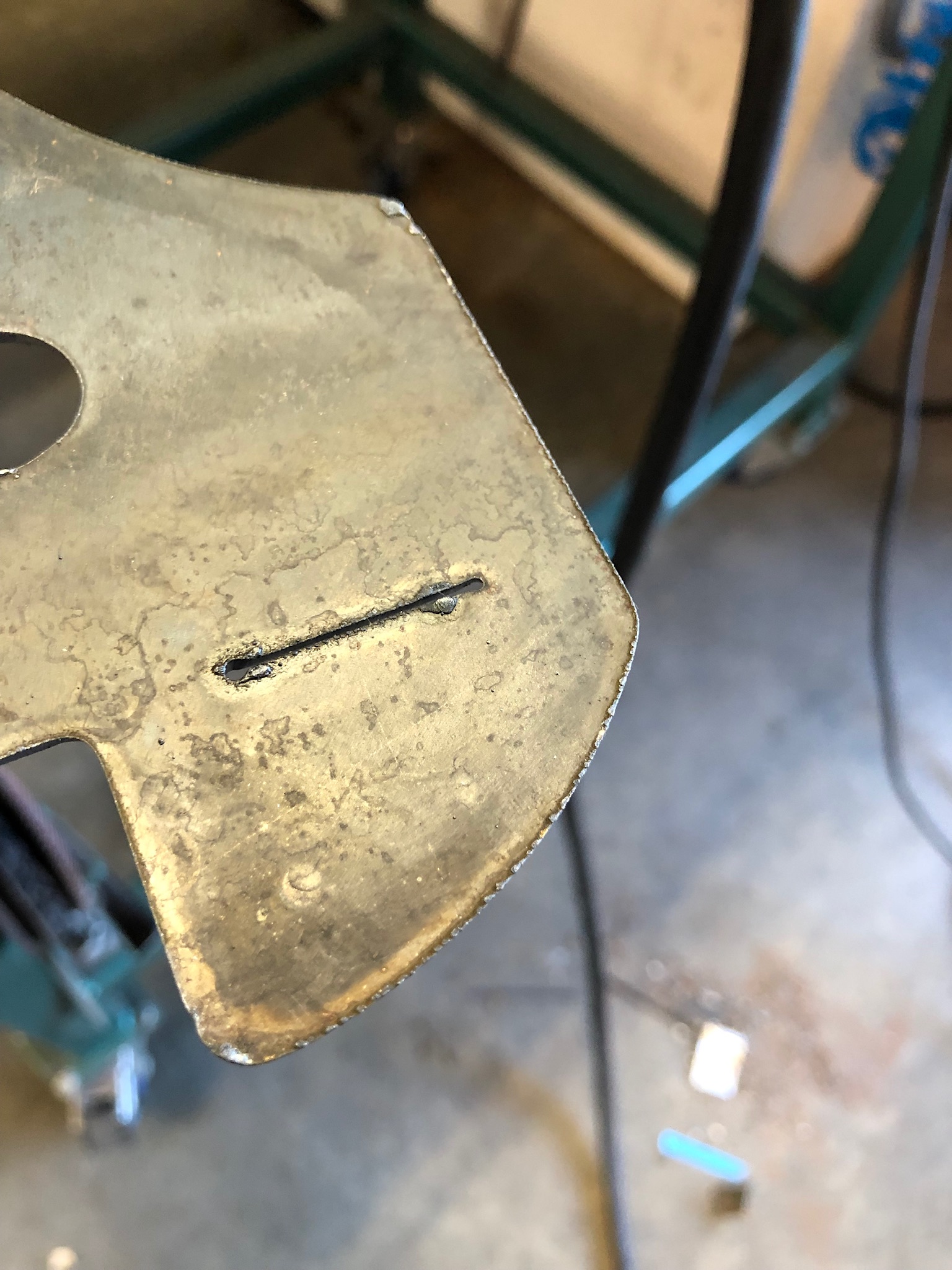

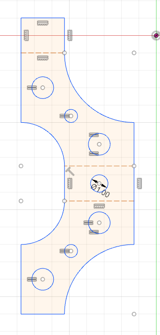

Anyone doing this? I have been designing some parts that need to be “hand broke” to bend into shape. I basically just want to cut a line part of the way to be able to reweld after the achieved bend is in place.
Are you able to just draw lines? or do you need to make a “small rectangle” to make the plasma cut it?
Where i have my construction lines is where i need to make 90* Bends to form the bracket.

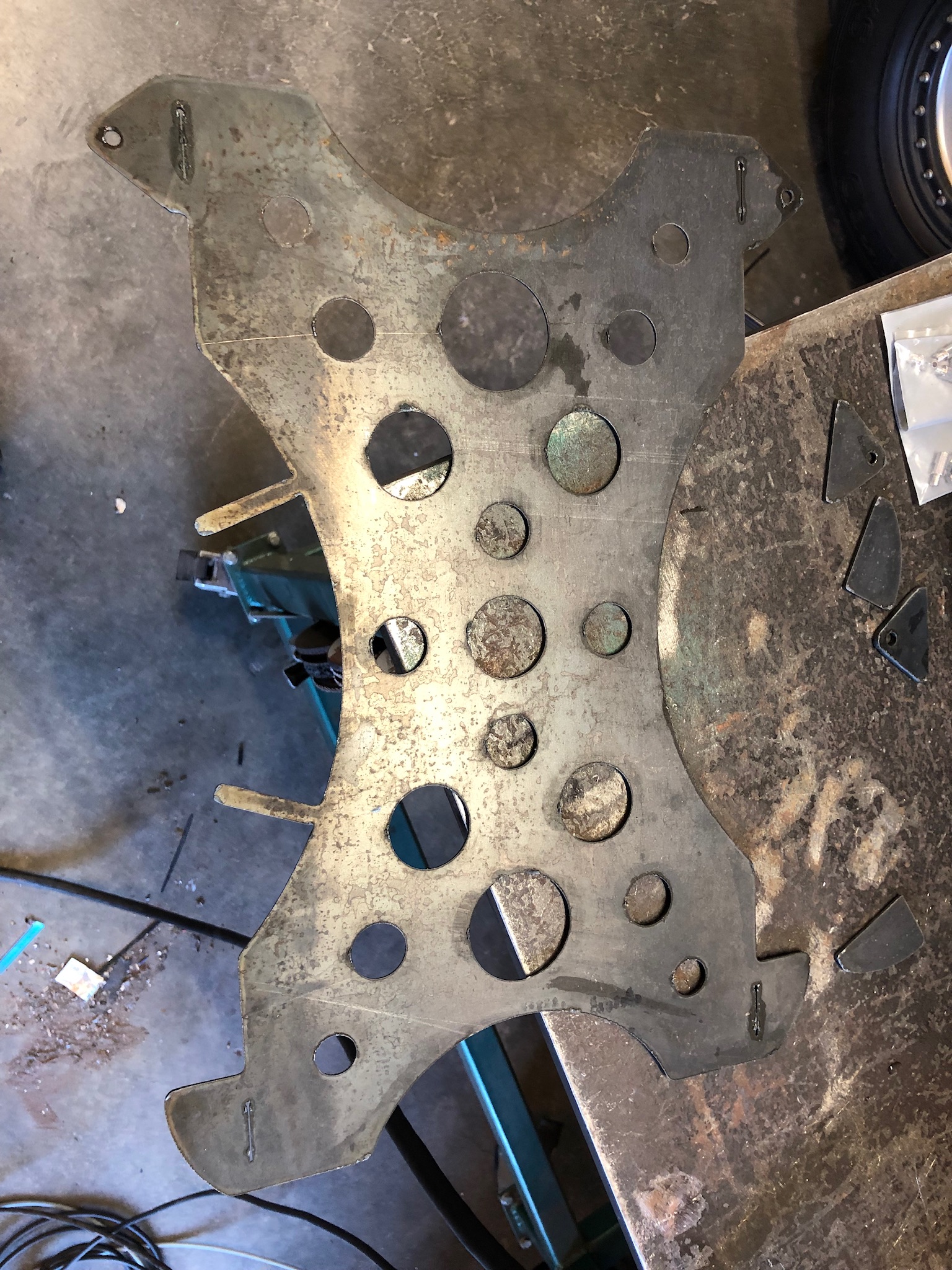

This is for a welding table to adjust the level on each corner. Will have a nut welded and use threaded rod and machine feed to level my table out on my concrete :smiley:

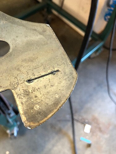

I just draw a short line at the point you want to bend, then just do a cut with no offset.
NICE! Please post pictures and progress!
Ok sweet that’s what I needed to know, it will be tig welded … I’ll give that a shot today and Ware what happens
