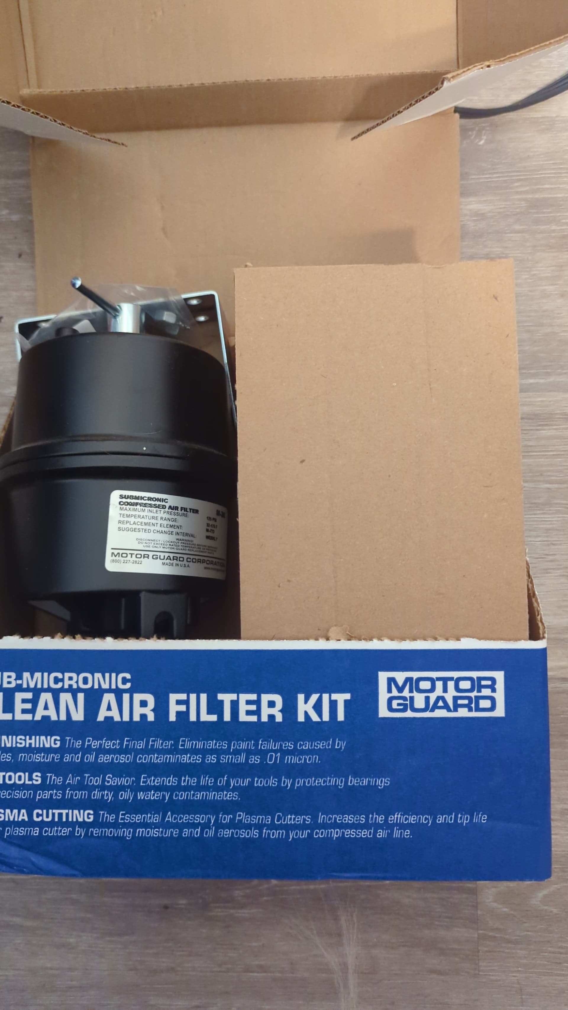

I had a milkshake. I’m just reading. I am ā€œDoingā€ Continuing Education for a certification and reading through things. I have a water filter still in the box and lots of people I consider Smart on here say DO NOT DO…. But I wanted a real explanation. I was listening to a podcast surfing the forums and doing CE’s and one of my podcast guys build is own AI engine so I tired it.
It’s going to be ok. Just continue to read, and tomorrow morning, order a Motorguard filter.
got one. I have been listening
Fwiw the danger in using plastic filter housings is the projectiles created if the bowl or fitting fails. Industrial air filter housings have a cage around them to prevent a failure from creating dangerous fragments. Put your plastic filters in an old Amazon box, you’ll be fine :wink::wink:
