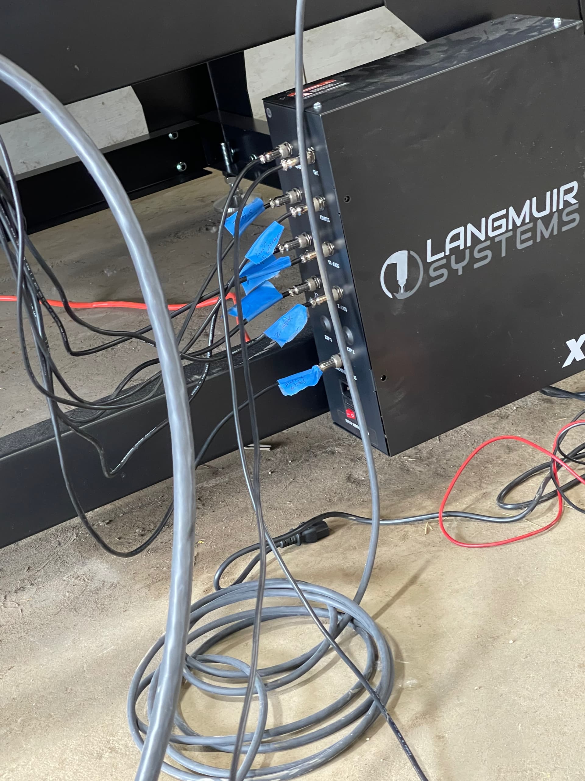

hey Jerry, i have a hypertherm 65 sync as well and got it to test cut fine manually but could not get the fire control to do a test on the THC. Also the torch will not manually fire anymore.any help would be great! or TinWhisperer? thank you in advance guys!

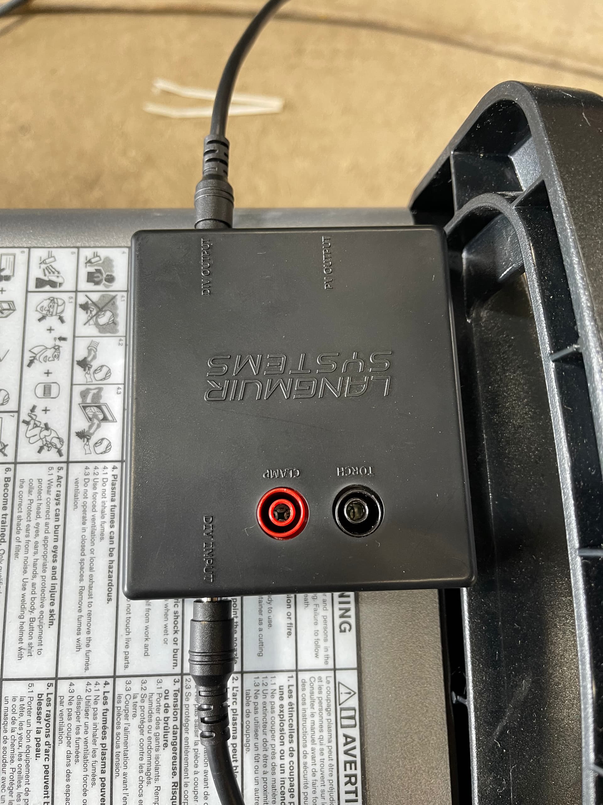

In the first picture what does “Torch on” mean?
It should be the divided voltage signal from your hypertherm going to DIV " divided input voltage" input on your VIM ( voltage input module)
And then from the DIV output on your VIMto your langmuir electronics enclosure.
Your torch on cable should go directly from the hypertherm to your Langmuir electronics enclosure.

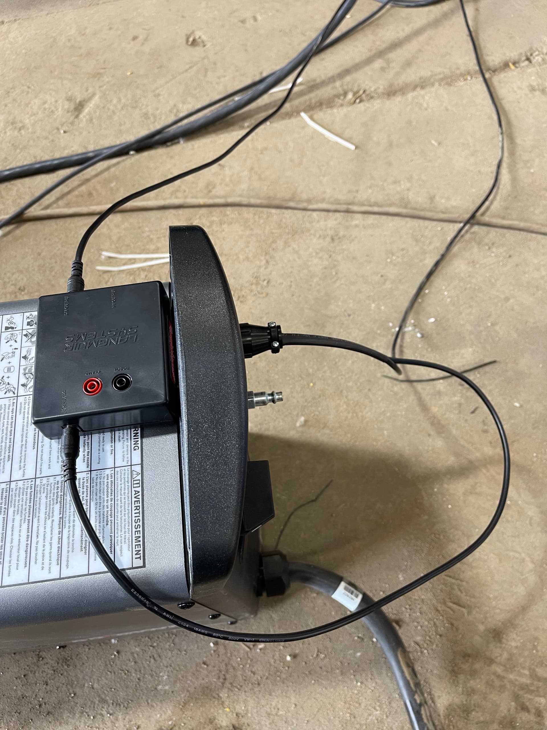

The picture 3of3does look correct though.
The lead coming from the “torch on/off” on the control box to the plasma
