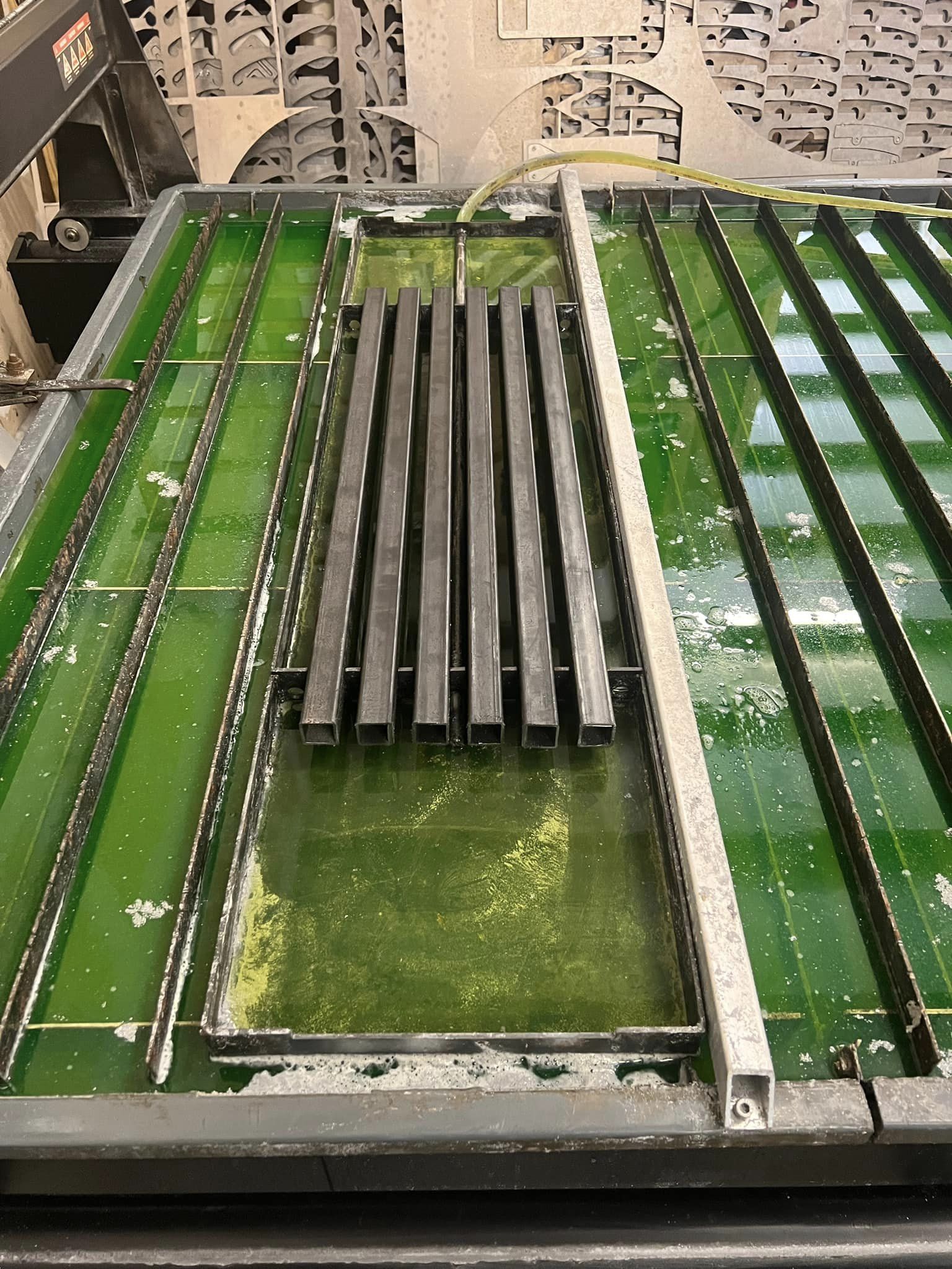

Some thoughts here on ganging tubes, lost track to who posted this image, it is an XR machine.

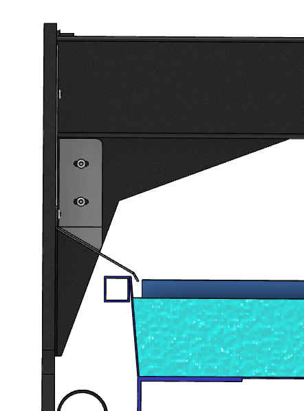

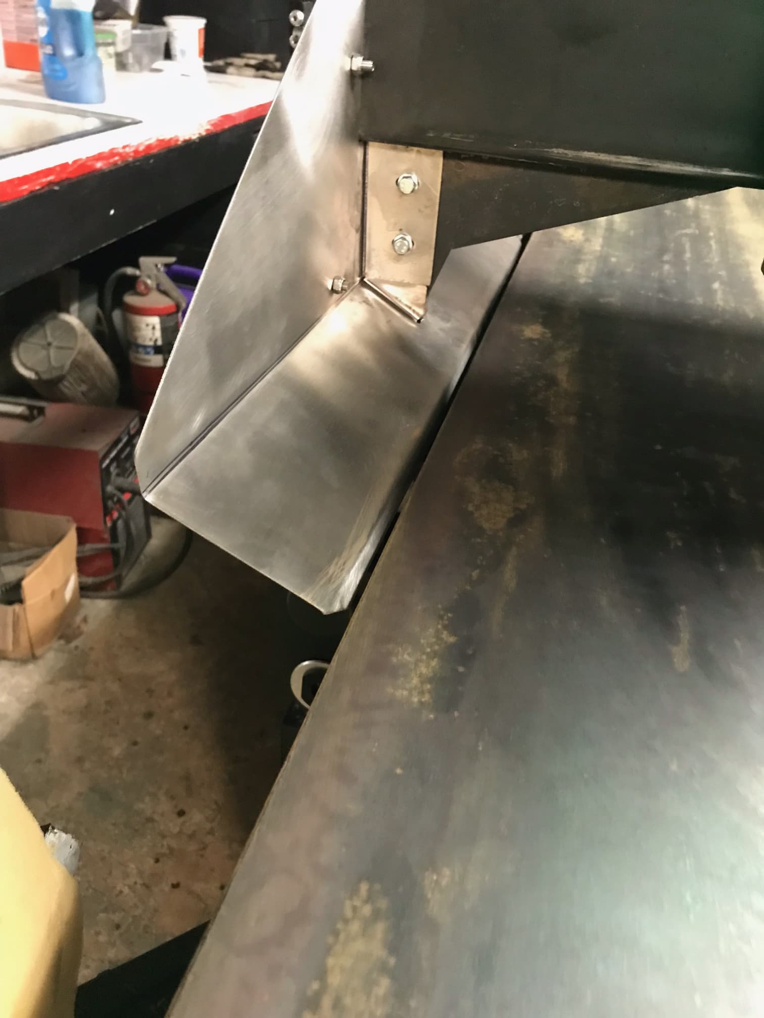

I like the splash guards, are they working well?

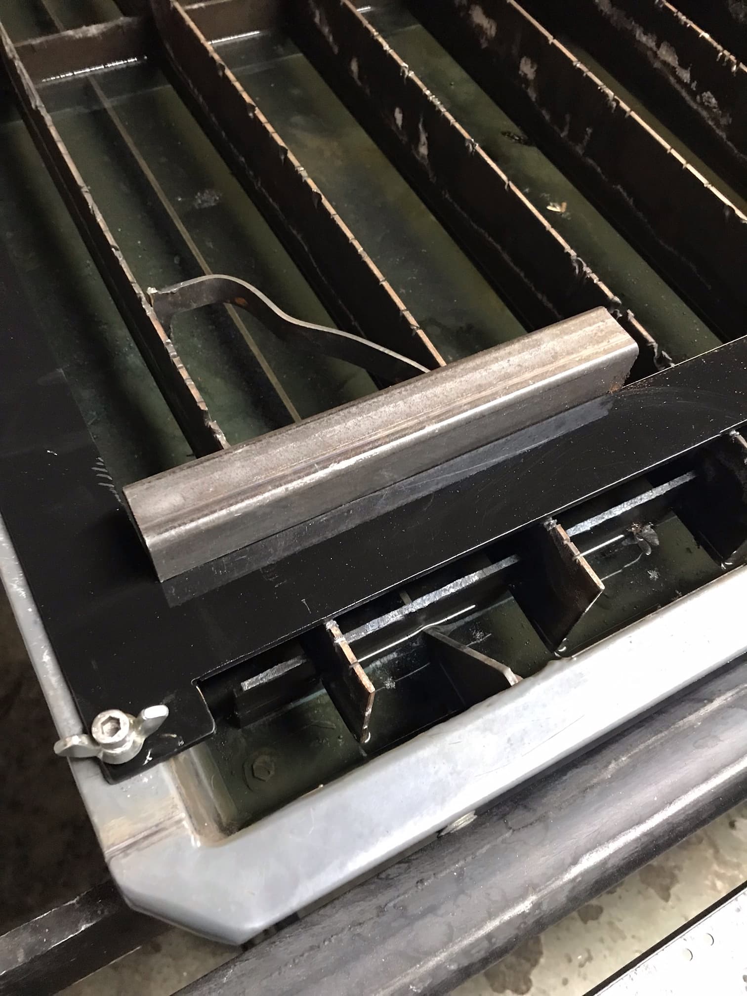

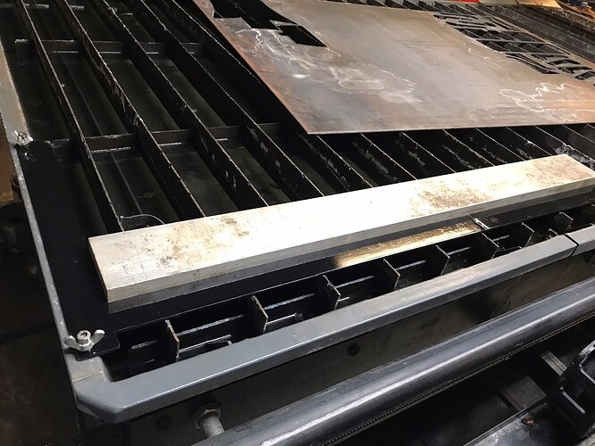

I bolted this 1 x 1 square steel tube to the table brackets. It allows me to quickly place metal either direction in a square or perpendicular fashion. I use a carpenter square against it for placement of metal along the x-axis. The torch kerf is still about an inch away from it at the extreme left position.
Yes so far the splash guard design looks good they looked like shit after hat 4x8 sheet was burnt but the floor was dry. A simple wash down with a spray bottle and paper towel cleaned them up except for the burn through my son did changing the soft limit to 48.5 in X axis to sever the 48.5" x10 ft x 1/4" sheet. We can pull it and weld it up but not a big issue. We typically just burn the 48" sever and use a cut off wheel for the edges. I can post a video of the splash and spark show at edges on the next sheet that gets burned, 4x8 10 ga. Ken

What’s the toggle for?
It goes to the laser lines on the torch. I don’t really use them too much since I put in the straight edge.
The lasers never remained fixed. I need to try the super glue trick but the straight edge gives me what I want right now.

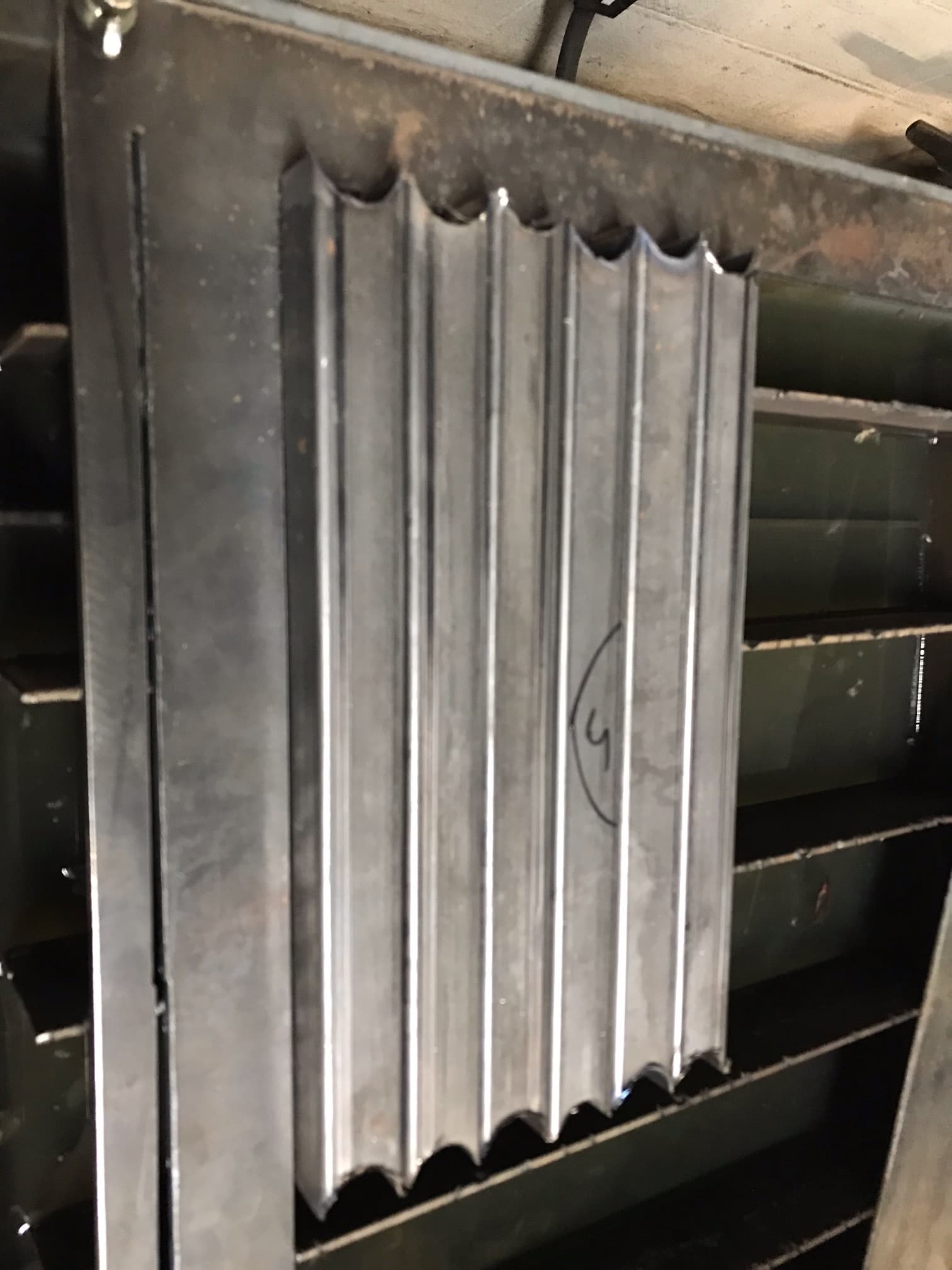

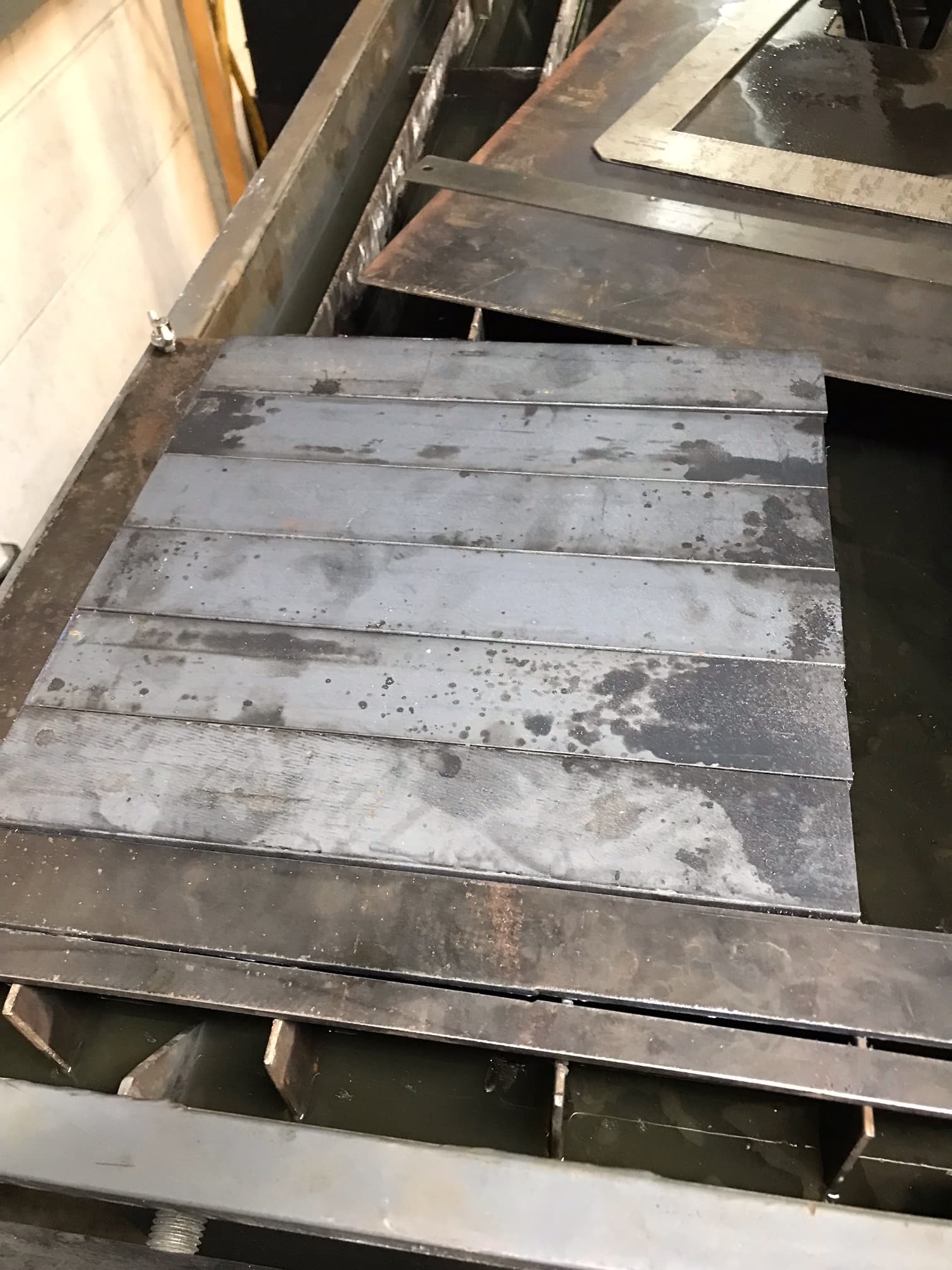

Back at this today . Some good results some learning on it as well. I see a lot of potential in this.We are more challenged since we are running our splash shields that don’t allow attaching to the Y axis water pan tubing. Had some issues cutting the long Y blade as the stock started warping . Pulled it back in and added a tab with a vertical blade that locks into the water tray rib so that long Y guide stays true. I have some thoughts if I do this again .
In the above 2 images you see the 2nd Y cut manually done in fire control,. away from the datum that was to try and warp the blade back it helped , really wanted it 2" but its good .
Corner Datum is 2" X 0" Y axis so for running holes and features in tubes or flat stock. No perimeter cuts only inside cuts with cad data with datum’s adjusted to Zero X and Y and move part 2" in sheetcam unless the part export plays fair and drops you in at 2" X and Zero Y. The m6 threads were tap drilled on the mill then aligned to ensure the machine would cut a margin out then the Jig clamped in place and tap drilled M6 followed by matched in place tapping so no slop in any holes although we still pull it on the long Y beam even 0 slop is some slop at 44" it seems. Now that the end of the Y guide is locked its solid . Should have that lock tab in 1st then cut the 90 live and learn in this life.
