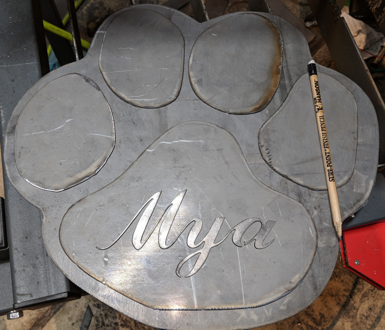

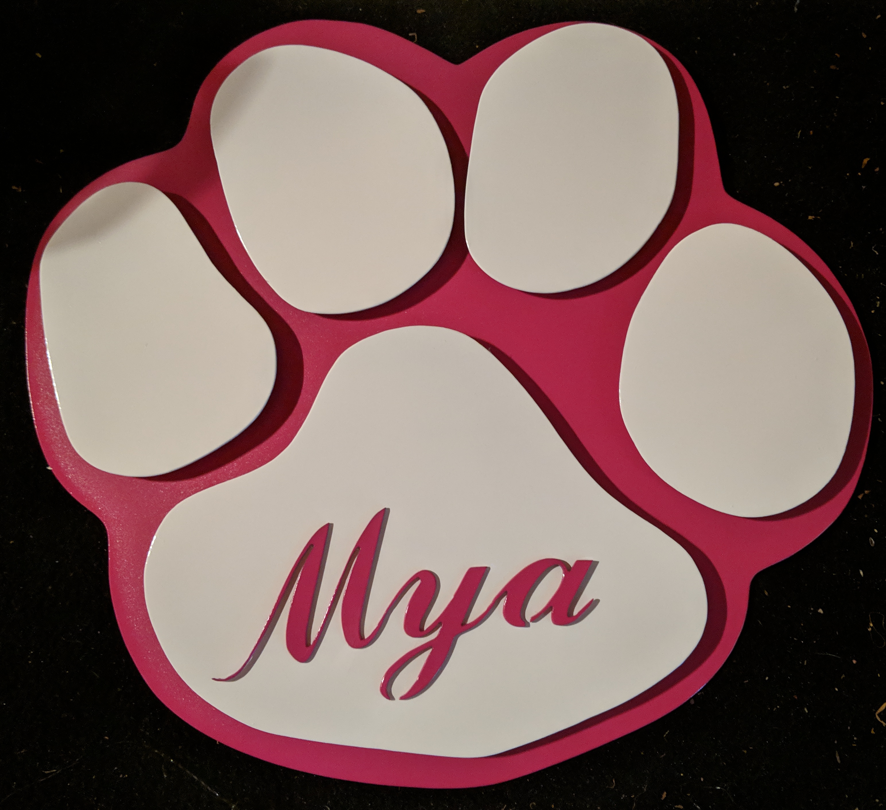

It’s not crazy or complicated but it was made to fit a little girls love of cats.

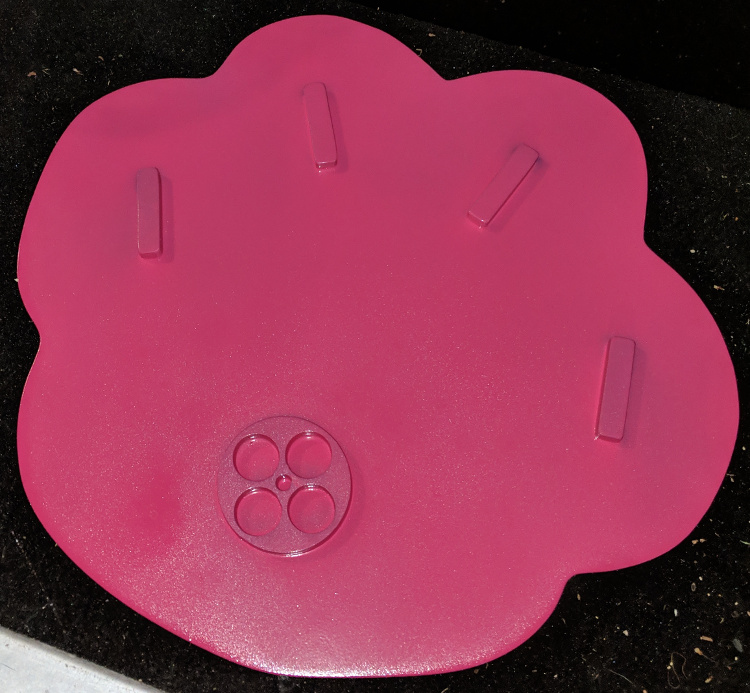

The background and foreground are 16ga steel. Spacers are 1/4" steel welded to the background. Foreground is bonded to spacers.
Powder coat was done in house.
Total size is about 15 x 13 inches

What did you use to bond the foreground to the spacers?
On this one I used Epoxy. For the next one I have ordered some weld on studs.
The lettering on the name is so fine that epoxy is the only good solution. Trying to mask things off and multi color powder coat is above my skill level. That means welding it all together is not an option.

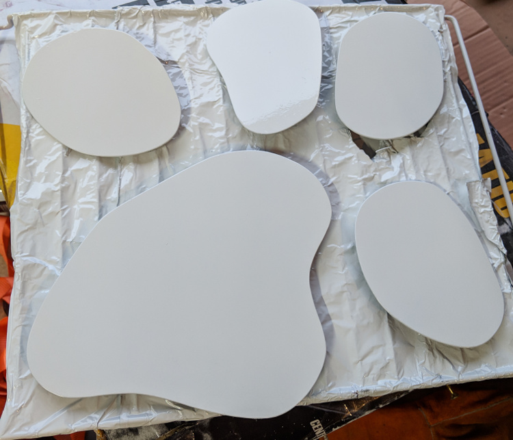

You can’t really weld after powder coating. and getting all the parts together before powder coat makes coating very difficult.
I’m wondering why that’s so. As long as you don’t have non-conductive portions that you want coated, wouldn’t it be just a matter of how large your oven is?
My oven has a 30x24x40 inch capacity - with something at an angle I can squeeze out a bit more room as well.
Another finishing alternative is acid coloring using something like the Steel F/X Patina solutions.
The sharp corners of the metal cause a corona effect in the static electric field. The powder coat doesn’t cover evenly in an environment like that. Paint would work, but in this case I was under a time constraint. I have a few more Ideas for some upcoming projects to share. Hopefully some might even workout ok.
Ah. The Faraday cage. There are ways of shooting the powder to get around that. There are also some polyester powders designed not to suffer the effect.
