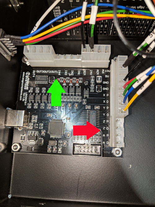

A good surprise when I looked under the hood
So I noticed this while I was assembling my Table and kept quite for awhile to see if anyone else did.
The Red arrow shows as Step and direction output for not only a Z axiz but an A axis (this is commonly referred to as a 4th axis. and used to drive a rotary spindle for round work)
The Green arrow shows 4 ins and 3 unused outs. (ins are normally used for limit switches but can have many uses, Outs can be setup for aux spindles, vacuums, exhaust fans, coolant pumps etc). Now this is just in normal CNC terms, I have no clue what Langmuir’s long term plans are for them. To be honest, I’m ok with not knowing for awhile. they are still getting the business started and issues ironed out. Once they get it running well, then they can let us know. I’m just impressed that they went ahead and included these items in the controller given the low cost of the unit.
nice spot! So, how much would we gain with a powered z axis? I don’t see much benefit myself other than not worrying about tip-ups. Somebody educate me
Being able to pierce at a height greater than what is used for cutting which will save on nozzles and also being able to keep a consistent cut height
Bonus as it does mean expansion was in the plan.
Or that it’s just a private-label stock CNC control board :wink:
good eye, however with their infinite gantry I wouldn’t want to add any more weight to it. i’d say a re design would be necessary. Its very young in LS startup but if it were me, id leave this platform as is. Very entry level and affordable. If I were them I’d redesign the system and offer the Z axis and a bigger cut area and just offer it as a more industrial option. I am however quickly seeing the benefits in a Z axis as I just had a tip up throw off my whole sign and I was at the very end of it!!!

If it is just a Private label CNC controller I’m still impressed that they went ahead and populated everything. The Extra parts are not free. I’ve seen other CNC units out there that use a “stock” board but leave all the unused components off. $0.05-$0.25 per board can add up, and profit is profit :wink:

not to get this thread side tracked. back to the original post, I do like the idea of using the internals on another setup if needed or be interesting to see what people on here come up with for THC.
I asked the same question in an email to tech support some time ago, and got no answer. I can’t imagine they would hesitate to answer if the answer was “no.”
It sure would be cool to be able to cut tubing on a rotary stage! Here’s to wishful thinking!
You only need 2 axis for a rotary tube notcher. You unroll the tube in cad and hook X or Y to a stepper rotary axis. Leave the other axis hooked to the cross fire and you could profile up to 25.5" long tubes.
Glad to see there may be a 3rd spot though! Would be great for bar feed through the rotary axis or ahc.
