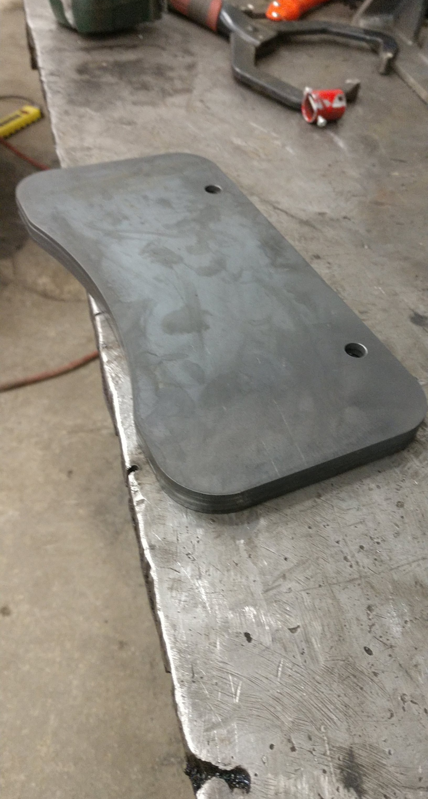

I farmed out the big plates to my local shop to cut. They cut them out of 3/8. Probably on the heavy side but the price wasn’t much different from 1/4. Was not very impressed with the cut quality, jagged cut from worn out gears and a pretty decent bevel. Torchmate table with a TD cutter.
I’m using a 50t air/hyd jack for the ram and it seems to be doing well. I made an I beam out of 1/2 x 5 plate and gusseted it up with parts off the Langmuir. I made some plates to hold the press assembly in the frame. They’re welded on the back side of the press, and on the front side I tapped a 3/8x16 hole into the 5x5 tube and have them bolted on so I can removed everything.

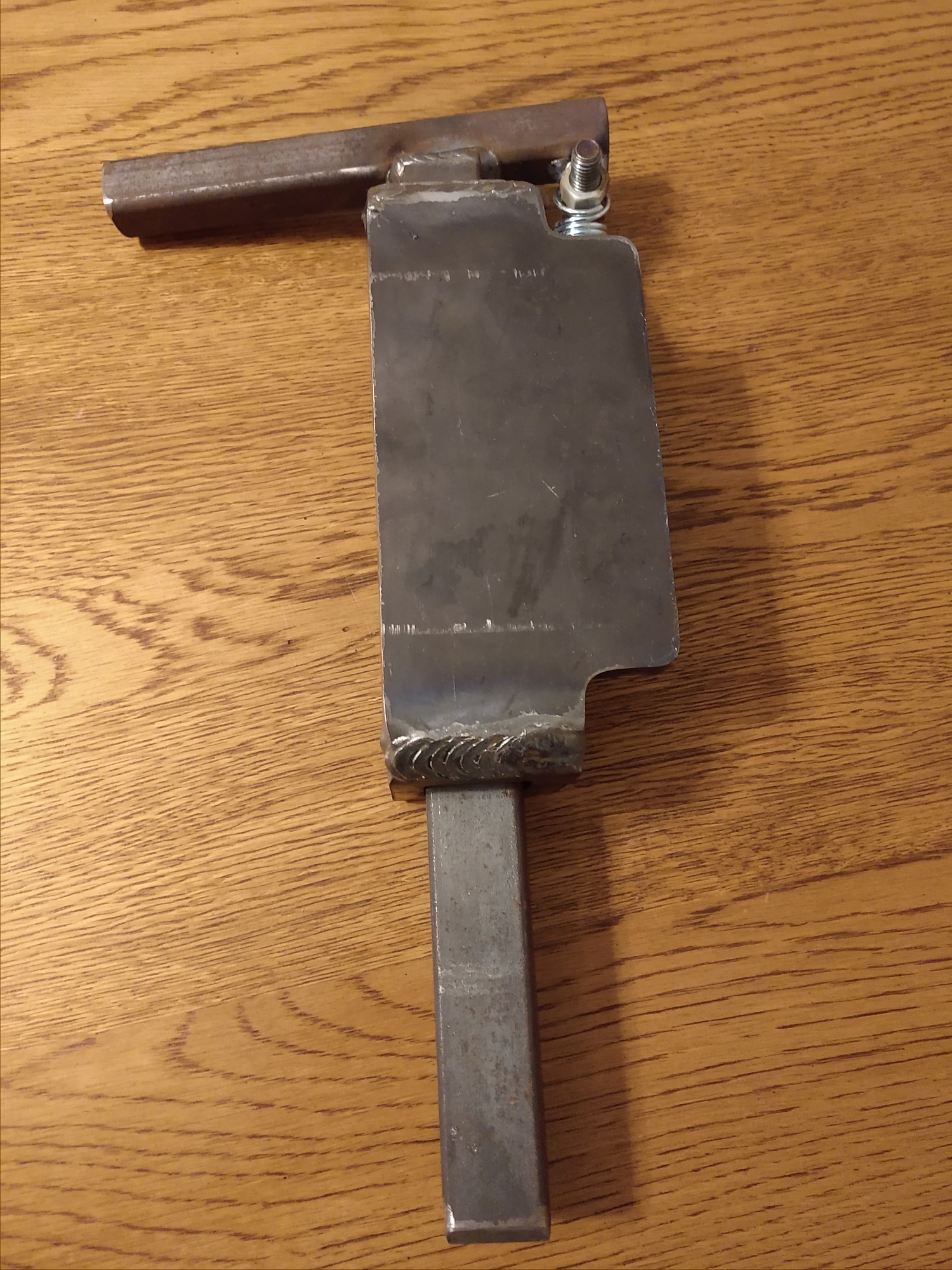

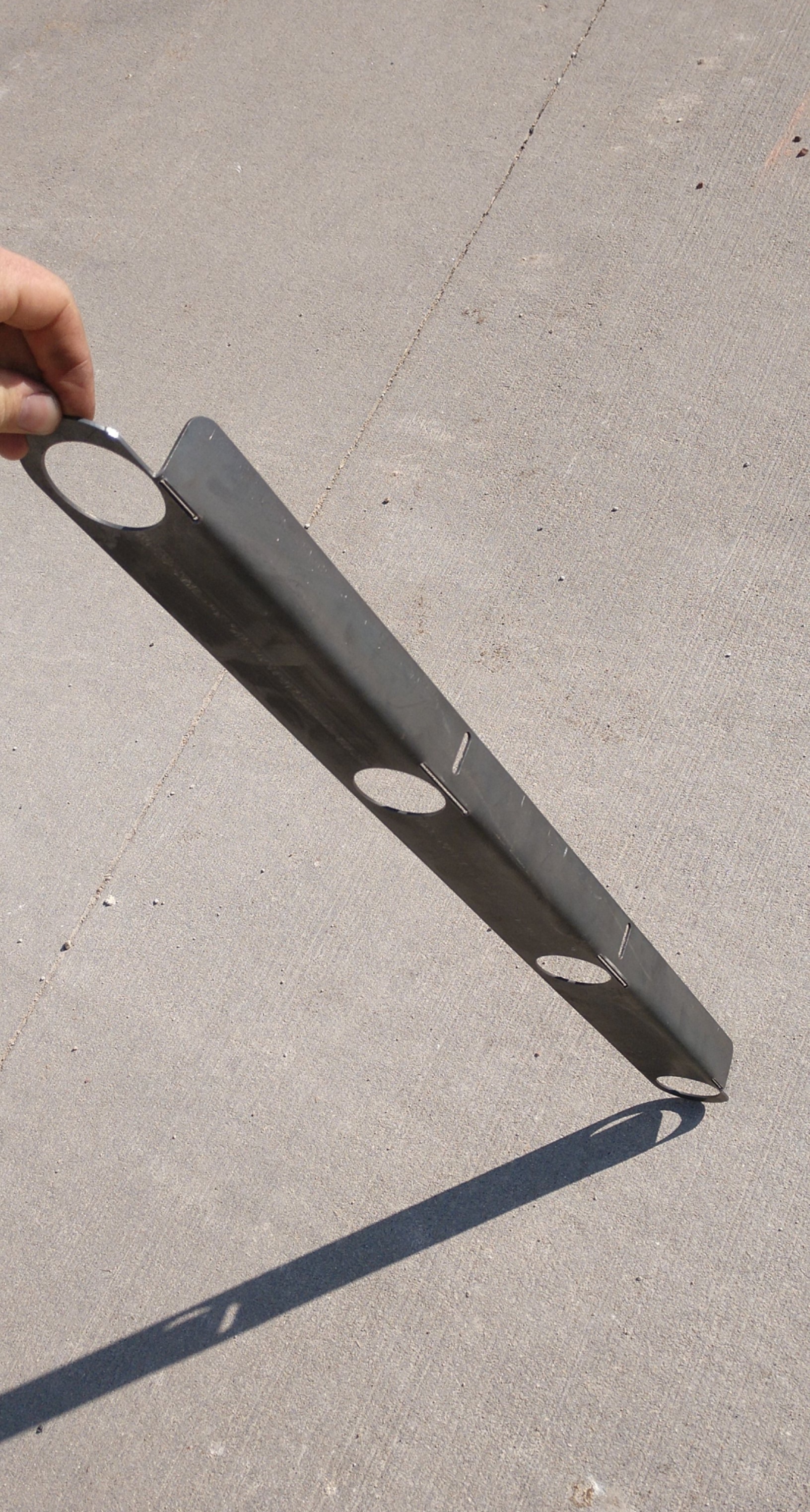

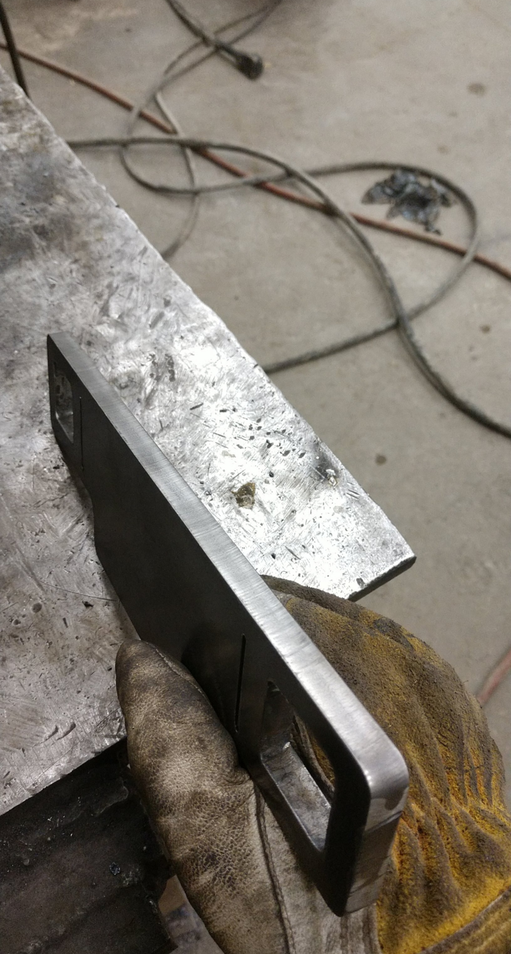

First part is one that I drew up on sheetmetal to use as a vertical support on the cattle gates I make. In the past I’ve just used pieces of tube cut and welded between each horizontal. This method is much faster.

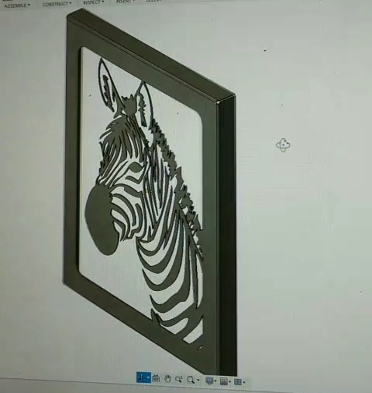

Fusion’s sheet metal functions are great and will unfold a design for you. That helps make sure I can bend what’s coming out - I can usually change it so I can bend and the longer section gets welded.

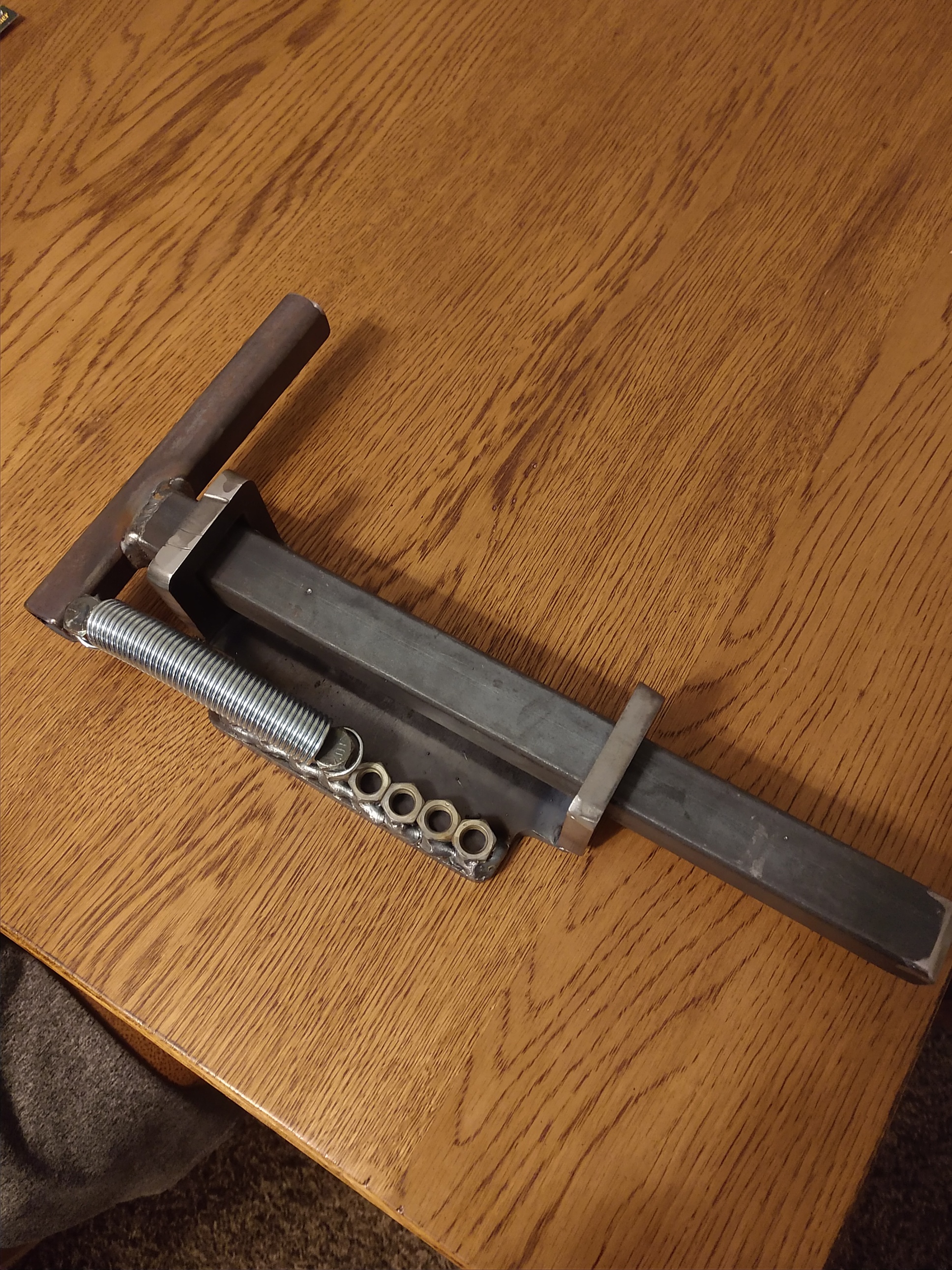

Thanks guys! Put it to work tonight on a couple little projects. First project was an idea I’ve had floating in my head since I order the plasma table. I make probably 10-15 gates a year for my feedlot and I make a lot of spring loaded slide latches. Usually it’s a piece of 3/8x4 plate with square tube welded to it with bar stock inside and nuts welded under for the spring adjustment. I drew this up on sheetmetal as a way to have less steel and labor. I had to do relief cuts next to the holes so that they didn’t get warped in the press, then I welded the backside of the cut after bending. Very happy with everything. Menards didn’t have the right springs and I’m not satisfied with these ones. Gonna have to shop around for a shorter spring. I cut these plates with 45a 15ipm with my RW45. Ignore the booger I had to take to the belt sander, my laptop ran out of battery and I had to start back up mid cut…

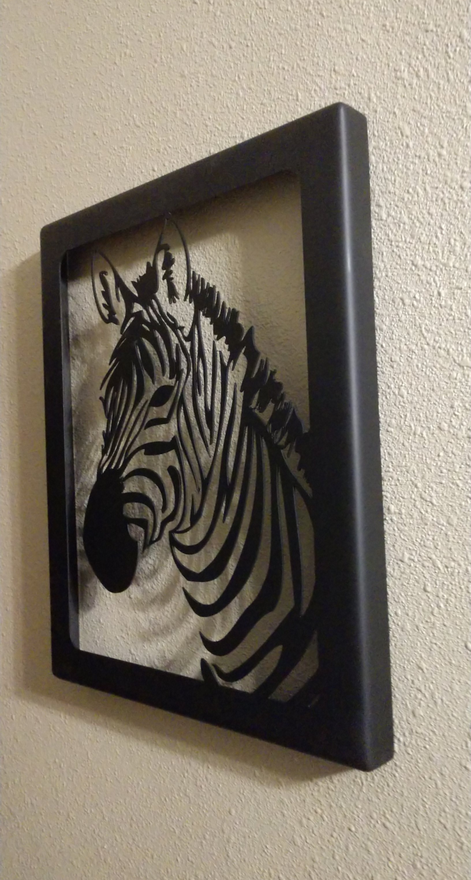

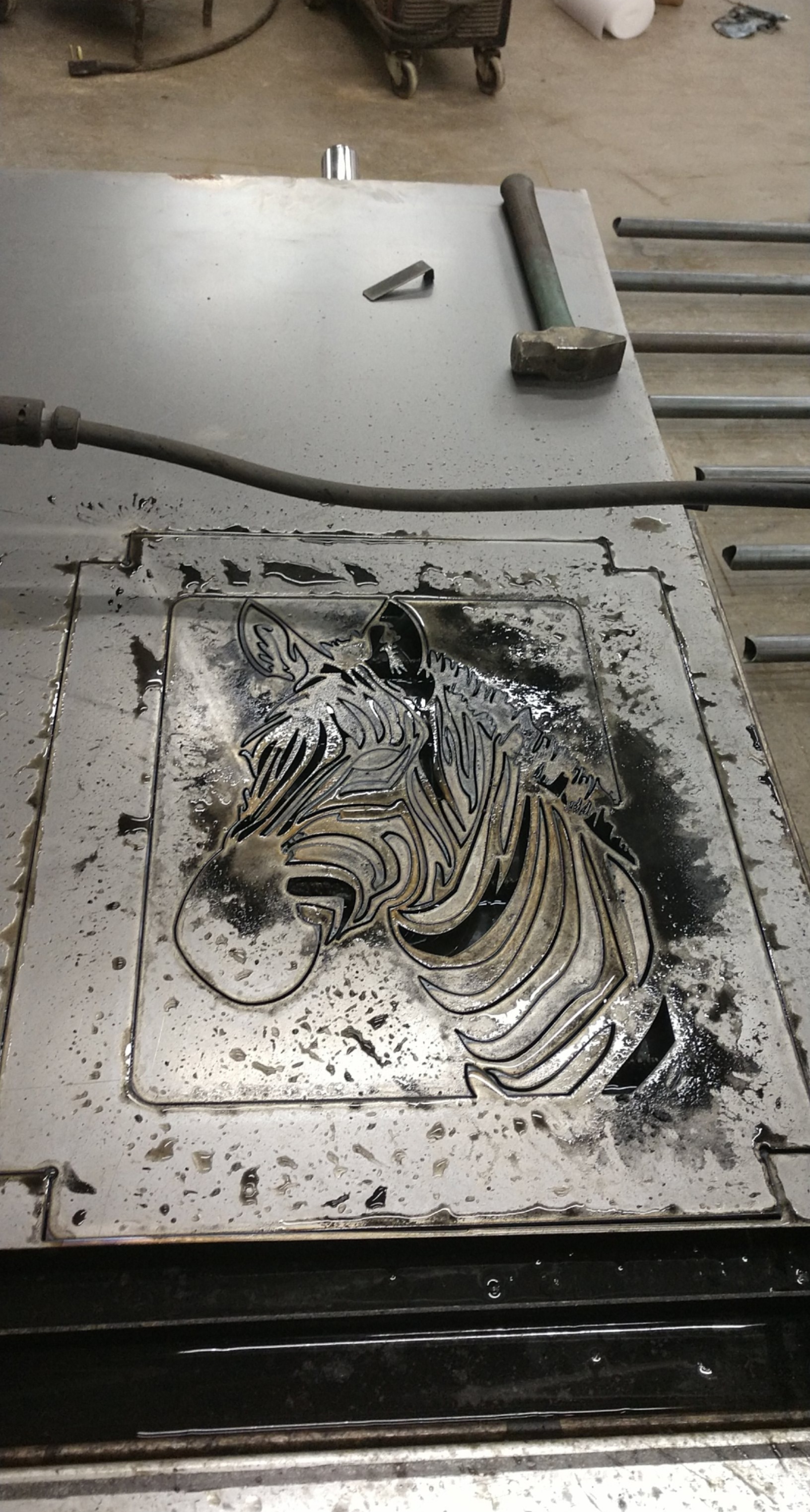

Next project was a zebra for our Safari themed baby room in progress. Found the picture somewhere on the interwebs and traced it. Fit it in to a 16*20 frame and made some flanges in sheetmetal. Cut it out of 14g CR and bent it in the finger brake. The seams didn’t fit quite as tight as I wanted, but pretty close for my first time. I welded them up and blended it out. Hit it with some flat black paint and it’s ready to go.
It really looks like it’s formed like that. Really happy, definitely going to have to do this on more projects.
The Zebra is very nice and an interesting idea to make the frame and the picture in one piece. Did you have any problems with warping as you cut this?
It seems with the long, narrow bands the metal would distort. What current and rate did you use?
I cut with 30a @ 80ipm and didn’t have any noticable warping, even with the small details. I didn’t pause it or optimize it to keep heat down either. Just topped off the water, threw it on there, leveled it up and let it rip. Didn’t have any tipups either. I had a couple spots where it burnt through the pass next to it on some real fine details, but nothing noticeable to the untrained eye.
Cool! Thanks! What gauge is that? 16?
14 gauge cold roll steel
