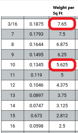

I am about to make a free standing sign for a friend. I will weld or bolt a vertical support to the back. Would you sugges 10 ga or 3/16 for the material? I feel like 10 ga will be enough. The sign is mostly solid. It is a cowboy on a bucking horse. Thanks for your input.

I am sure you already know this, but this is the weight per square foot.
I have worked with quite a bit of 10 gauge. Not much flex in 3 foot x 3 foot size, but 4 foot by 8 foot will really need some additional support. As with any sign, you don’t want your support structure to overwhelm your image.

I plan to put a rectangular base on it with holes to allow staking it to the ground. It will most likely be under his carport with his chuck wagon and wood burning stove. I am going to have a single vertical support in the middle to support it and not interfere too much with the design.
