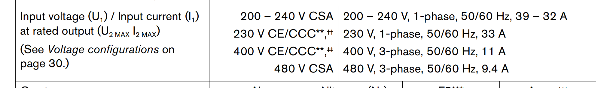

Most units will list a voltage range that is acceptable for the input voltage. The viper cut 30 manual I found was very vague. I’m wondering if it doesn’t like the 208v .EDIT* hypertherm inverter ones will run with 208 input voltage.

A lot of the newer inverter plasma cutters and welders do not like 208 volt.

I should have been more specific(or less wrong ,:upside_down_face:,); hypertherm inverter units can handle 208v easily.
And most units others that are brave enough to list it in their input voltage range specifications in their manual .

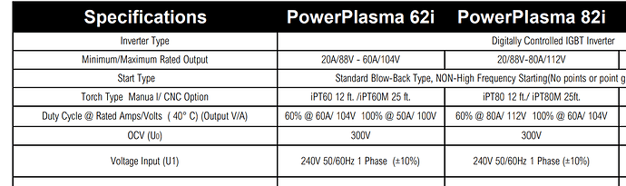

But it looks like Everlast units no likey 208
