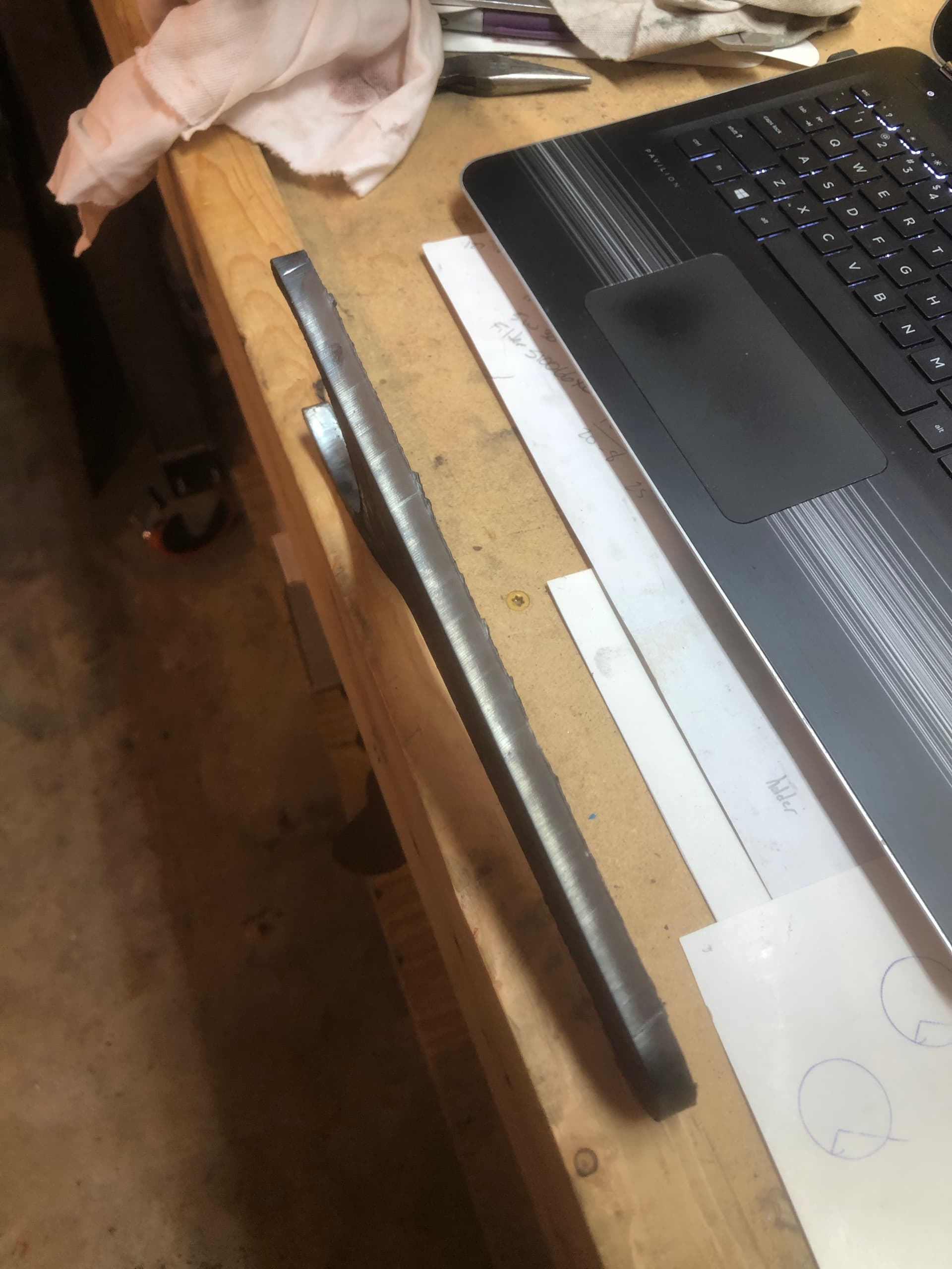

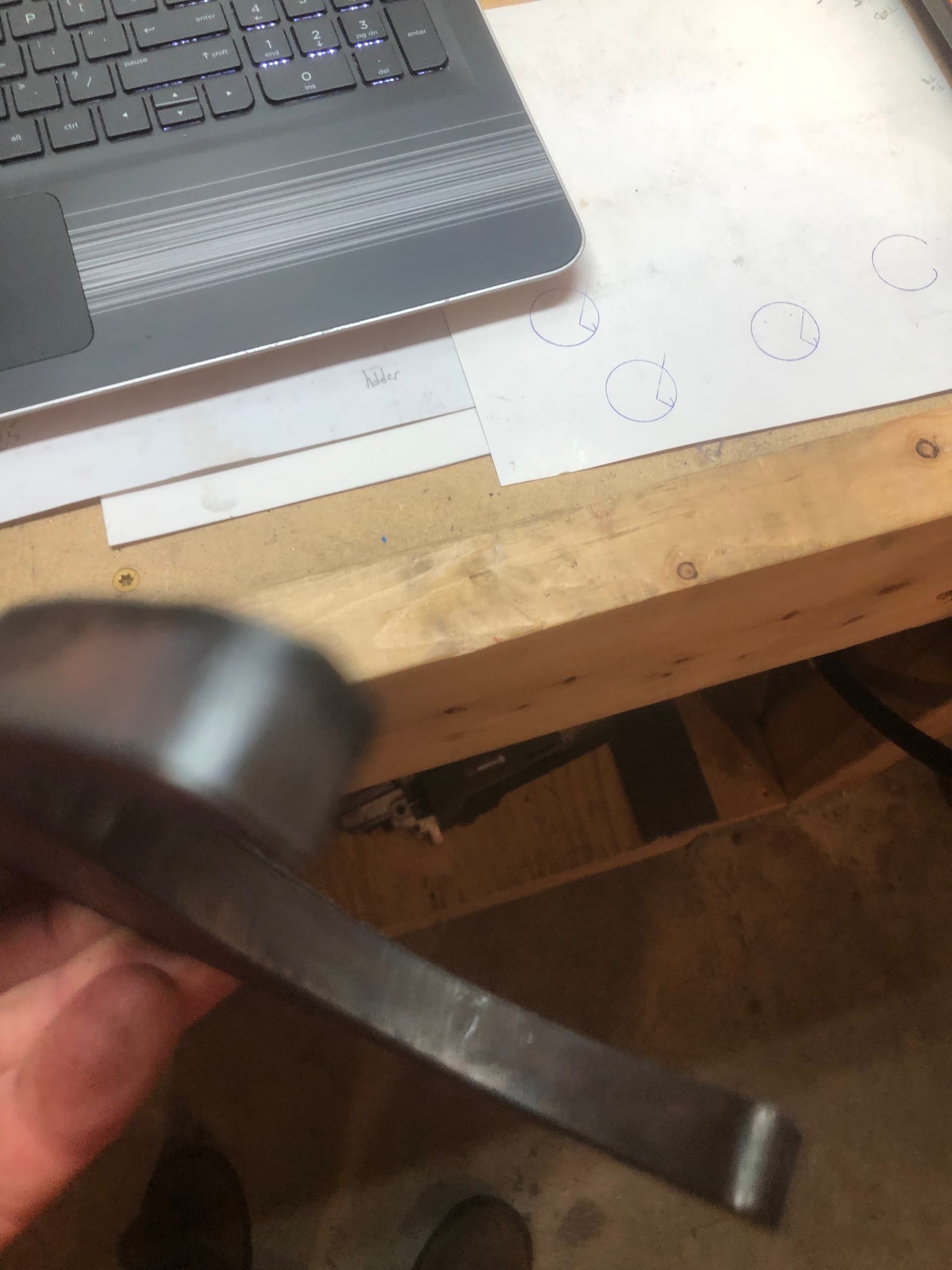

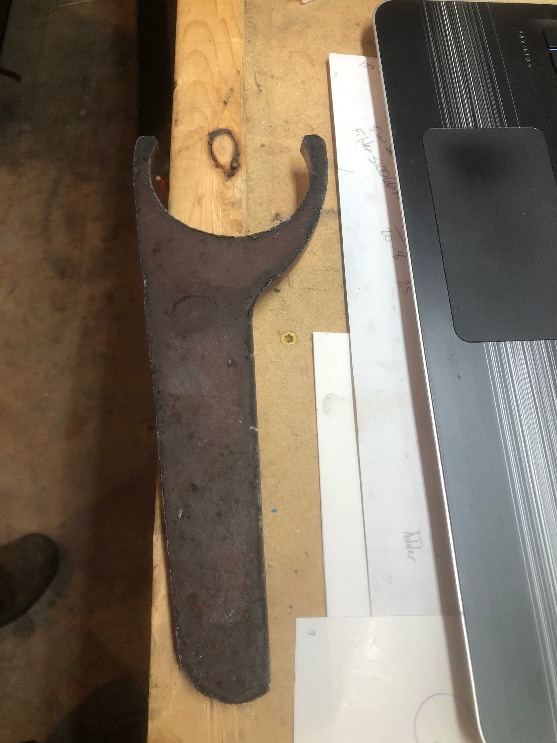

Well here’s the finished part. Thanks for all input, did a couple samples and adjusted as needed. Had some hanger kerf but came right off. In case you’re wondering what it’s for, it’s a spring hanger for a rear transverse spring on the rear axle of my hotrod
I remember the part from a few months back.
What settings did you end up using to achieve the cut in the picture?
feed rate 15 ipm
pierce delay 1.6
pierce height .16
cut height .06
It didn’t like the 1.8 or the .16 apparently as it stopped it right off the bat
actually it’s a different part but for the same project
