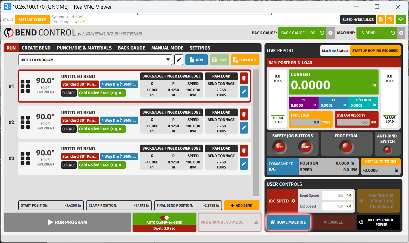

So, just an update on what I had hoped to be step 1. It would seem that the idea of an HDMI splitter with the Orange Pi and NanoKVM isn’t working out so great.
Since that didn’t pan out, I looked at taking an alternate route. It wasn’t terribly difficult get logged into Armbian on the Orange Pi and install the packages necessary to enable gnome-remote-desktop. With the latest OS image release, Langmuir used overlayfs to make the root partition read only with a tmpfs overlay for read/write. This is good for both the longevity of the SD card and to solve issues with unexpected poweroff corrupting the filesystem. In order to install packages, you need to either disable the overlay or use an overlay chroot tool to launch a shell with r/w access to the lower level root fs that is actually on the sd card. You’ll need to initialize a new gnome keychain and also need to set up and start the service from the startup script that is called upon autologin of the user that is running the bendcontrol UI. Lastly, you also need to set up persistent wifi settings for NetworkManger in order to have the machine connect on boot. Network connections get reset on powerdown with the new overlayfs read only setup.
I’m not planning on creating a how-to guide at this time, but figured I’d put it out there that its quite doable to set up for vnc or rdp remote access to bendcontrol.
So far, I’ve seen no resource impact to the press by having remote access enabled. Pursue this at your own risk. One good thing is that if anything gets messed up, you can reflash the microsd card and restore form your last backup (you did grab a backup and save it to USB before poking at this, right? :slight_smile: ).
