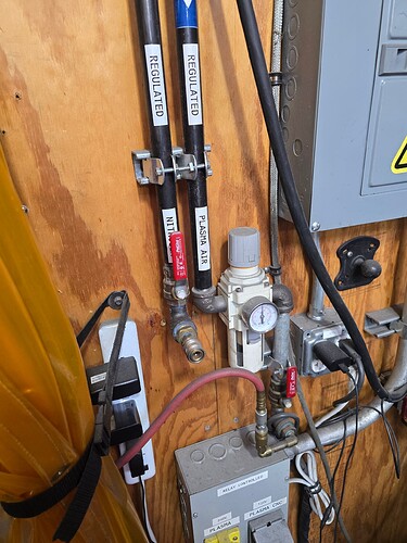

30 amps 88 ipm. All the other settings are the same as steel. That number is with my everlast 82i, So some adjustment may be required. For F5 gas, you will need to speed up a little due to the hydrogen in the gas mix.
Do you find that the cut height is similar to mild steel or is it decreased?
It’s the same as steel. Stainless cuts great; it just sugar the edges. If you have excessive dross, speed it up a little. The F5 gas will keep the edges somewhat clean. I use 2 or 3 3000 scf F5 bottles with a hydrogen regulator on a dedicated 1-inch black pipe run to the back of the plasma cutter. I use a quick connection to connect it.
