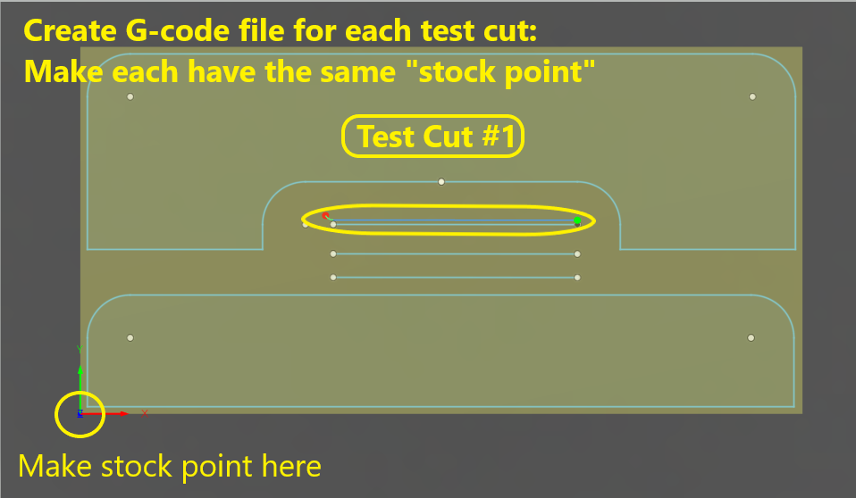

You will have room on the plate for test cuts if you plan it out appropriately. Whether using SheetCAM or Fusion, you would run several g-code routines: One for the “main event” and separate files for each test cut. You want to pick the same point for the “stock point” so the files are all using the same piece of metal and the machine makes each cut precisely where it avoids other cuts.

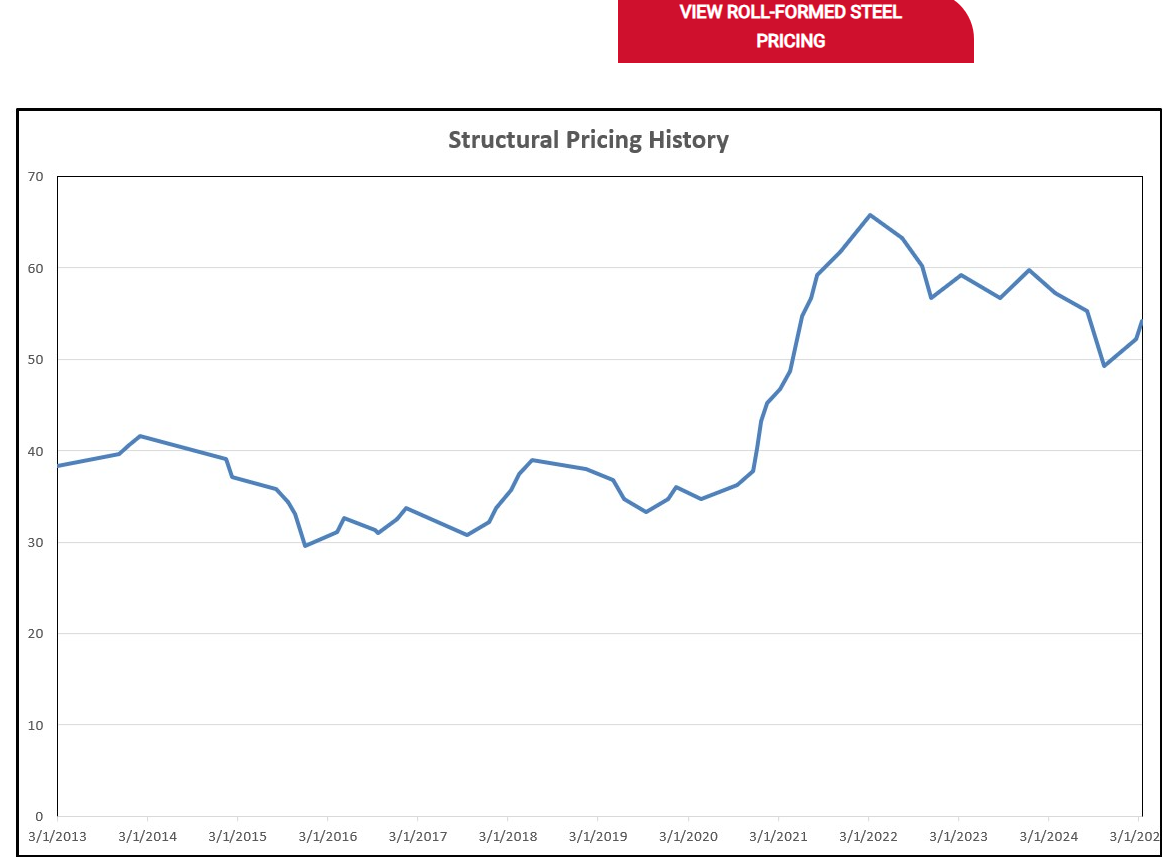

Here is a graph of steel pricing over the last 12 years or so. A supplier might be charging based on what it cost them or what they expect it will be to replace that sheet with current pricing. You never know. But you can bet they are not pricing it to lose money.
Current financial reports are suggesting that the suppliers have been shouldering some of the cost added with tariffs and this is expected to change. The odds are that prices will move upward so if you are planning projects in the next 3 months, get your metal orders in now.
BTW, I was able to get the parts cut. As suggested, I nested a few small squares in the space between parts, and set up test cuts using the same origin as would be used for the main parts cut program.
