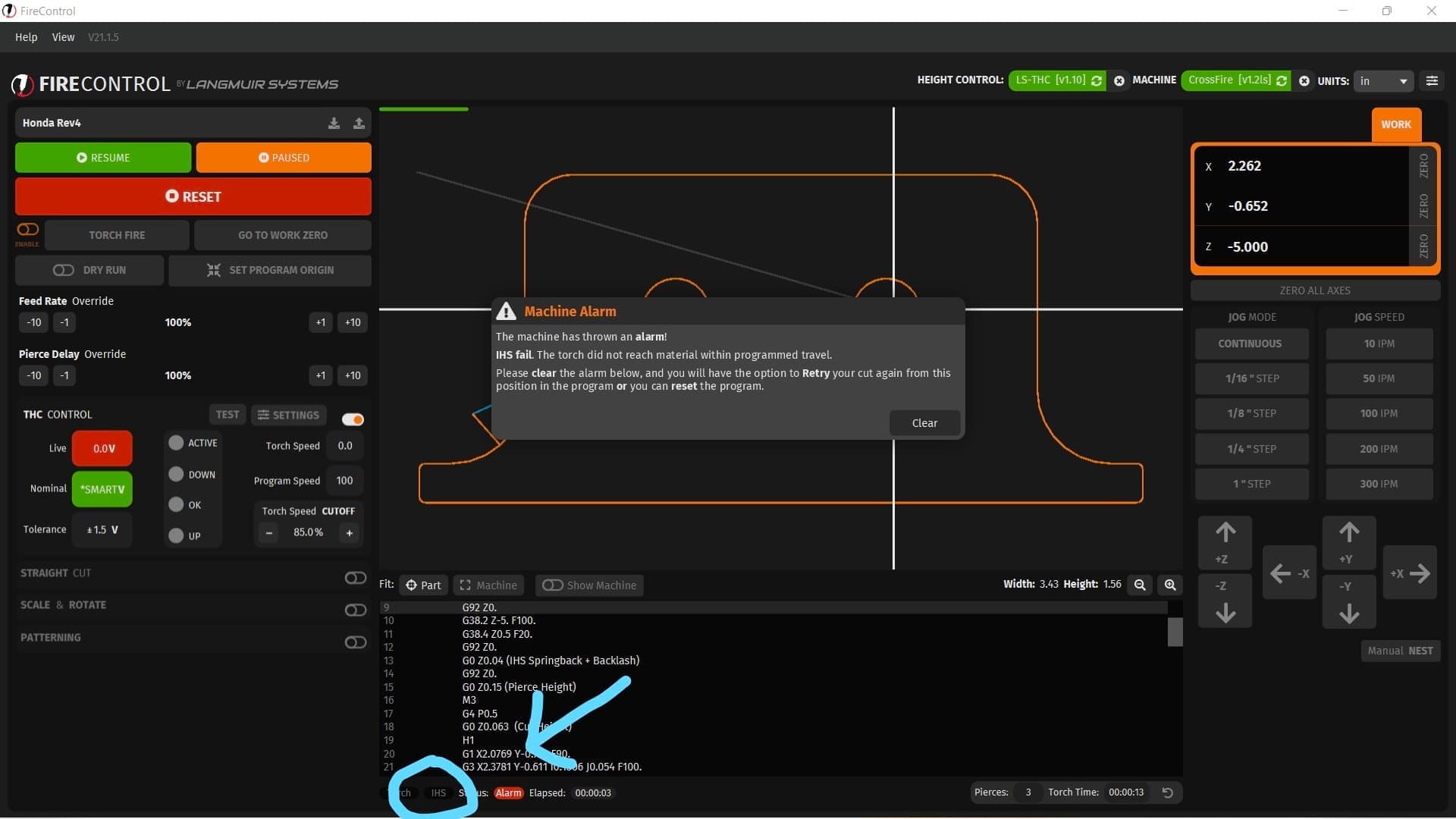

When you move the z axis up and down watch fire control screen makes sure the small ihs light comes on and goes off.
I would say IHS not THC is your issue. If you move the torch up and down manually there is a “light” on the bottom of the firecontrol screen that should change status when that IHS switch makes or breaks. My guess is your IHS switch is not signaling the control box that the material has been contacted.
This pic was stolen from another thread: Search IHS light firecontrol

When I am above the material the IHS light is off and when I jog as little as 1/16" onto the material the IHS light blinks green
When it touches the material the switch open turns the light on. Does the torch head move freely when you raise it by hand?

It should be steady green I believe. Make sure the switch is not loose. can activate it manually (with a small screwdriver) to test it out or as Phillip is saying by moving the z axis by hand.

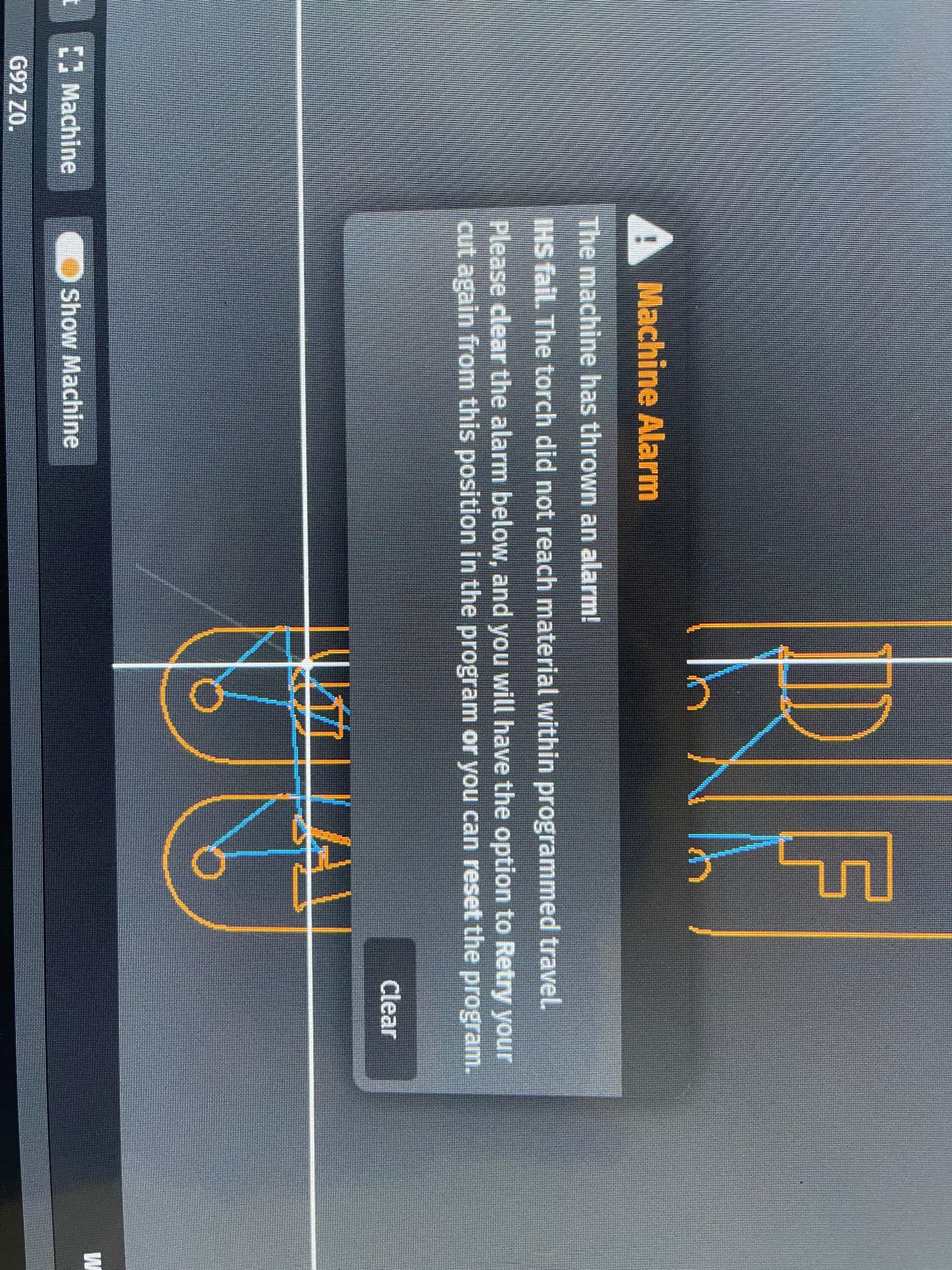

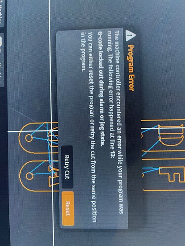

Here are my errors. I wonder if it’s thinking my material is much thicker than it really is. I’ll have to try and generate the nc file again. I am accustomed to generating designs in mm from 3D printing and everything in CAD/CNC seems to favor inches. I will see if that helps if there aren’t any other suggestions.
