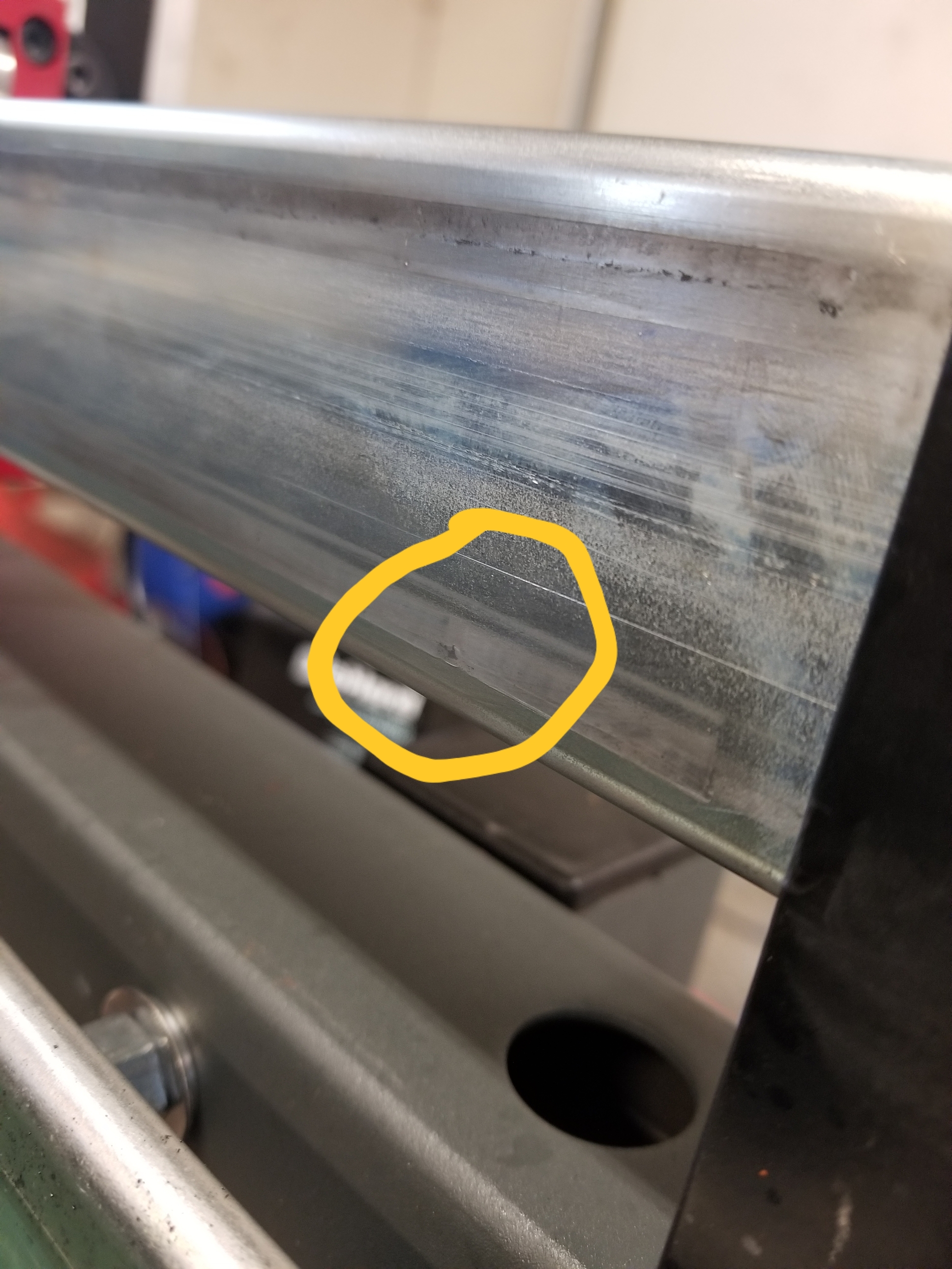

BTW Daniel - this is the little bump in the Y axis we talked about on the phone. Does not seem to cause an issue with the servo.
