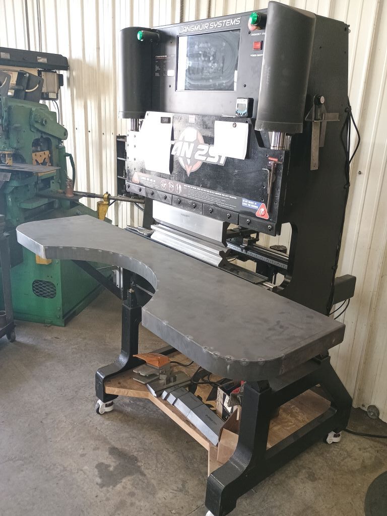

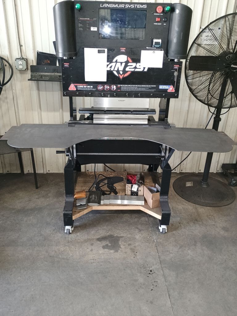

Work/Parts Table for the Titan 25T

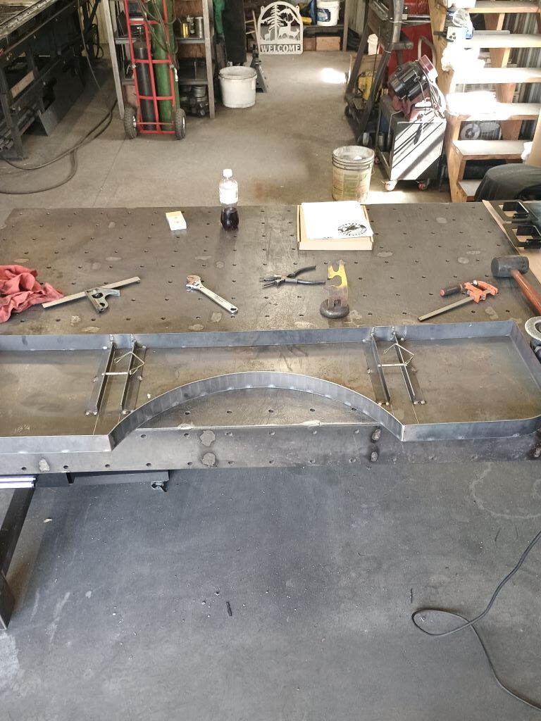

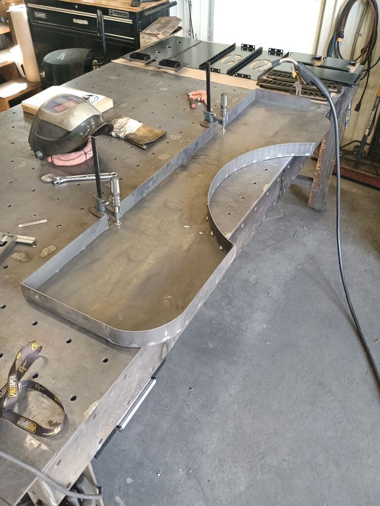

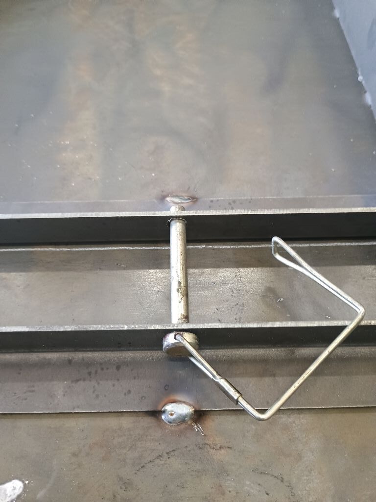

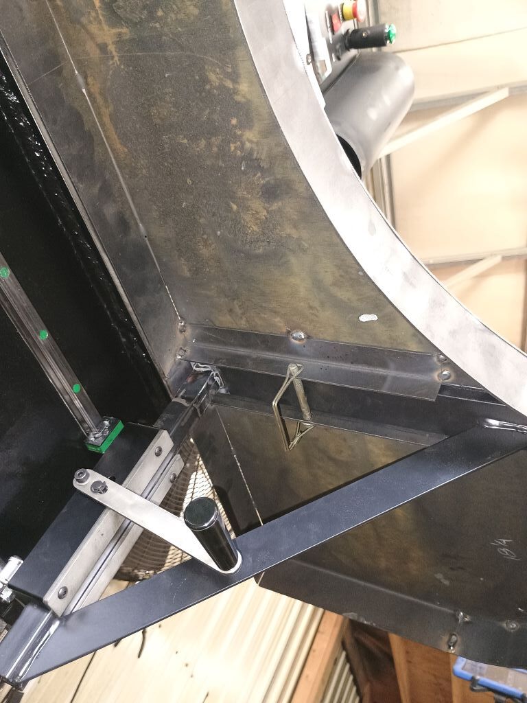

I do a lot of small parts, so I thought a table for the Brake would be a good idea. Using the support arms to mount it will allow me to adjust the height so I can make it flush with die when I need to support long pieces. It’s main purpose will be a workstation for small parts so I don’t have to bend over and pick them up out of a bucket or off a cart. Raw parts on the left, finished parts stacked on the right and I don’t have to move around. I used a simple set of brackets on the bottom with 5/16" pins to secure it, so it’s easy to remove if it ever gets in the way. Here’s some pics of the build…
