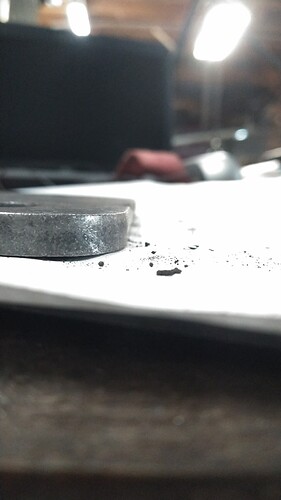

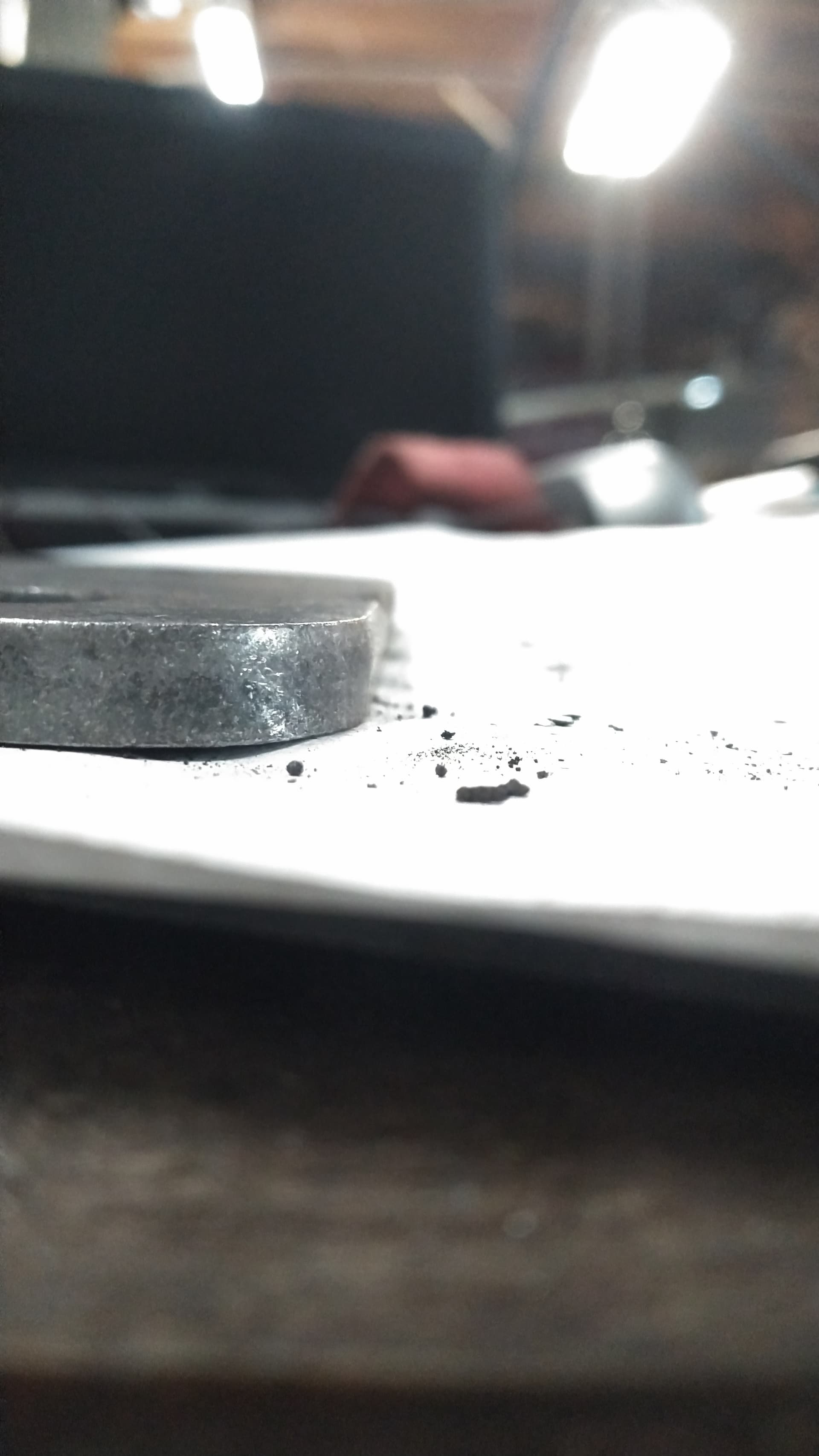

I was cutting some of the parts out of 1/4 inch. My washers I cut out I checked the first washer,the middle one and the last. The taper will not be consistent because the material warps to much. Picture will show what I mean.
So the first washer has 3 degrees taper on all sides, the middle and the last was the same each side a little different some sides was 3 a couple 5 and extreme 8 degrees. These parts will all function as normal with no issues.
I went through my stock of washers I am currently working with that was cut at 65 amps grabbed a hand full to check the taper they was for the most part consistent with the ones cut at 45 amps

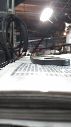

This is the first washer in a nest of only60.
This is a 65 amp cut with probably the most extreme taper.
Here is a full nest you can see how the taper can change constantly

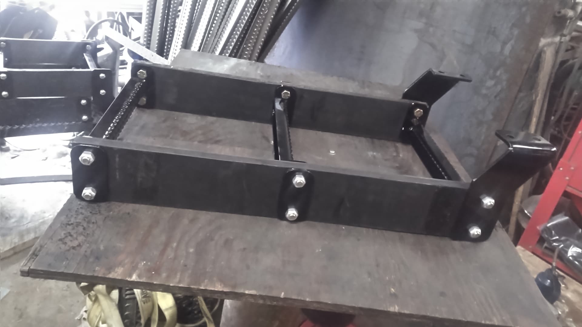

This is the finished product if anyone is interested

How do you order your parts? (it looks like you start center front and work your way out in an orderly fashion) I bet playing with the part order would make a noticeable difference in how much your plate warps. You won’t eliminate it, but I bet you could get it better than it looks in the one pic you posted. The risk of catching a tip up might increase, but jumping around on the sheet location will even out the heat.

For the function of the parts it isn’t worth changing the cut order. Was only showing the reason I thought the taper changes throughout the nest beside consumable wear. Sheet cam usually and on this one filled the first row x axis left to right. Then filled the columns out from right to left.

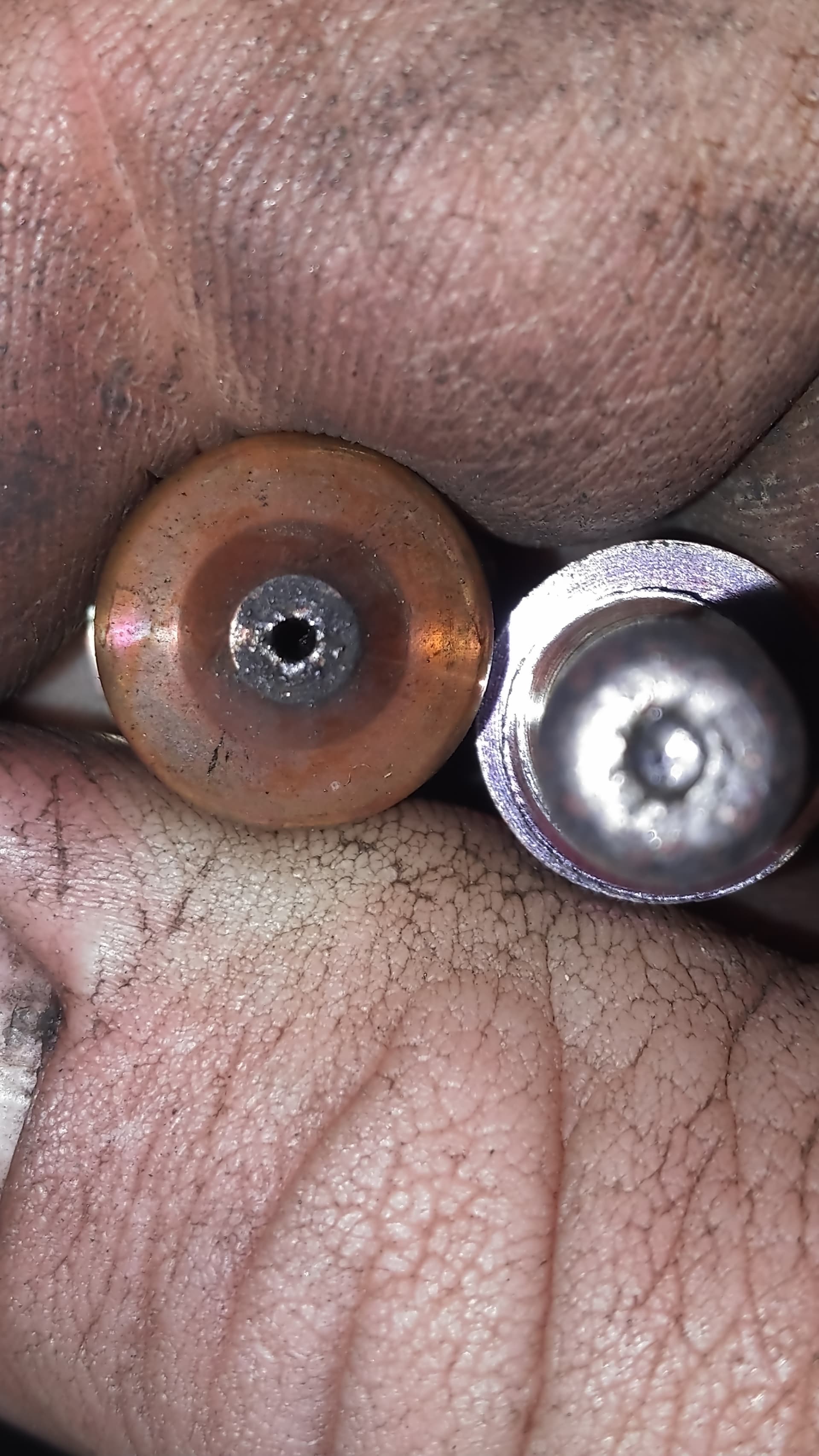

I normally do my long cuts with the copper plus electrodes and lately running at 65 amps.
Today I ran the standard hypertherm electrode and a 45 amp nozzle.
These consumables cut 433 washers and one square 24x24. There is 3 hours and one minute torch on arc time and 1300 pierces.
They are well used and earned my respect. I never try to run them til they blow.
