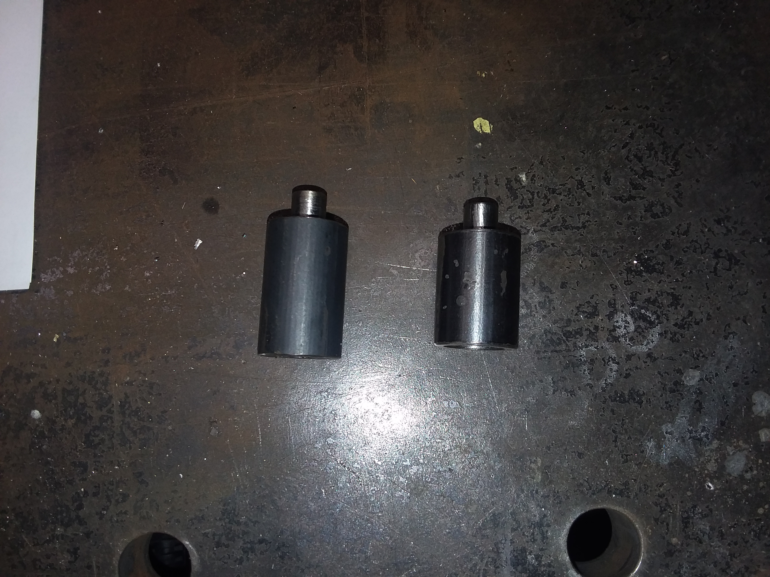

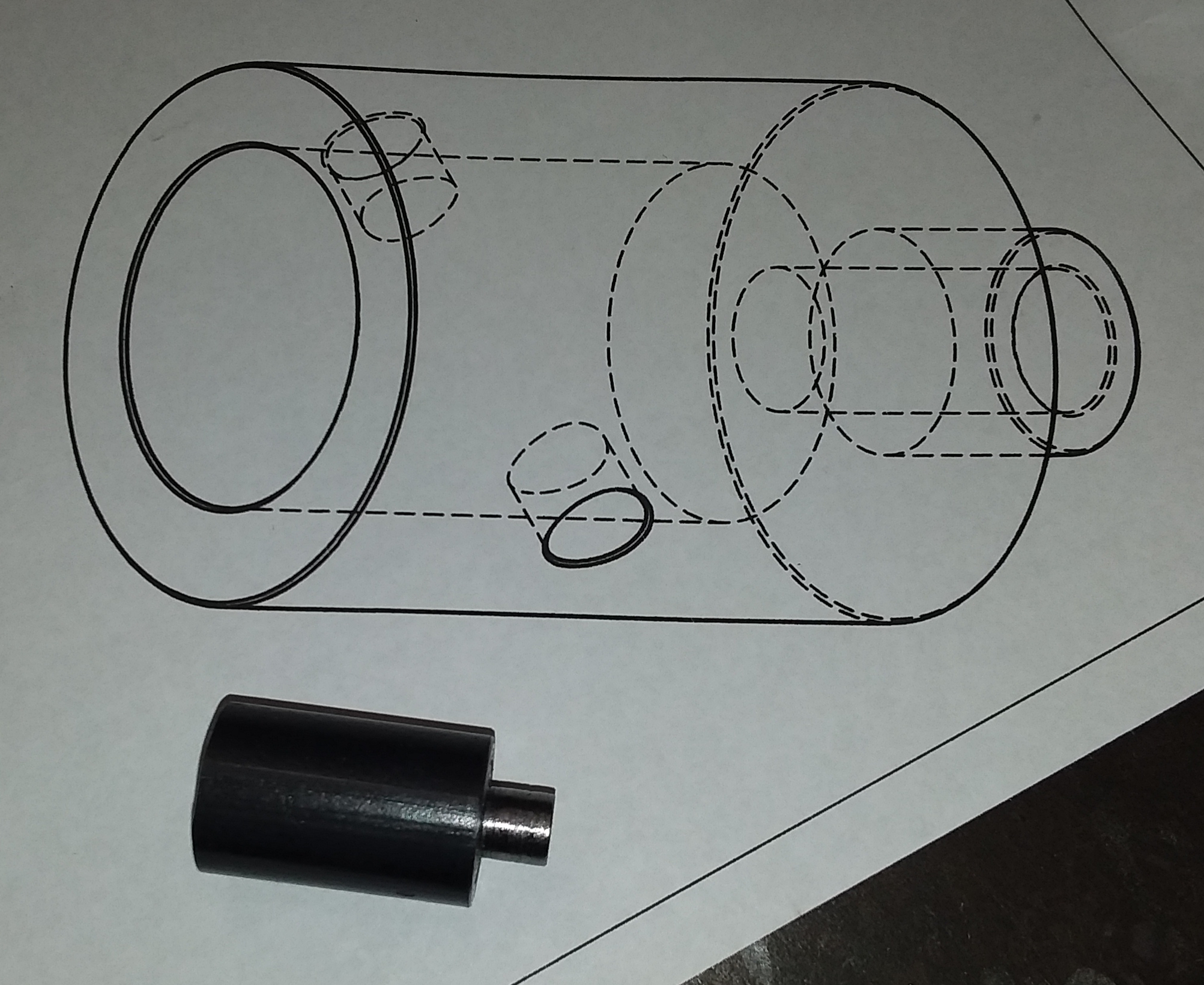

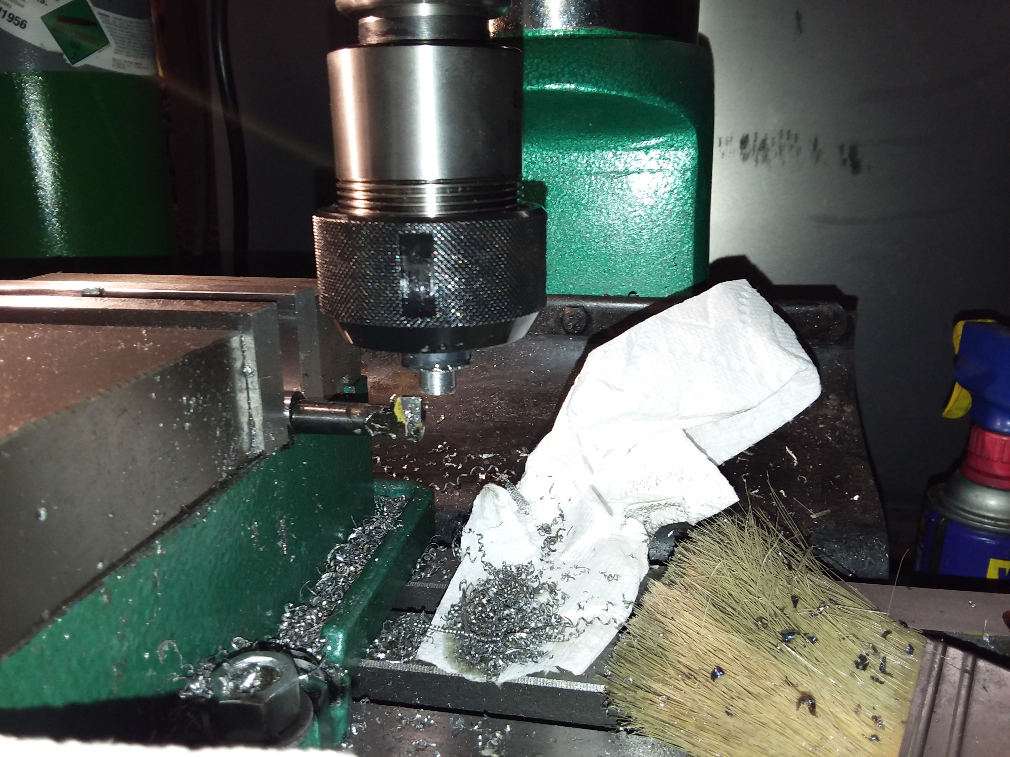

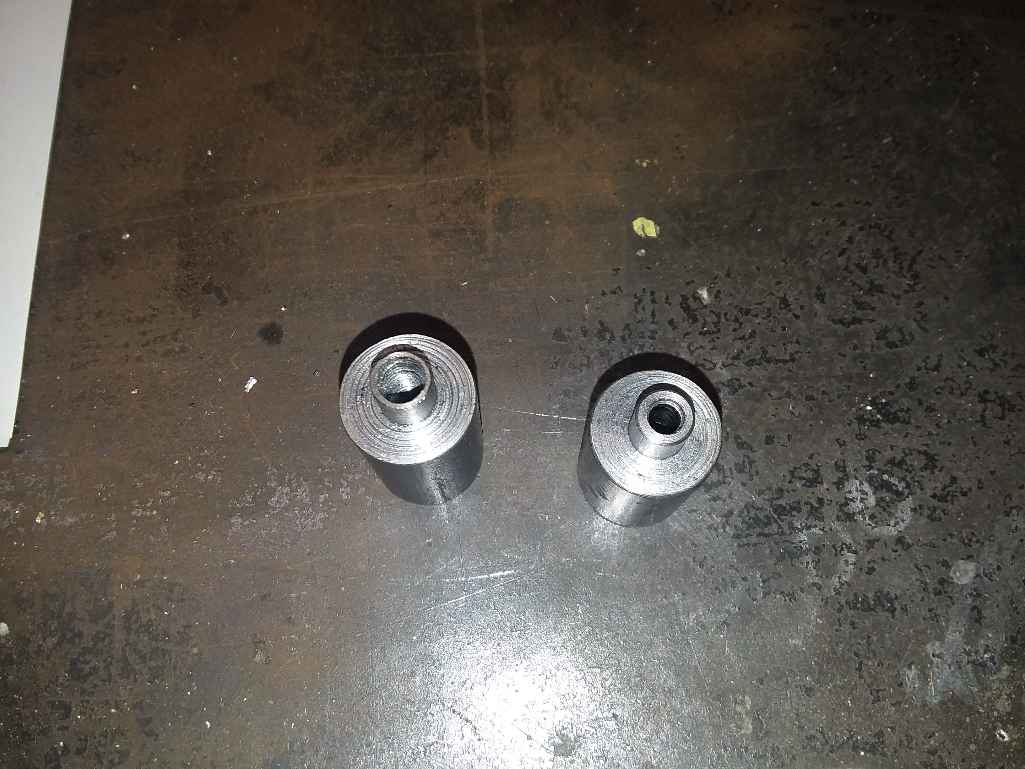

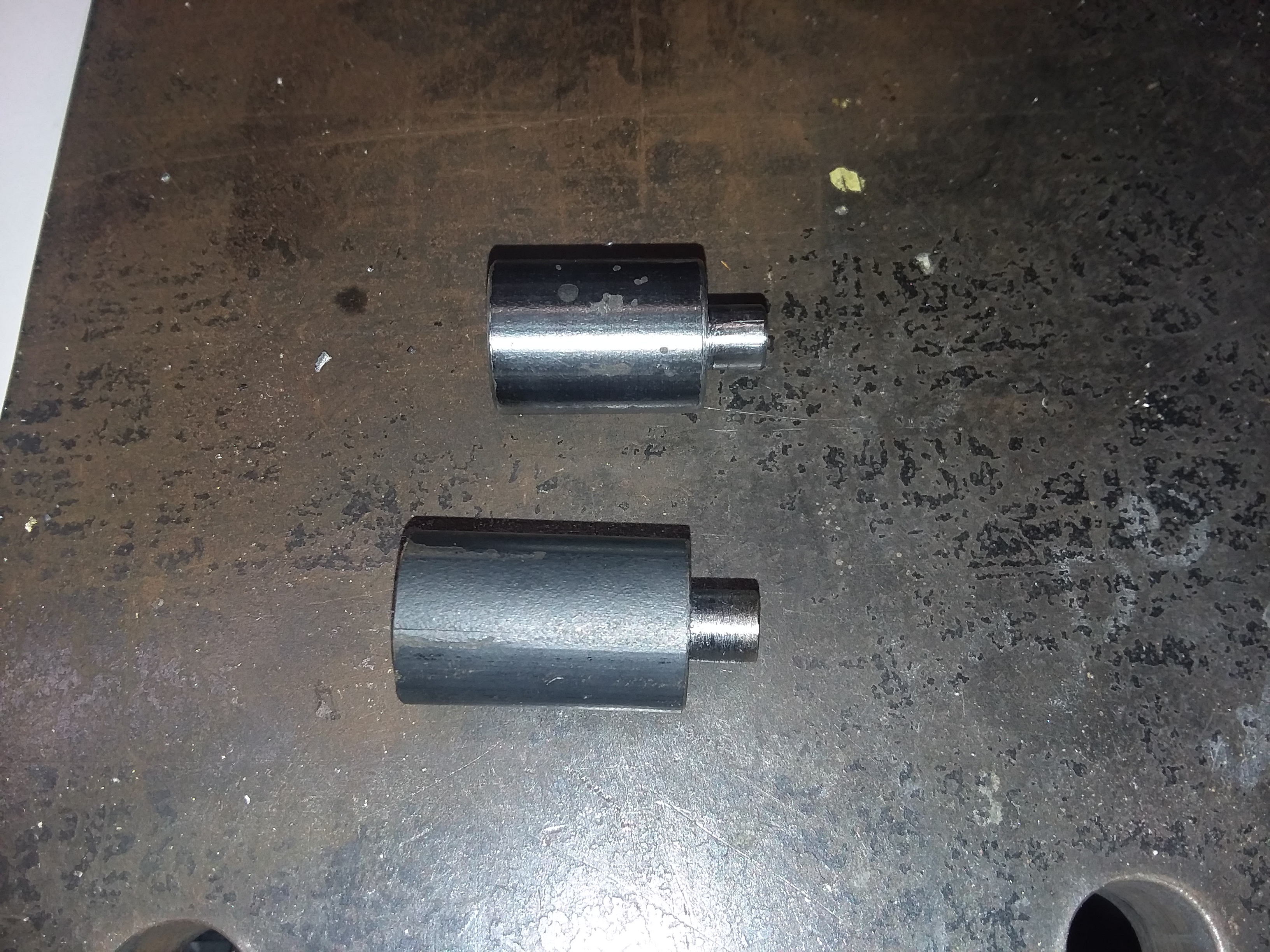

The problem I had with sourcing the part for my build is most companies have a minimum charge for a one off part. I took a shot at making my adaper on a mill. Didn’t turn out too bad.
The issues I had was drilling a straight hole thru the part and the material not being thick enough. I tried to make it out of 3/4" material but it didn’t leave enough material to drill and tap for set screws. My order of operations need to be refined. I was getting a lot of wondering when drilling a hole thru the part. Could be I was trying to drill a hole about 7 times deeper then the diameter of the bit in a not so rigid setup. A lathe would make this so much easier. I also wanted to use a 1/4-20 cap screw instead of the 10-32 cap screw to hold the adapter to the bearing but that was also too big for the part. Haven’t had time to get back out there and try to make another part.
I’m thinking the easiest option would be to turn down the 1/2" leadscrew to fit the existing adapter. I have a few ideas on how to accomplish this without a lathe and might give that a try before making another adapter.
First two attemps.
