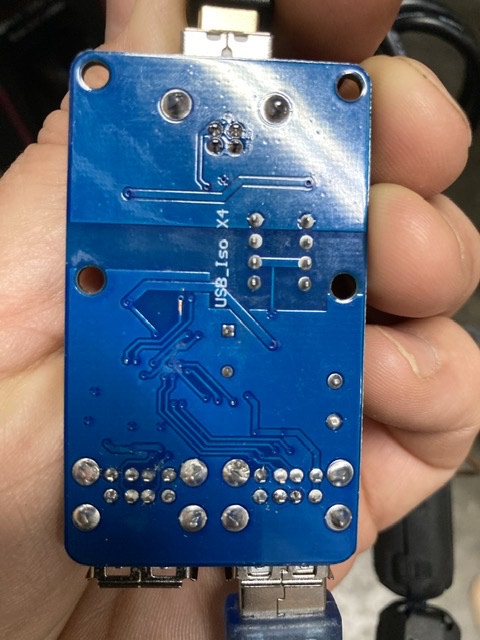

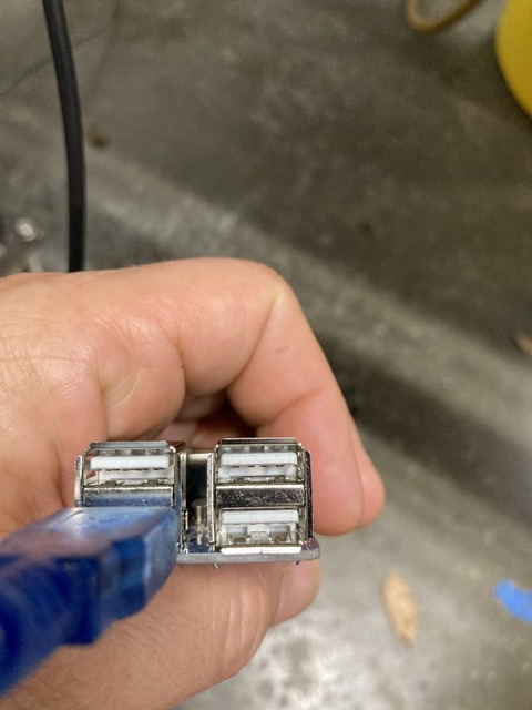

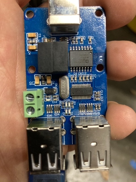

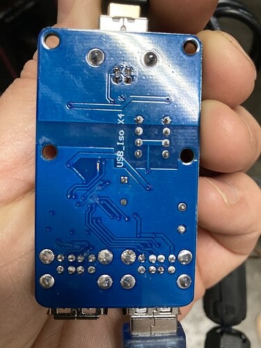

Langmuir sent me one free just before they cracked the case on the soldering fix. It came in a plain brown wrapper (actually bubble wrap and box). I know nothing about it, so here are some images. The remaining side is just a single USB type B female where your cable goes. Hope it helps.
a picture is worth a thousand words…
Thanks
A higher resolution photo showing the chip part numbers would give us a clue. That looks like an isolated hub given the 1:4 port relationship. I wonder how they tap off 5V to power the controller like they did in CF original. Those big black boxes might be EMC filter chokes so it’s RF isolated, but not DC isolated.
On my phone it looks identical and the ADUM 3160 is on there. I’m not at the machine anymore, so that’s the best I can do right now. I can try to make a better image and will post in case anyone still needs it.
