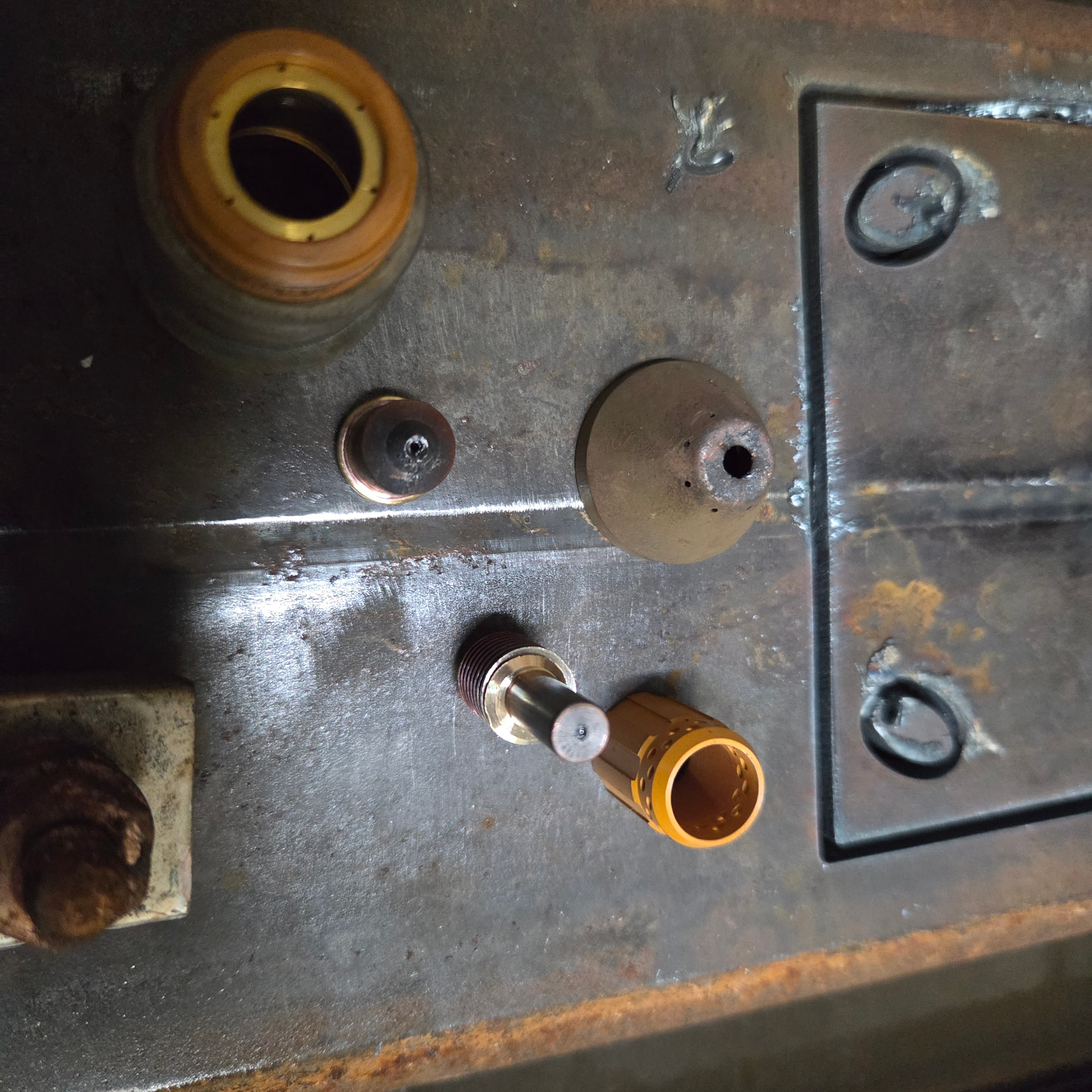

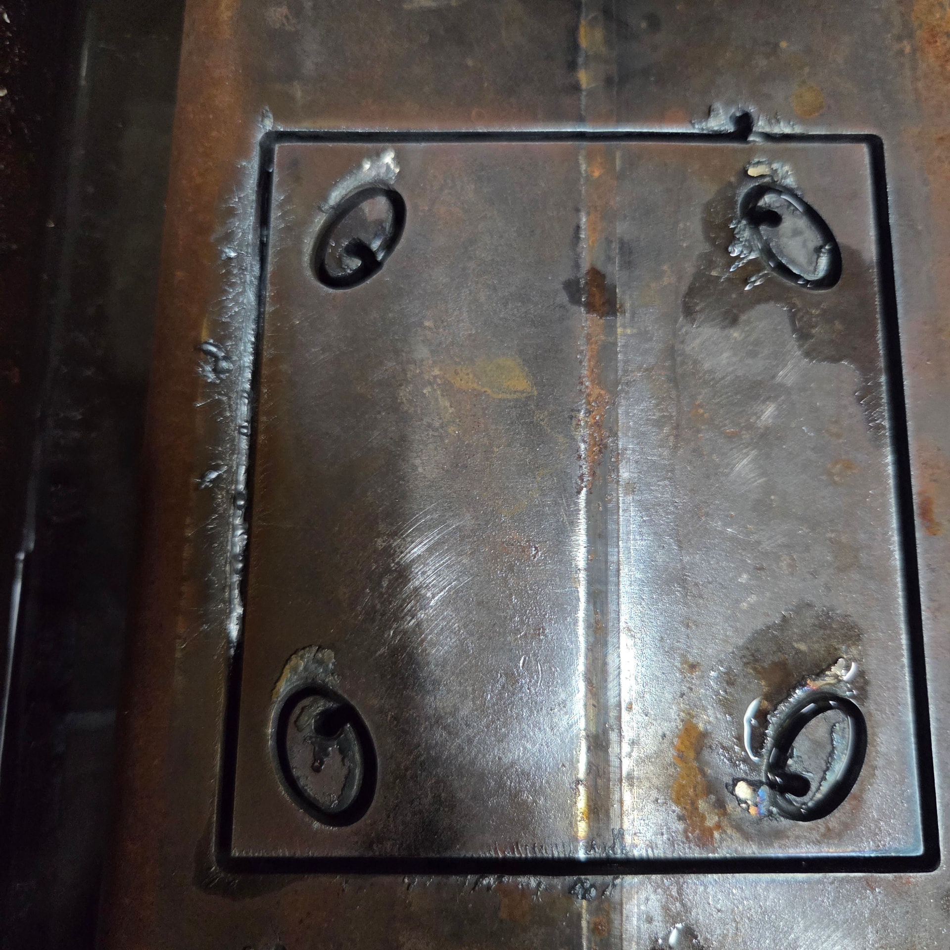

Razorweld 45 cutting 3/16 carbon steel. Every cut it does this. It will cut 3 1/2 sides and it won’t full knock out the bolt holes. My consumables are brand new, my air goes through a 2 stage air dryer. I’m using the settings from an everlast cut chart someone linked me on another issue. So I’m about 60 imp, 45 amps, 72 psi, cut height .062 (I have tried from 60-63 and it doesn’t change) pierce delay is .6 but I have done .7 and .8 with a cut height of .125 with the THC on the machine. I don’t understand why this machine has such a hard time at anything over 10 gauge for me.

Post pictures of your consumables. End shots.

It looks to be an air or positive work clamp connection issue to me. The issue seems to be at the end of the program every time, if that’s what you mentioned on other attempts.
All your settings seem to be in line with a quality cut.

Yes the holes are purposely oval, I had a more square ish hole before and it cut even worse.
Pictures of the consumables, they have less than 200 pierces on them.
The tip is no good. Try a new tip. Many events can take out a tip. Install a new electrode and tip and try again.

That nozzle is in bad shape, what pierce height are you using?
The electrode looks fine, but that nozzle doesn’t match the wear. Piercing too close to the metal can destroy a nozzle very quickly.
Yup, Big Daddy is right — the consumable looks rough.
Once you change it out, if you are still getting this same issue, please email us and we can continue troubleshooting.
I changed the consumables and it cut great for 3 of the 4 remaining pieces I had. For some reason on the 4th it seemed to be a little rougher. Aside from use, what causes these consumables to go bad so quickly? I got almost 600 pierces out of my original set of consumables, I changed them and got less than 200.

You can also destroy the nozzle if your cut height is too low. You might set the pierce height and cut height correctly but if you have not verified that you are, indeed, at that specified height then it can mess everything up.
Try Phillip’s cut height test file. This will cycle the IHS and then set the torch at 0.06 inches. It will not fire the torch so there is no concern of damage to metal nor the consumables. Now measure with a feeler gauge the distance between the metal and the torch tip. Realize that the z-axis is spring loaded so you don’t want to cause that upward movement while testing.
