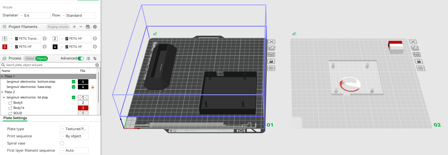

  1. As he said, if you download the 3mf file, he has it all laid out for you. Where you might run into issues is when you sync your printer filaments, they are likely in a different order. But here is how Bambu Studios imports his file.

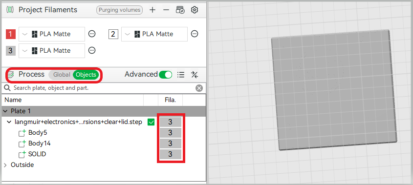

  2. Now if you import the STEP file, make sure to get the one that says it has the clear lid. It is the larger file:
  3. When you import that step file, the image is going to be face down and likely to have all colors the same. You will need to look up from the bottom of the bed to see the front surface. If they are all the same color (highlight “object” vs “global” to see individual object details):

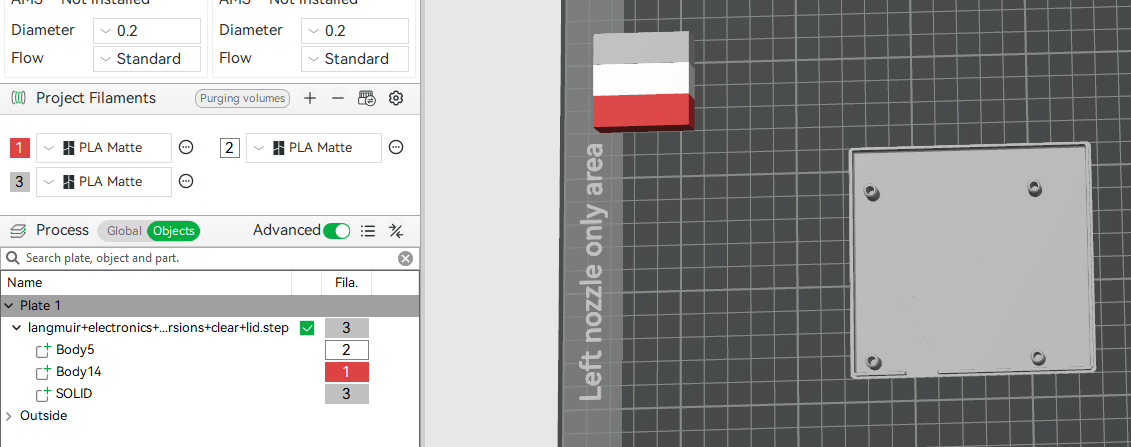

  4. So all you need to do is click on the object and type the number that represents the color you want and then the colors will change and you will be able to see the logo.

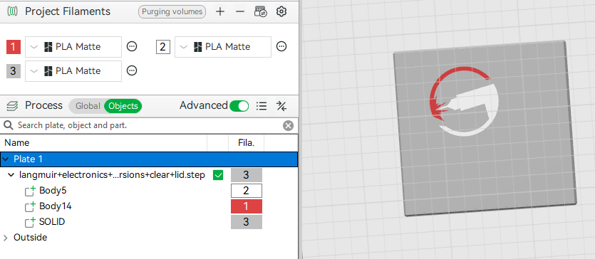

Now notice, when I turn my plate over, even though I have changed the colors, the logo is not visible:
That is where the Tin Man is beyond most mortal’s abilities: he has found a color that does not exist. Transparent!!! His model shows the logo on both sides since he has an actual “transparent” designation for the filament color.
