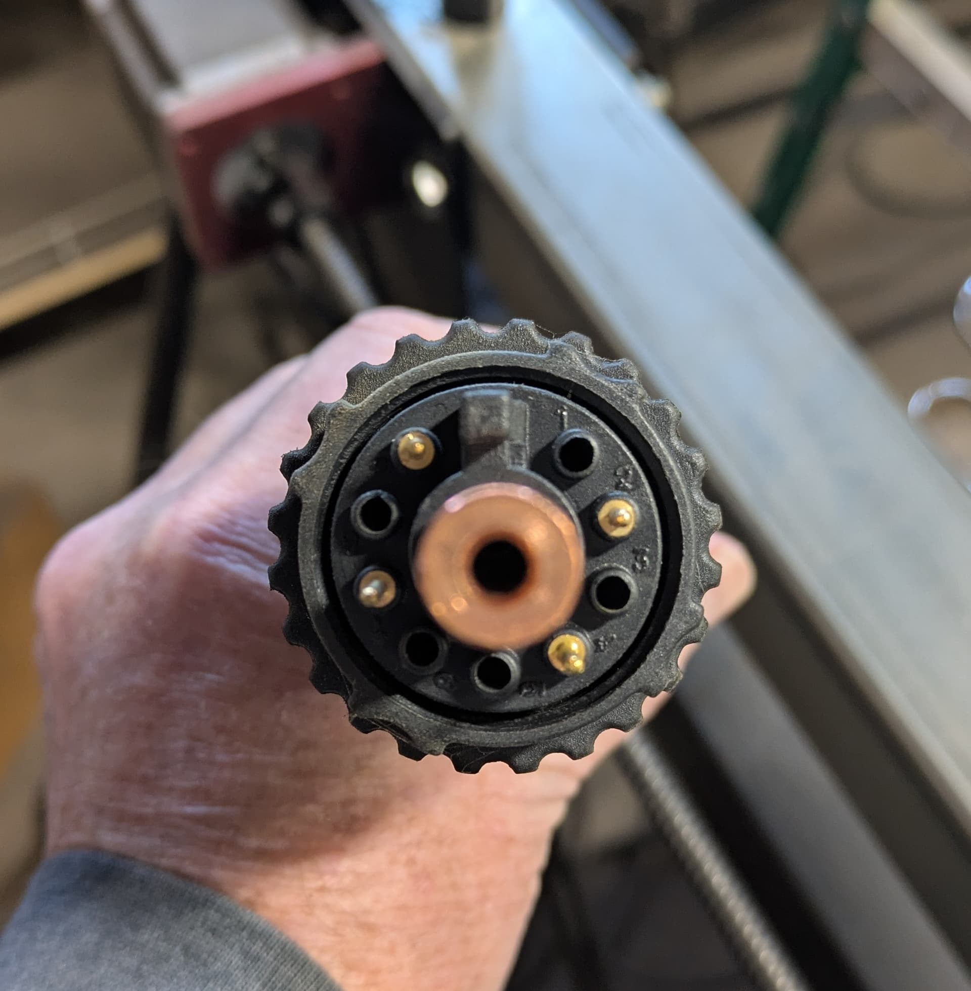

I just bought the upm105 for my everlasting 62i. Did you need to repin it to fit? I bought it from Primeweld and they do not repin although they said it was very easy to do.
I had to pin my torch connector, because Plasmadyn didn’t pin it at all. They sent out the torch with no pins installed. I messaged them about it and they were quick to get back to me with instructions and sent out a set of pins.
I’m not sure if the Primeweld machines use different pin locations than Everlast, but I’d plug it in and see if it works first.
Thank you for the quick response. I will give it a go.
I’ll see if I can find the instructions for wiring the pins when I get home this evening.
That would be great!! Any help would be appreciated. I did talk to the rep from Primeweld and he said it is really simple to switch pins. Another user on here made sure to mention that Primeweld doe not sell the Italian made Tecmo UPM 105 torches, butt it clearly states on the website that it is Italian made. Also from my understanding is if the leads are soldered, then it is the China version, and if they are clamped and screwed, then it is the true Tecmo UPM105….Who knows
My upm105 torch should be here this week and wanted to follow up to see if you could maybe send a pic of your torch pins going to your Everlast. Are you happy with the Upm105 vs the PTM60 that come with the machine? Thanks again for all your help!!

This is a picture of my connector that I pinned with the instructions from Plasmadyn. It has short pins in 2 & 9 and long pins in 4 & 7. My old Tecmo torch connector also has a short pin in #1, but it’s obviously not necessary for operation.
Thank you so much for taking the time to send me this. Hopefully the torch will be here today and hopefully I can get it pinned correctly. Again, thanks for all your help!
