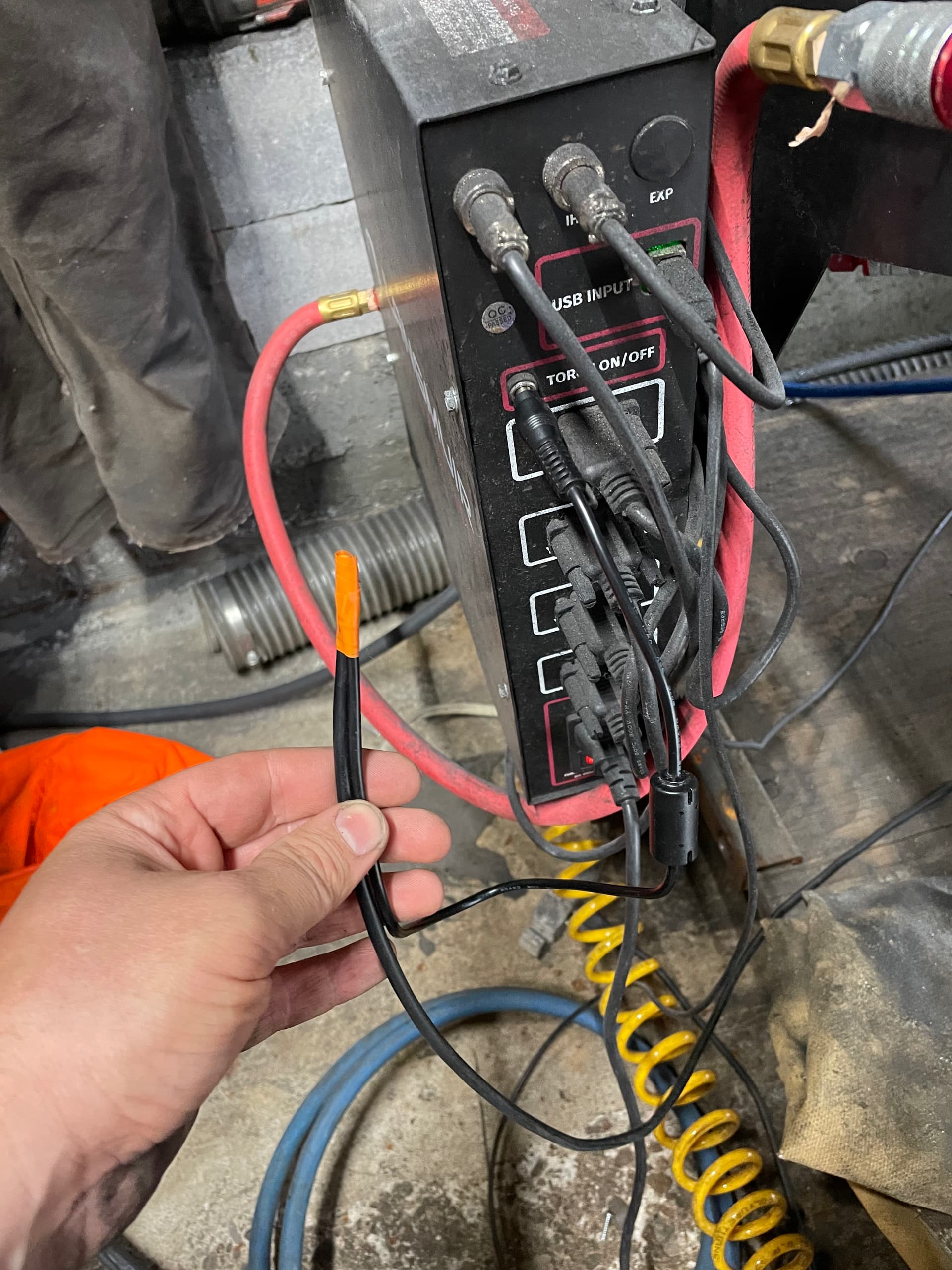

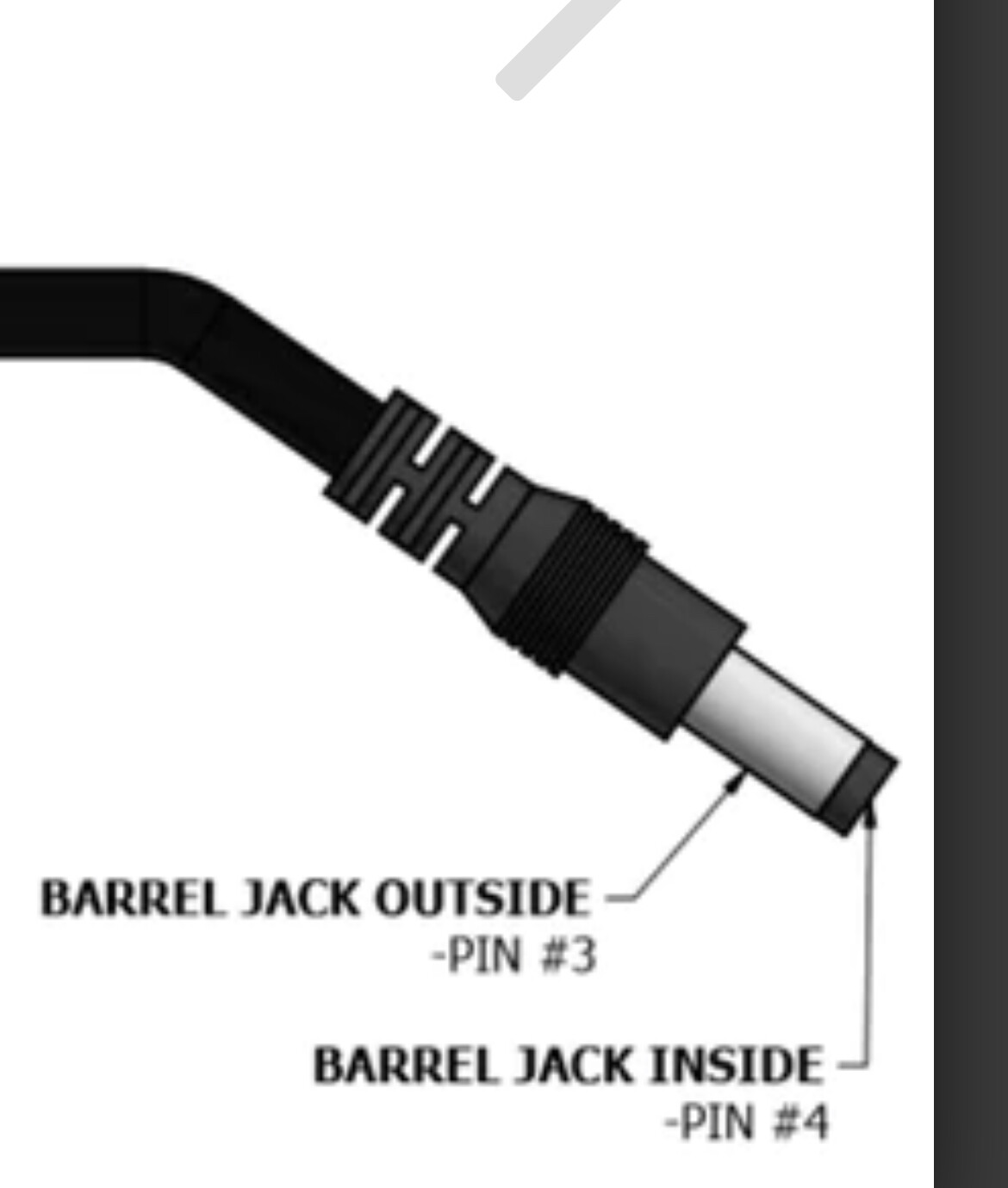

My barrel jack snapped off for my torch height control . Is there any way that I can use the machine without the thc ? I tried turning the thc off but no dice . Thanks

It helps if you can give as much info as possible. What is a barrel jack?
Are you sure it was the THC wire? It should run just fine with the THC toggled off in Firecontrol.
On the other hand, if it was the Torch on/off wire, the torch won’t fire.
Yeah. That’s the torch on/off cable. The THC cable is above it.
