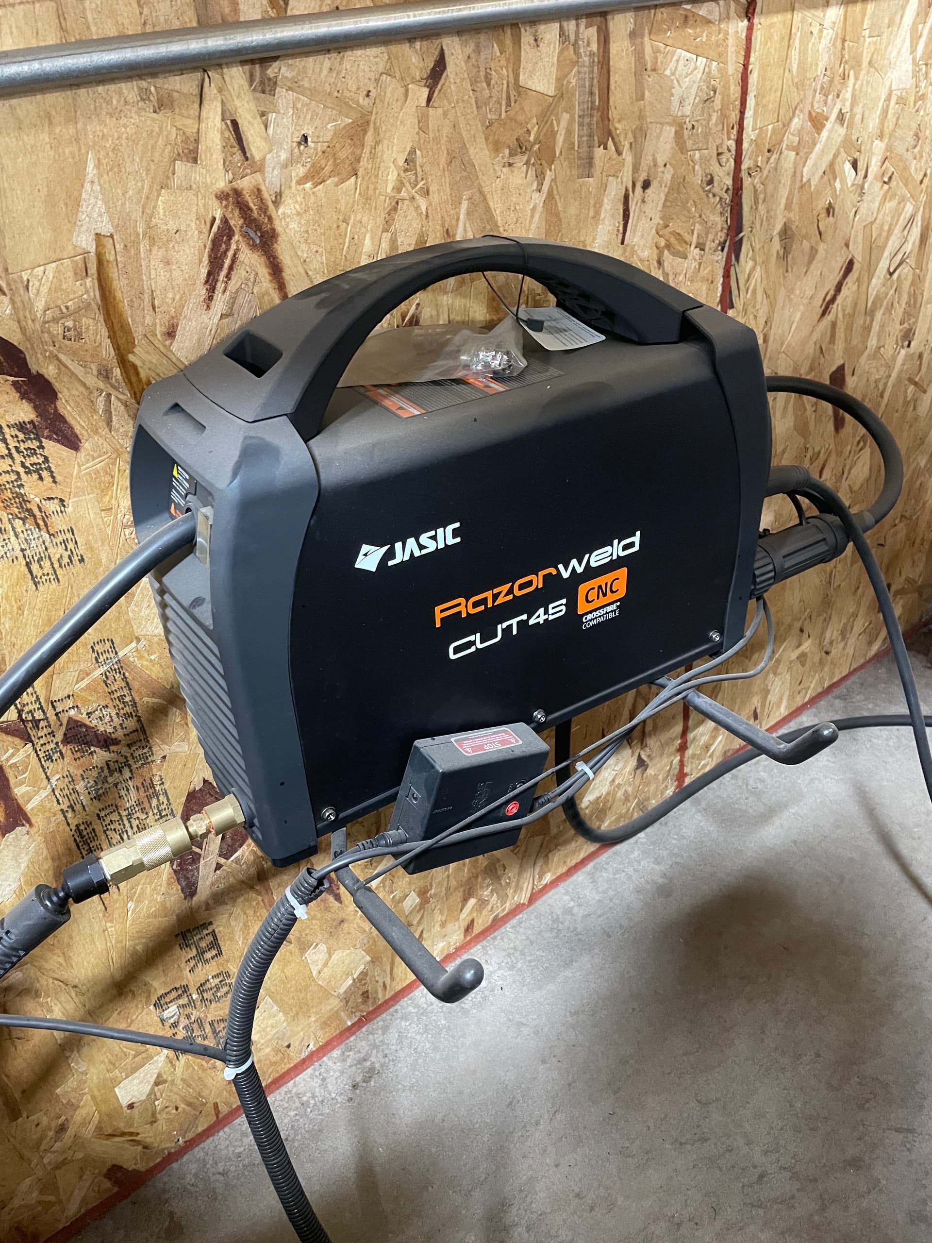

Everything was working fine when I finished up last night using all the same settings. Put the next piece on this morning and now getting the error “TORCH MOVING BEFORE CUTTING VOLTAGE SENSED”
RW 45 on PRO table cutting 11ga. steel 45 Amps, 30 IPM, .8 delay, which was working great yesterday on the same sheet of steel. This is a new project but all the settings are the same.
The torch moves to the start, pierces fine barely starts the sweep in and torch goes out giving me the error. Tried increasing and decreasing both the Feed Rate and the Pierce Delay with every possible combination (increasing both, decreasing both, increase one while decreasing the other back and forth) also disconnected and reconnected all wiring connections thinking something got bumped while shutting down last night.
Ran out of things to try and hoping for a suggestion of something else to try…

Try running the program with the THC turned off in Firecontrol. You shouldn’t get that lost voltage error with the THC off and you can see if the program runs without it
So I turned off the Torch Control and it made the cut first try with no issues!
Thinking back I believe I DID do an update to 21.1.4 just before making the cut that was giving me fits. Do you think this was/is my problem? If so do I keep the torch control off until a fix comes out or should I try with it on and if it freezes THEN turn it off??
There is a newer version available. Search this forum for 21.1.5 to find the link to it.

Looks like the problem was 21.1.4
I did make a straight cut first to ensure that was working before running the program and then made the same program/cut that was giving me troubles with nothing changed but the update to 21.1.5 and all is good again!

Downloaded “Equipment Step” off Fireshare and first cut attempt the torch Jogged to Start, Made the Pierce and froze at the pierce point with the torch still lit. Had to turn RW45 off to stop it.
Second attempt I turned to THS off and it made the cut no problem.
Thoughts as to what I have going on?
I have had the same exact problems. I’m running RW45 on the new XR table with sheetcam.
Works great sometimes and other times it just screws up and I can’t figure out why. I’ve tried so many things I loose track. Updated software seems to help sometimes and other times it messes up…
Finally read somewhere that someone had to warranty they’re razor weld. So I am currently waiting to get my unit back after having them replace the circuit board.
Also make sure your wires/leads from the razor weld aren’t crossing each other causing interference.
