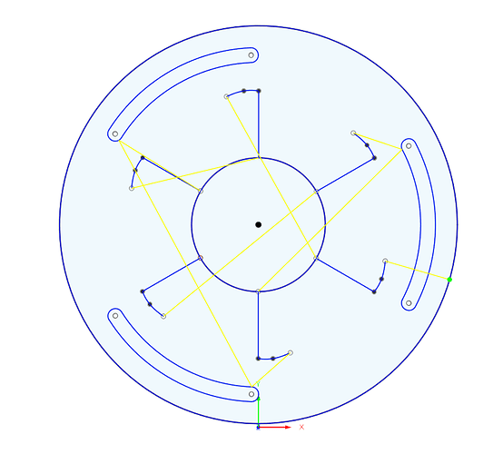

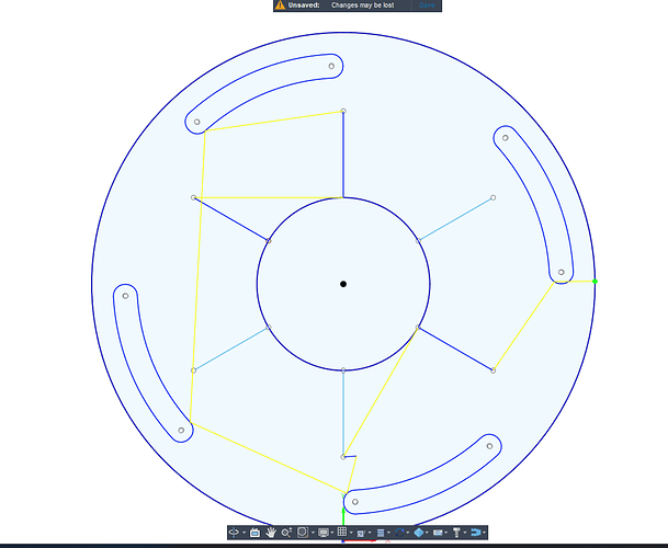

I must have a setting off somewhere but I can’t find it. Every time I select the cut lines in fusion 360 and then go to put it into G code it doesn’t come up with all the lines selected and leaves random ones out or it will change the direction of some of the lines to 45 degree angles or something weird like that. I’ve tried changing left, center, right cut, tried smoothing and feed optimization checked, tool speeds but don’t know what I’m getting wrong to get it to cut what i need it too. Thanks for any help.
Post your dxf and I’ll show you exactly how to do it with your own file. Or post your f3d file from Fusion.
If you don’t know how to export and post your f3d file from Fusion follow this link.
In the meantime you could take a look at this generic video I made about single line geometry in fusion. It’s a little dated and I have a slightly different way of doing it now but the information still mostly relevant.
Thank you, thank you, thank you. Watched your video and it worked perfectly.
