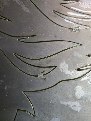

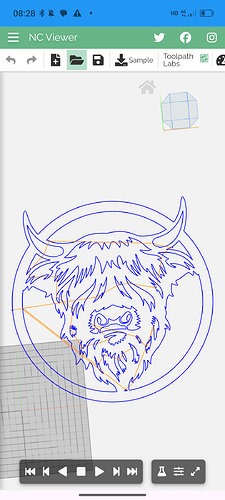

What could be the cause of this. In fusion it’s all connected, but I’m seeing this on some cuts. On the backside it doesn’t look like it even cut for 3 or 4 mm

And when you say only some cuts is it some of these longer cuts?
Maybe some kind of a air delivery issue on the longer cuts?

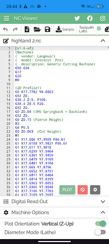

highland 2.nc (614.3 KB) It shouldn’t be air delivery….I just got a new air compressor Ingersoll Rand 60gal 5hp. Yes, they are some of the longer cuts. Other than skipping…these are some of the cleanest cuts I’ve done with the machine. I just also installed a machine torch.
The file looks good

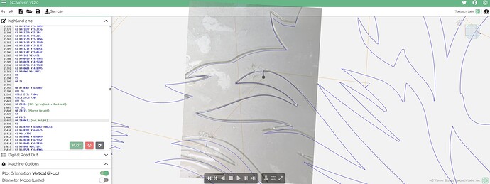

At least that cut in the lower, center of the image looks like the non-cut occurred at the end of a Closed Loop. Is that correct? If so, do you have some lengthy Lead-Out set?
It maybe the Lead-In…I had Lead-out unchecked…but noticed that I left the Lead-in set to default 0.19685 in…usually I set that to 0 in like their tutorial video.
No lead-out torch is raising then shutting off before the end of cut.

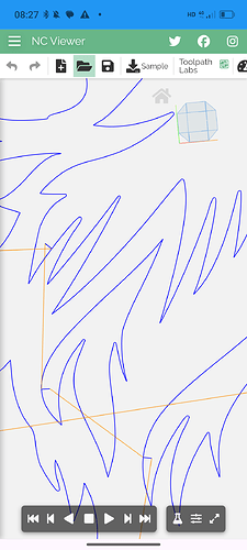

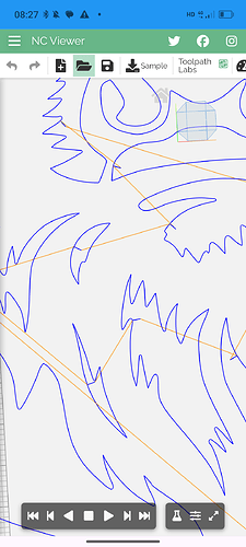

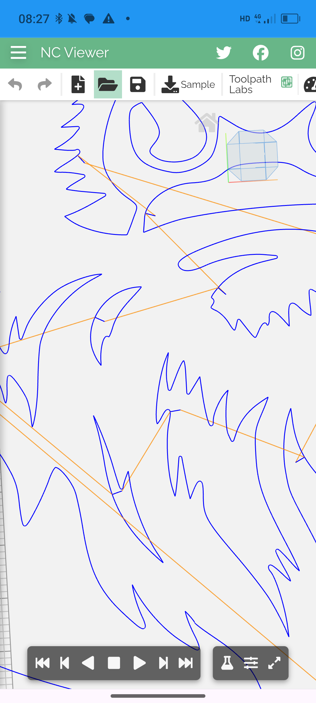

@mnicolia is the NC file the one you used in the picture? The NC file has a lead it where the picture is piercing at the line with no lead in .
Yeah, that’s the same file….maybe I’m thinking wrong. I just recently had a heart attack and haven’t used my machine in awhile….it’s like relearning all over again.
Ok, I have a feeling it’s in the plasma machine…I made a different file, made sure to do a lead in and out….and it is still skipping spots…it’s when the torch starts a cut, and it’s intermittent.
My money is on pierce delay setting. What is it set at?
