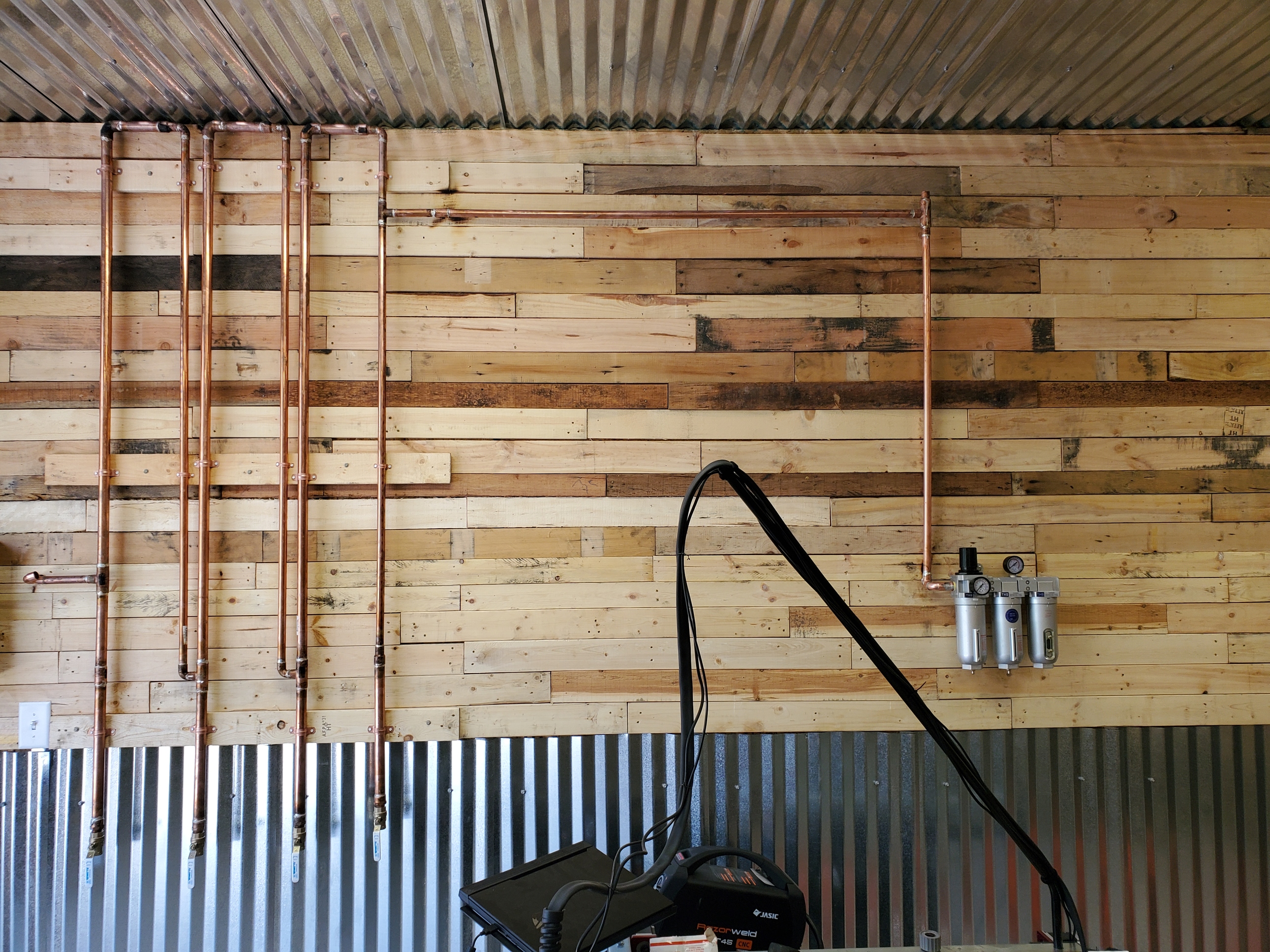

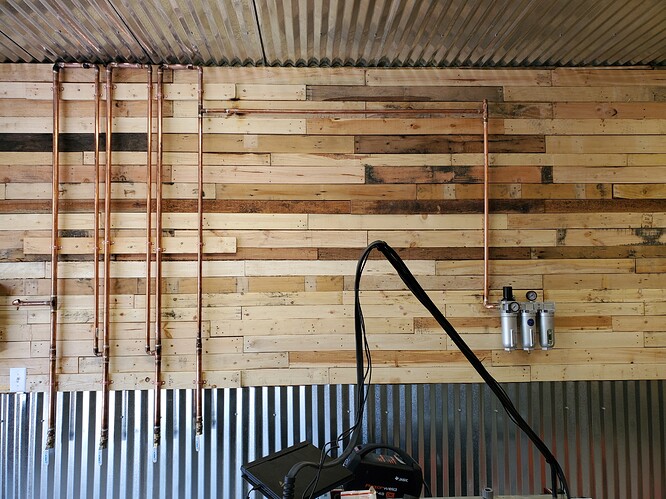

over 80’ of 1" copper pipe keeps my air dry enough for sandblasting. Had a smaller 30 gallon oil less compressor running straight for 30 minutes and not a drop of water made it to my blast pot because of this setup. It’s insanely overkill for my garage but I plan on taking it with me to a bigger place. Have to run a bigger 220 line to the garage to get my 5hp 80 gallon champion compressor running.

I love that look for shop walls…

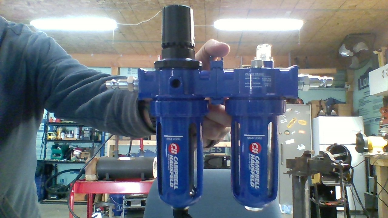

I am also setting up my air sysytem. I have a climate controlled garage (heat and AC) so the humidity is low. The one thing i dont understand is why i need an lubricator, and if i do, do i seriously need to put oil in it? And what kind?
No oil. Will jack everything plasma up
Thats what i thought. SO do I not use the lubricator part or does it remove oil from the air?
You can take it off. No function but just like mine I would guess you will need to thread the back of the regulator. I didn’t want to fool with getting shavings out so I left it. It will catch a small amount of water.
Thank you. Ill just let it attached.
