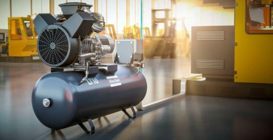

Pressure and flow are not the same.
A very good read
