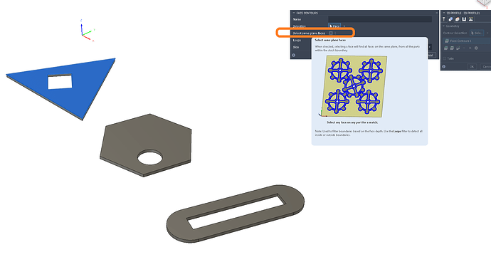

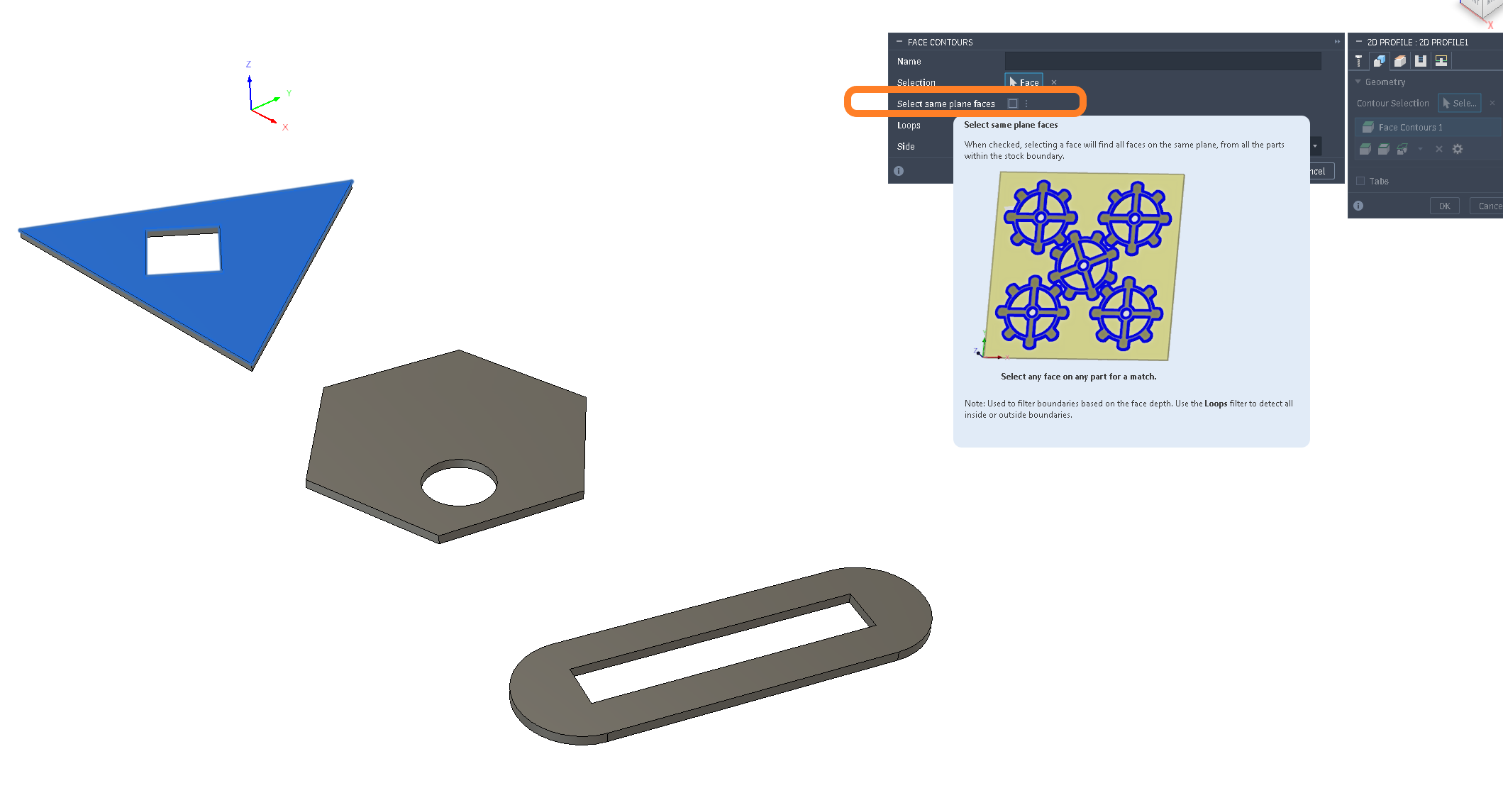

If you’re talking about actually selecting individual items of geometry on the same plane, you double click your first face contour there is a checkbox for accomplishing this in the 2D profile menu.
