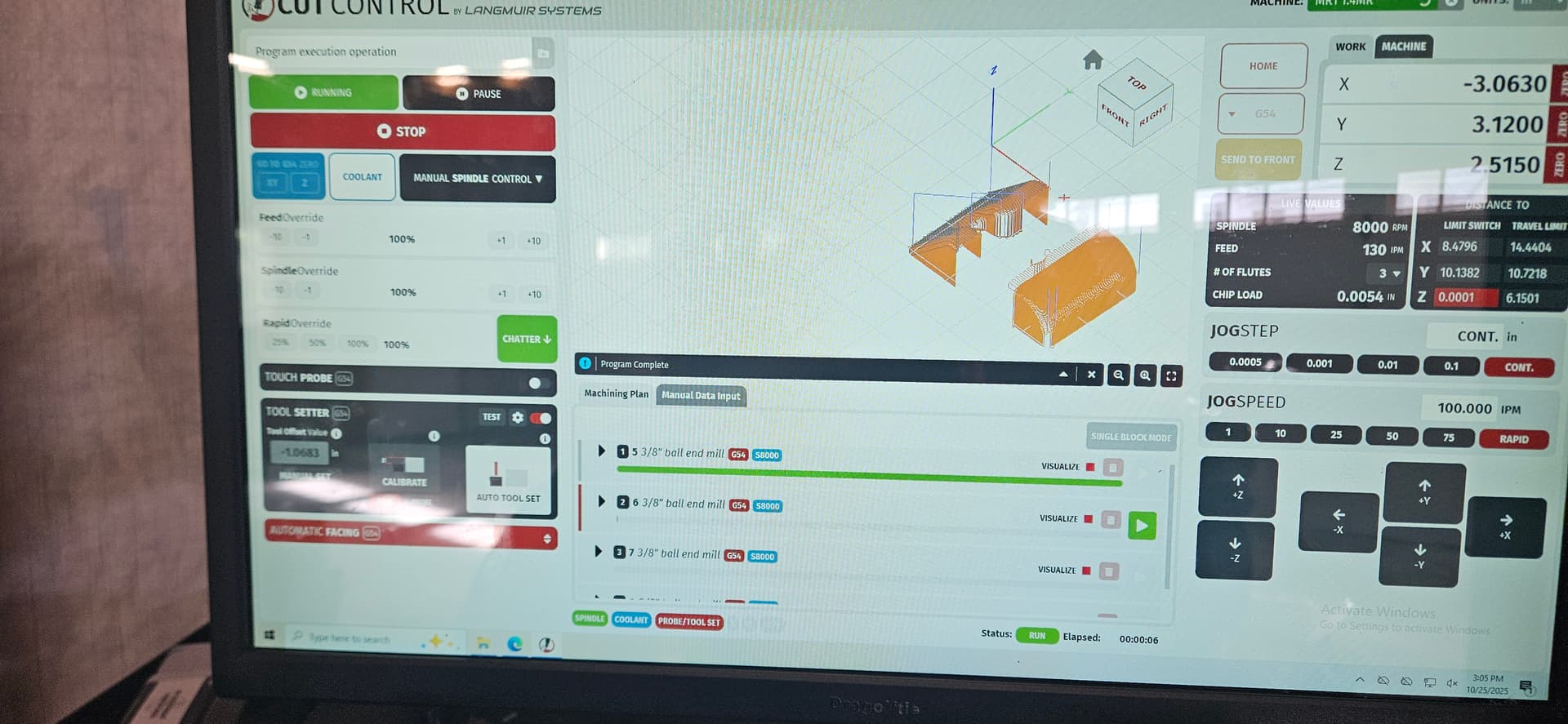

I am on latest beta of cutcontrol 25. Is there a way for it to run all loaded programs automatically? After each it returns to home and stops, requiring manual advancement to next loaded toolpath.
Not the end of the world but a but annoying. Can it not just run the rest that are loaded automatically?
Each program is supposed to correspond to it’s own tool or setup. Because of this, it wouldn’t really make sense to run all programs without stopping.

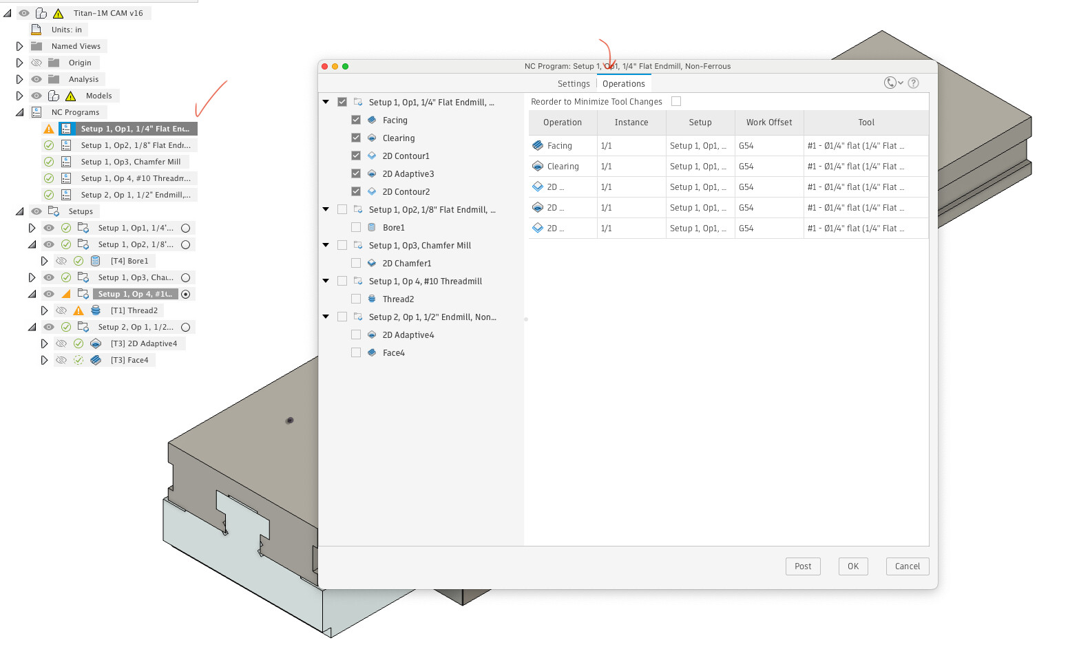

Not sure what CAM you are using, but in Fusion, you can select multiple operations into one program.
So in my image, all 3 of those should just be one? Since its the same tool? I use fusion. How do you do that?
When you post process, just select all 3 at the same time, then post them. It’ll output one file.
here’s a screenshot, hopefully should be helpful
Don’t make a separate setup for each operation unless you need a tool change. One setup can have as many operations as you require. For example one setup could cover facing, bore, 2d adaptive and contour. As long as the part position stays the same in the vice and no tool changes are required.
