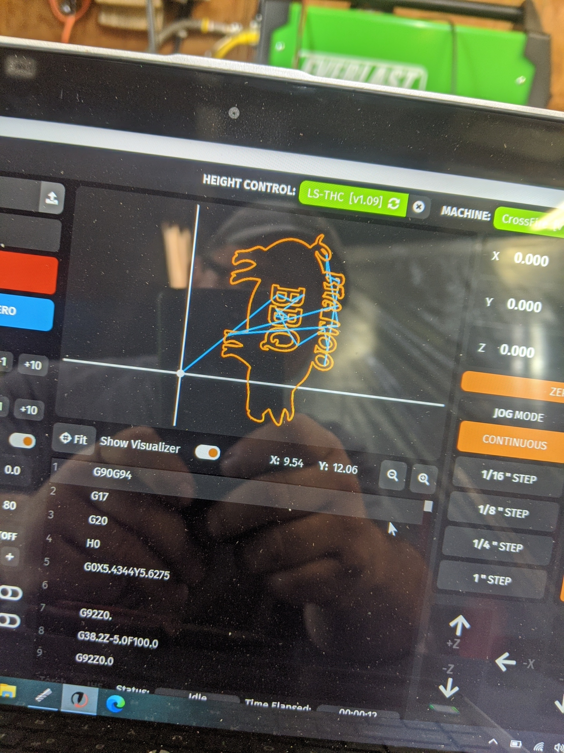

Yes I rotated a file in firecontrol 90 degrees to fit my plate. It rotated it fine but when I set my cutting start point and zero all axes it does not match on the cut screen. So I tried it and it cut away from where I wanted it on the screen. Am I doing something wrong?
It is a known issue with Firecontrol. LS is working on fixing the problem.

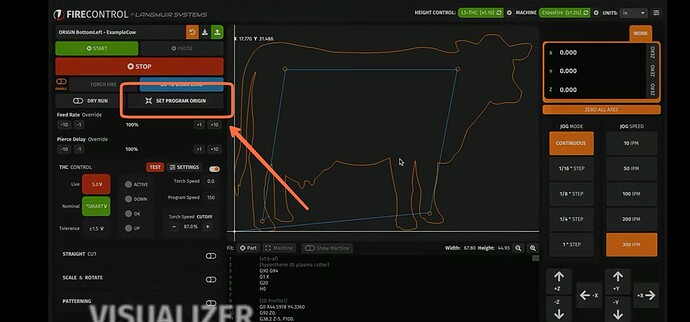

The " set program origin" button will help you relocate the origin.
As Tin says, use the “set program origin” button and select one of the green boxes on the screen as your new origin point.
