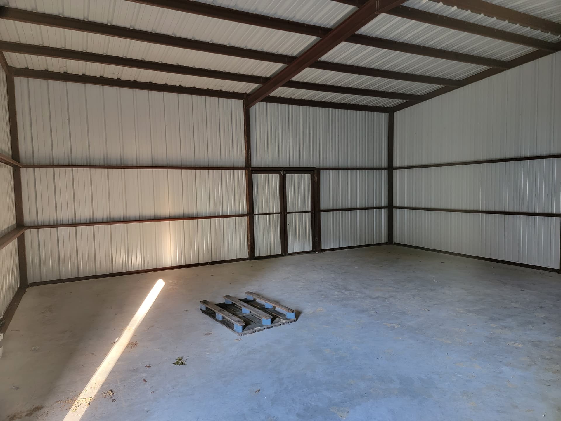

@Phillipw still working out some of the details on usage such as time and also using flowmeter. Then i might just say scrap that and turn it on and let it run lol. I like tinkering with stuff and just making better mousetraps like that. Im building a new shop so lot of stuff is going in will be new so trying to make it the best on the first install. And one focal point is dry air beyond any doubt. That is why i kove this group. Lots of knowledge here and helps to get different perspectives and ideas as well as what people have tried with success and failure. My goal is to have success on everything first go round.

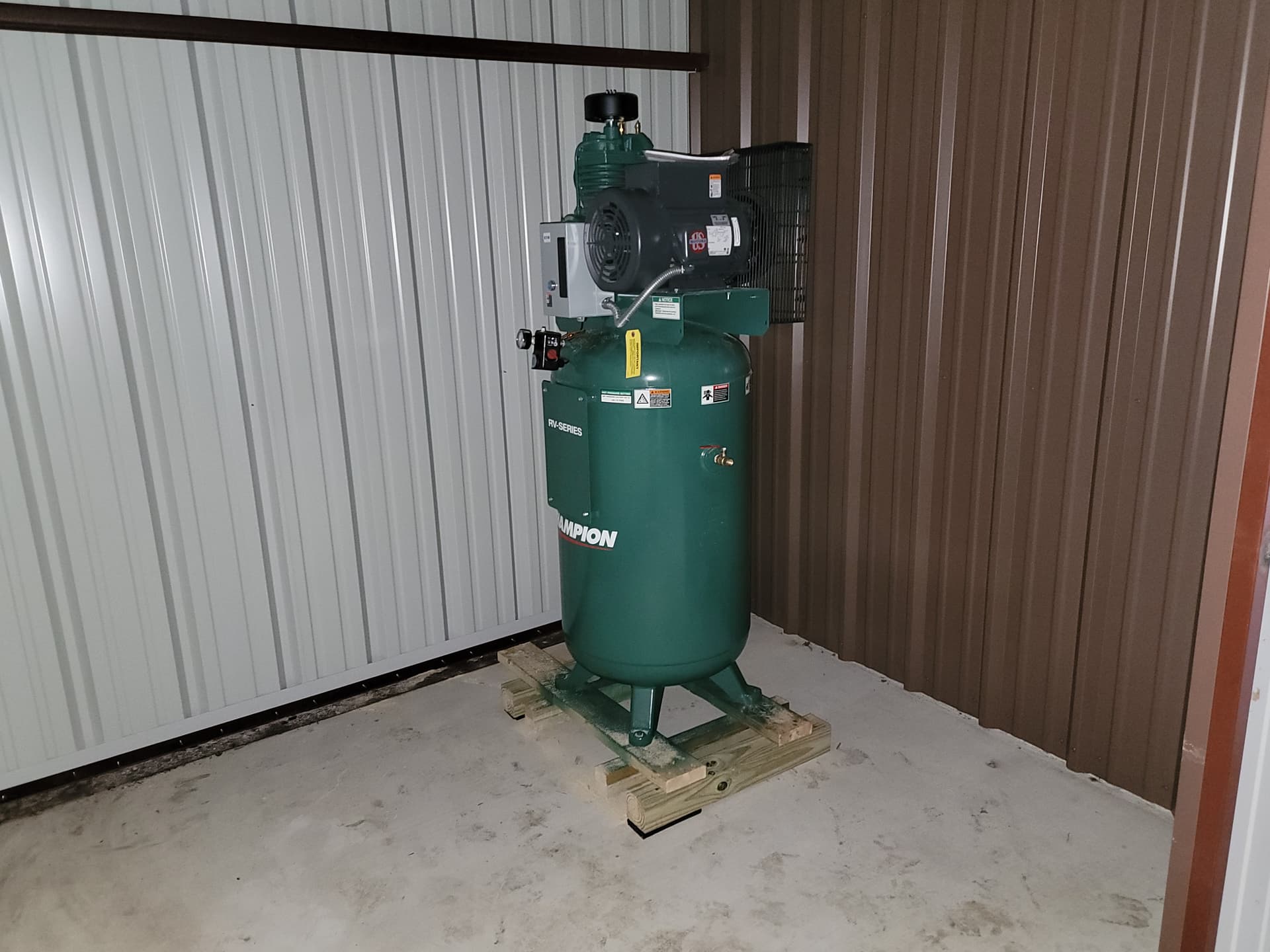

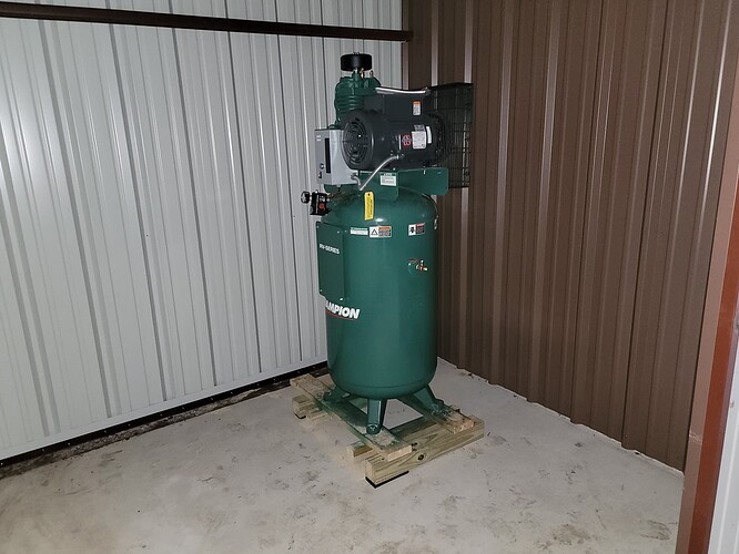

Just the finned round tube that is behind the fan/pulley that came on the compressor. My compressor is a 7.5HP Polar air should be on that same website.

@Knick i will post as I get more going as waiting on the electrician to come wire the building so it has been slow go with everything. Only thing in the building is a new compressor and phase converter.
